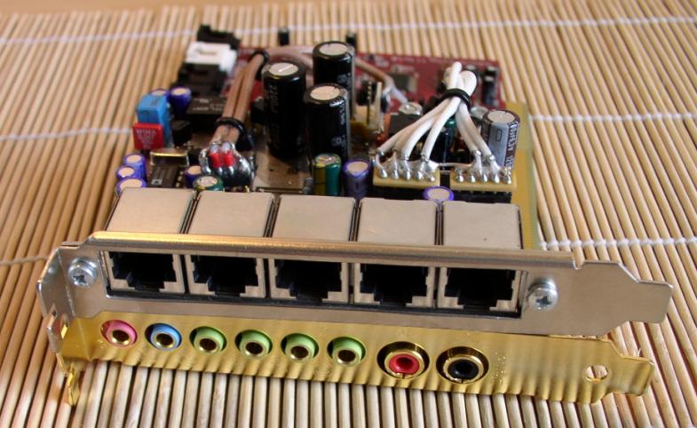

BTW, what do you use for ASIO routing? Is that an application that came with the prodigy card or it's a 3'th party app? I used to use winamp paired with a directx plugin adapter for being able to use some plugins, but that's far from what I want. That ASIO router of yours looks really cool 🙂
I think you may have me and Vil mixed up. Perhaps I've been replying to posts intended for Vil.
But to answer your questions, the ASIO/VST/DX plugin host me and Vil use is called Console:
http://www.console.jp/eng/en_about.html
I don't actually use a Audiotrak Prodigy soundcard but Vil does, instead I have an RME HDSP 9632 with the add-on boards for more channels.

Yes the RME drivers are multiclient. I also use internal routing to move the signals around, the Prodigy which is a cheaper card also has multiclient and internal routing if anyone is interested in trying this out on a budget.
the most important thing is to have posibility to route digitaly sound from wave driver to ASIO and then back to card's out . just few cards can do this . RME latest ones , creamware , egosys (audiotrack), maybe a couple more . m-audio don't have that option , at least for a moment .
Vil said:the most important thing is to have posibility to route digitaly sound from wave driver to ASIO and then back to card's out .
I'm pretty sure the Emu's can do it, but their wave out driver is WDM only - not sure if other cards will do this for say KS (or directsound).

Right, well you really want a card that affords internal routing of signals whilst still in the digital domain. Why? Well you can route these physically through a line out than back in through the line-in if you use the PC as source and XO but this costs you in both outputs used/wasted and more importantly one digtal-analogue conversion and another analogue-digital conversion when the signal comes back into the card.
So really you need a card that offers internal routing such as an Audiotrak Prodigy, RME Hammerfall series or Creamware.

Difficult to say, looking at the website they hint that the card may have internal routing: "software driven patchbay/router"
You really need to ask a dealer some questions to be fully sure otherwise it might not do what you need.
I can say that Audiotrak cards and RME HDSP cards all have internal routing for sure. Others have suggested Creamware does to. You'll also need a card that is multiclient - again the RME and Audiotrak cards do this.
