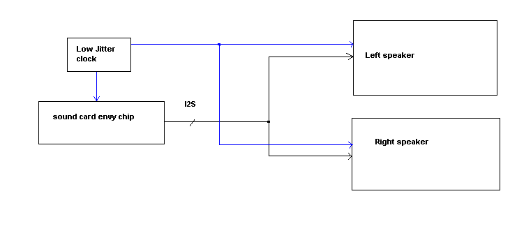

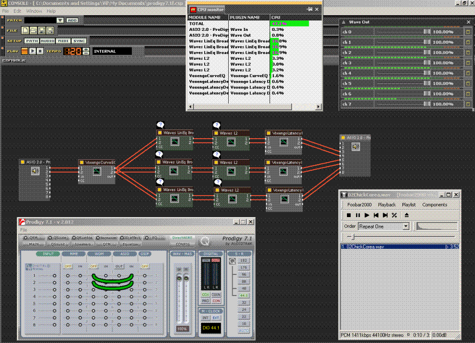

very interesting ! tipically I am too lazy for any comments but last posts are very interesting so I will add my 2c .
I am using computer for 3way xover . after a lot experiments with different pro audio cards (creamware scope, rme , echo etc) i found jitter level way too big if using adat or s/pdif (master and slave configurations) so i did it in another way . I found right cheap sound card , Audiotrack Prodigy 7.1 and took 24bit I2S digital data directly from envy chip . also i did some test and found those 24bits are true , without any recalculations . latter i used LVDS transmiters to send digital and clock data to converter units , they are located insight left and right speakers with 3 way amplifiers . additional low jitter clock generator is located near sound card and clocks dac units+ sound card and reclocks I2S data (just in case) .I am using Audio Console software with ASIO2 and waves , voxengo etc. stuff for procesing.

Also shinobiwan- art teknika console (the program that vil is using here) is very easy to configure. It would be much simpliler than cubase without any negative side effects- you can see his XO is bassically identical to mine- 3 way lineq XO and voxengo sample delay for tuning. Then vil is using L2 ( a peak limiter) to protect from output clipping- One benifit of FIR filters I find is less peaky output so i avoid the limiters myself.
VIL- try the voxengo curveeq for room tuning- especially if you have a measurement mic- It is very good for this!! I do stereo and wave the mic around the listening position. Thanks -

wordclock is OK but not the best option !!! system needs 256F or even more and wordclock is just 1F so PLL is used to get 256F . just superclock is the right ONE . I did in another way (look to the attachment)
by the way LVDS is very cool , i think thats is best low cost solution for clock and data transmission . I am using separate cat6 cable(one pair of 4) for clock transmision and another for I2S data .
