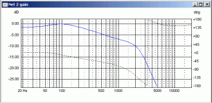

Ah I see what you are saying about those filters. LspCAD lets you use up to 8th order i think 48dB/octave is plenty. This would let me see what a 1.5k xover sounds like with the seas (like you mentioned) W15CY and the scan97. I know the scan can handle 2.2khz with a 3rd order acoustic but I dont know about 1,5khz. A steep slope would suit the W15 even more by reducing the additional harmonics induced by the resonance at 8.2k.
I would still design using LspCAD mind you to make sure I get the phase response as perfect as I can. You method sounds ok but with one flaw. -Does the curve EQ thingy in vox tailor for phase like the Tact audio stuff does?-. If it does then its not a flaw. You can have a flat response when the drivers are in phase and a really **** notch when polarity is reversed, meaning the drivers are not in correct phase. Ofcourse adding in delay circuits on your tweeter will solve this, but it will take measuring to get correct.
