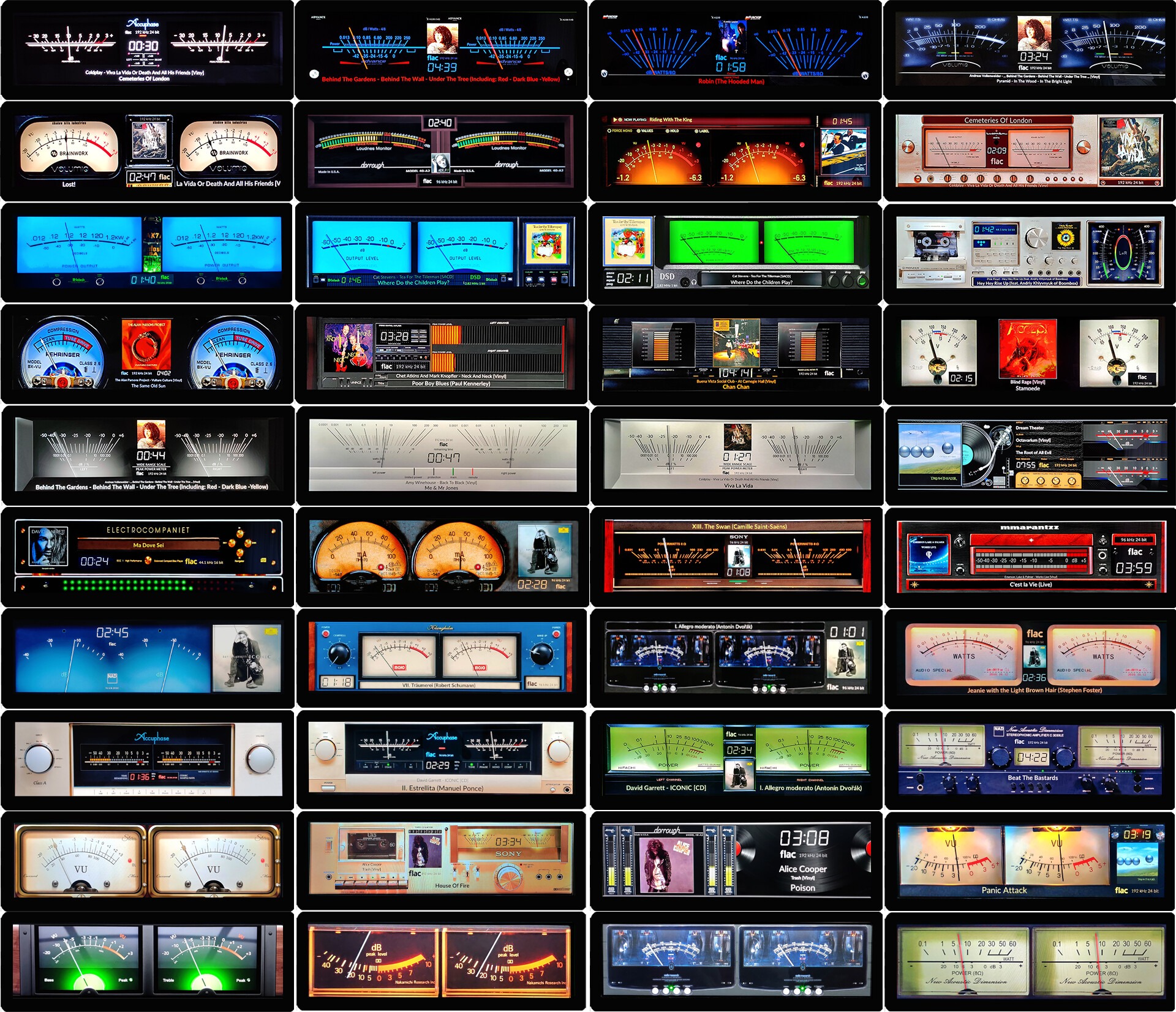

New version (Signac Edition) of the PeppyMeter was released today:
https://github.com/project-owner/PeppyMeter
New features include:
Here are the new default meters which demo the new functionality:
- Refactored the algorithms for circular and linear meters
- The changes allow to create vertical linear and circular meters
- The circular meter range can be more than 180 degrees now
- Fixed rendering issues for several default meters

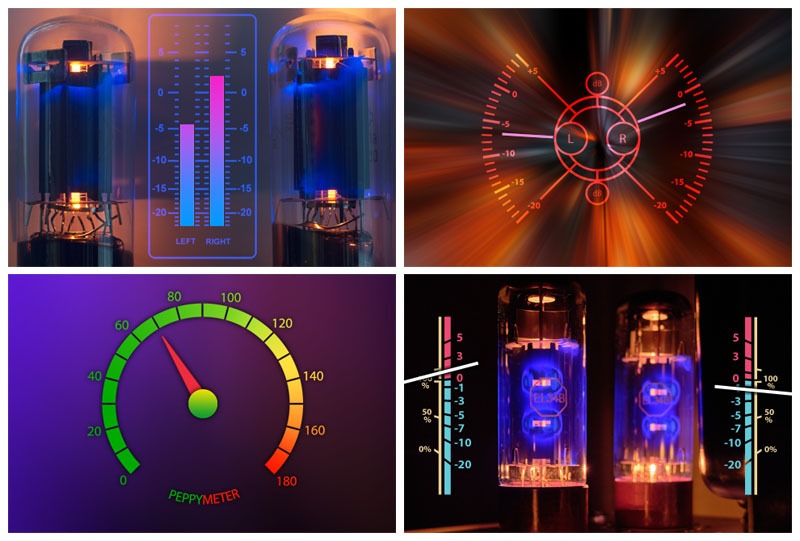

This is totally awesome. Thanks a lot. You are always a step in front. After creating my first PeppyMeter for my current project I wish one could make use of vertical linear one to simulate Magic Eye tubes.New version (Signac Edition) of the PeppyMeter was released today:
Can I just clone the github code and integrate it into Peppy Player? In a first attempt it was not successful.
And just in this context, I have a feature request: Is it possible to integrate different indicators for left and right channel? This way one can simulate tubes like the EM83 tube.
Here is an impression of the horizontal implementation:
And an idea, how the EM83 stereo tube could look like:
Kind regards
Tobias

Thanks a lot for the fast reply. The version out of the zip works great:
You can see it in action in the video attached within the zip file.
I took photos of the tubes nearly at zero brightness. For the "bar" I cut the indicators at full brightness using a transparent background. For me the result is pretty nice, for the vertical as for the horizontal mode.
Best regards
Tobias
Best regards
Tobias

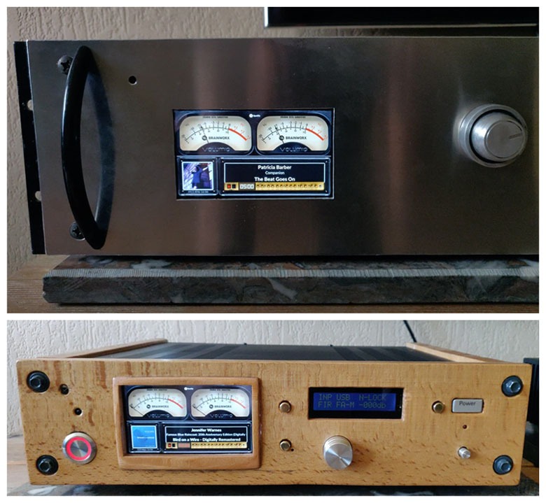

Yes, it looks pretty good. I'm looking forward for you real tubes project which is partly visible in the video 😉
Here are some example projects using Volumio with PeppyMeter plugin:
And some videos showing the PeppyMeter in action:

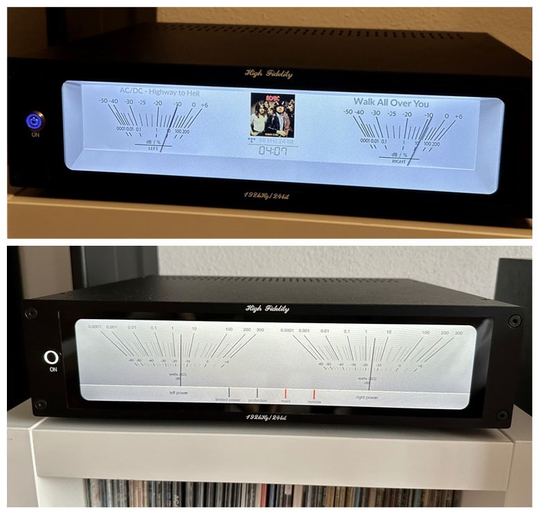

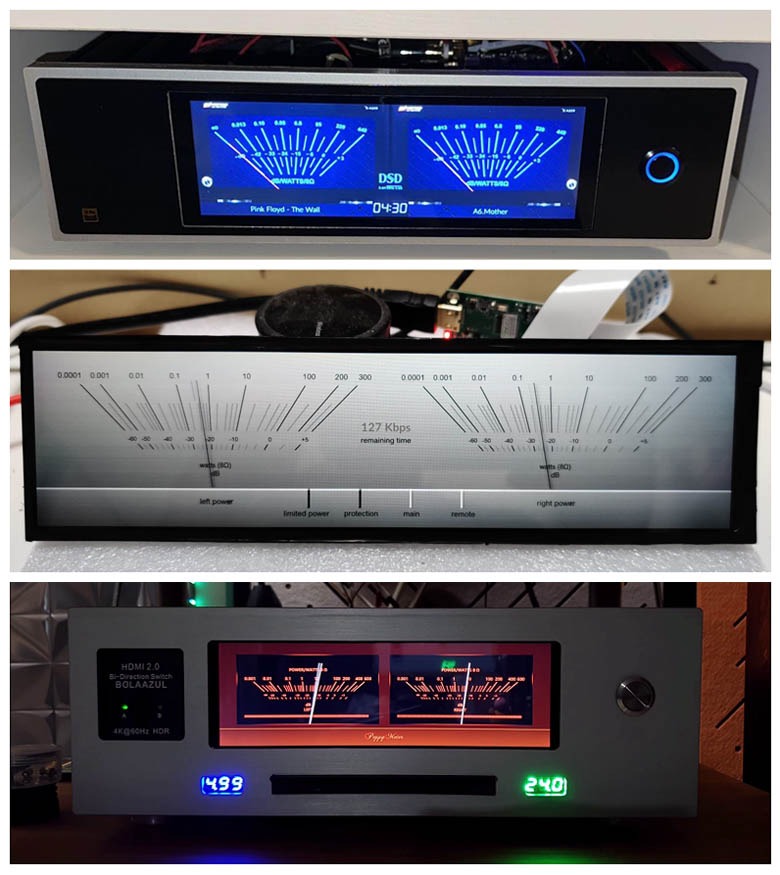

Absolutely amazing. I really love this stuff.
Here is the video of Spectra, my latest project:
and the one of my first PeppyPlayer, the NixiePeppy:
Wow! All parts of the new project look great - woodworking, custom electronics and software customization. Well designed and executed!
What's next ? 😉
What's next ? 😉

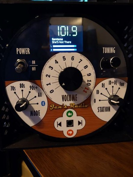

rpi - thank you for responding so quick all the same! I have a question for you (or anyone) about incorporating peppyalsa and possibly peppymeter into a very, very small screen area. I have a 320x240 screen on my little diy radio - but I only want the meters to be on the bottom say 1/3 of the screen. I am expecting that if I run peppymeter itself it will want to write directly to the screen, and use all of the screen.
Work in progress - but you can see here:
So my current approach is simply get the values of the left/right channels and create custom bars in the code that I already have updating the screen with the station number/song title/artist/battery/etc. To that end I am currently trying to import peppymeters' DataSource... and get some minimal amount of code going to be able to fetch the left and right channel values. In my small brain it starts something like this:
and then I can later fetch the values directly from data_source... (guessing)
Two questions:
1. Is there any existing howto or can you give me some pointers on a super minimal/simple python code base to fetch the current R/L channel values (I am expecting % I suppose) from the named pipe that the peppyalsa plugin is now properly writing to?
2. I am very open to a better way to do this over just my own custom code. For instance, if you told me a way to get peppymeter or even the spectrum analyzer (both look amazing, btw) going in such a way that I can output it to the smaller part of my screen then I am way open!
If so - the details are that I am currently writing out SPI using the ILI9341 with code that uses (this is very chopped up, but you likely get the idea):
and then in a loop I do draw rectangles and text before rendering...
Any advice - greatly appreciated! -pm
