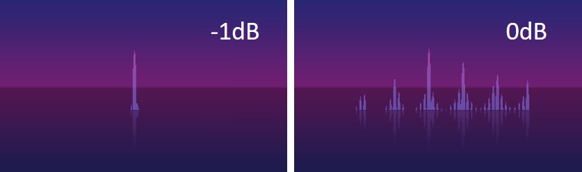

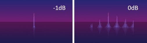

Hi Francesco,
thanks for sharing your opinion.
1.
The FFT always ends at the half of your sample rate. If the sample rate is 44100Hz, the upper most frequency is 22050Hz. For confirmation you can check it on e.g. on a PeppyPlayer, see attachment. What is your sample rate?
2. You can disable the windowing be setting it to any other number than 1, 2 or 3, as the windowing is only applied if it is set to one of these numbers:
Maybe your input signal is not a pure sine wave. Clipping can cause additional frequency responses. Have you tried a not so "loud" version of your test sample?
Kind regards
Tobias

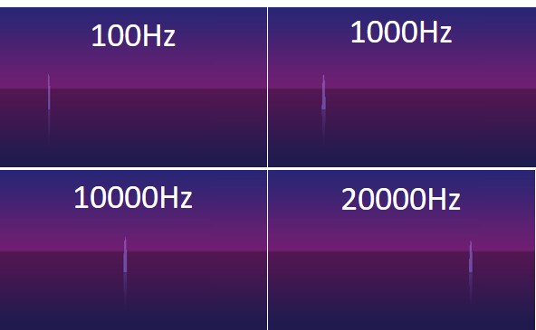

Hello to all,
I would like to avoid boring or even annoying with my comments.
1. regarding the first point, I tried, as you advised, to use a "sample rate" at 44100 and 48000 and, as I was sure, the last frequency displayed is around 20kHz. But my point of view is: if I use high "sample rate" values, what I expect is to see the frequencies that are normally audible, among other things, as a display, I believe that even using 44100 the arrangement of the frequencies is very limited for the mid-bass while it is very wide for the highs. If you remember, in post # 500 I hypothesized an arrangement that, in my opinion, could be fine as fixed, even when using high sample rates (192k, 384k, 762k). I tried with the fixed declaration but, not being able to use decimals, the low frequencies are collapsed into very few positions.
2. I tried again with the sinusoidal signals (which I am attaching) with 100%, 75%, 50% and 25% amplitude and the result, especially for low frequencies, is that with any "window" value it is never reached 1 or at most 2 bars and in any case the closest result is the one with "window" 3; with 0 it seems to me the worst.
To make sure my tests were not affected by my program, I used "ConsoleSpectrum.py". It should be noted that I have achieved the best results using:
logarithmic_frequency 1
logarithmic_amplitude 1
Thanks for your attention and best regards to everyone.

Hi Francesco,
your comments are always welcome. It is good to see that others also like the stuff one does.
The "resolution" of the frequencies depends on the number of samples you use for your FFT and the sample rate, as I tried to explain in post #504. If you increase the sample rate, the width of the frequency-bins also increases. In other words: You can reduce the sample rate or increase the number of samples used for the FFT, which increases the calculation time and memory usage.
Kind regards
Tobias
