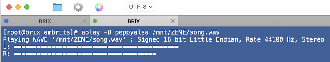

Hi!

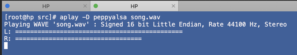

I wold like to use the PeppyMeter on my mpd (mini PC) streamer.
I would like to use the PeppyMeter on my mpd streamer. The system:
I follow de wiki doc and installed the PeppyAlsa plugin.
When I run the ./peppyalsa-client I have got the following:
If I play a music file, it's works, the sound is ok on the external dac but not show the L R indicators, like on the picture.
My soundcard:
My asound.conf:
The myfifo file is created in the /root folder, but the size is 0.
I'm stuck here. I don't know where to go next. Can anyone help me with what could be the reason it is not working? Did I do something wrong or did I not understand something well?
Thanks!
- Arch Linux
- Alsa
- MPD
- Chromium-kiosk
Code:
Peppy ALSA Client. Goya Edition. 2018/09/08
No pipe name provided, defaulting to /home/pi/myfifo
Code:
[root@hp src]# aplay -D peppyalsa song.wav
Playing WAVE 'song.wav' : Signed 16 bit Little Endian, Rate 44100 Hz, Stereo

Hi ambrits,
Was the compilation and installation of the 'peppyalsa' plugin successful? To verify that make sure the following file exists in the folder:
/usr/local/lib/libpeppyalsa.so
I guess you use USB DAC. Just to make sure that card and device is 2:0 please show the output from the command 'aplay -l'.
When you play file you can check if anything comes to the named pipe by running command:
cat ~/myfifo
It should show some binary data which looks like garbage in the terminal. That will prove that data comes to the named pipe.
Best regards

Grateful thanks for the answer!
The content of /usr/local/lib:
Code:
[root@hp lib]# ls -l
total 160
-rw-r--r-- 1 root root 82006 Feb 12 09:28 libpeppyalsa.a
-rwxr-xr-x 1 root root 987 Feb 12 09:28 libpeppyalsa.la
lrwxrwxrwx 1 root root 21 Feb 12 09:28 libpeppyalsa.so -> libpeppyalsa.so.0.0.0
lrwxrwxrwx 1 root root 21 Feb 12 09:28 libpeppyalsa.so.0 -> libpeppyalsa.so.0.0.0
-rwxr-xr-x 1 root root 70632 Feb 12 09:28 libpeppyalsa.so.0.0.0
aplay -l:
Code:
[root@hp lib]# aplay -l
**** List of PLAYBACK Hardware Devices ****
card 0: HDMI [HDA Intel HDMI], device 3: HDMI 0 [HDMI 0]
Subdevices: 1/1
Subdevice #0: subdevice #0
card 0: HDMI [HDA Intel HDMI], device 7: HDMI 1 [HDMI 1]
Subdevices: 1/1
card 0: HDMI [HDA Intel HDMI], device 8: HDMI 2 [HDMI 2]
Subdevices: 1/1
card 0: HDMI [HDA Intel HDMI], device 9: HDMI 3 [HDMI 3]
Subdevices: 1/1
card 0: HDMI [HDA Intel HDMI], device 10: HDMI 4 [HDMI 4]
Subdevices: 1/1
card 1: PCH [HDA Intel PCH], device 0: ALC221 Analog [ALC221 Analog]
Subdevices: 1/1
card 2: Audio [DigiHug USB Audio], device 0: USB Audio [USB Audio]
Subdevices: 1/1
card 2: Audio [DigiHug USB Audio], device 1: USB Audio [USB Audio #1]
Subdevices: 1/1
Wow, when I run the cat /root/myfifo and play the sound, it works. The indicators appears. I don't say that I mean exactly 🙂
According to these, PeppyAlsa installation is fine.
I need to install Peppymeter now.
I try it!
Thank you so much!

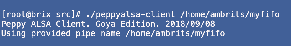

Hi rpi!
I installed Peppy Alsa to my non-test system.
When I play a song with aplay, it works fine, the myfifo include characters and appears the indicators.
If I play music with MPD, the mpd.log show this:
Feb 12 22:26 : player: played "Jazz-instrumental/Buddy Tate & Harry Edison/2019 - i cried for you (DSD)/01 - I've Got the World on a String.dsf"
Feb 12 22:26 : exception: Failed to open "peppyalsa" (alsa); Failed to open ALSA device "peppyalsa": Device or resource busy
My MPD conf:
asound.conf (In the forum, I see the mistake and there as if such a setting would have been the solution🙂
What do I do wrong?

Can you try to play just a regular WAV file? Also make sure that there is only one program which is "listening" to the pipe either PeppyMeter or peppyalsa-client, not both. Also there can be only one writer to the pipe.
1. If I start the cat /home/ambrits/myfifo command, and parallel play a wav file, it works.
2. moving step by step so I have not installed Peppymeter yet, I only installed PeppyAlsa. After that try with mpd play. Peppysya-Client has no compiled on this machine.
If I understand the operation when I start a cat /home/ambrits/myfifo command, this command is the "listener" and it works when I play a WAV file.
Since there is no peppyalsa-client and no peppymeter what else can be listener?

When I switched HW: 0 to HW: 1, then the MPD error message has been discontinued, but if I run cat /home/ambrits/myfifo, it does not show anything. If I use HW: 0, peppyalsa is busy. My DAC is on the hw:0.
Code:
aplay -l
card 0: UD503 [UD-503], device 0: USB Audio [USB Audio]
Subdevices: 1/1
card 1: PCH [HDA Intel PCH], device 0: ALC255 Analog [ALC255 Analog]
Subdevices: 1/1
card 1: PCH [HDA Intel PCH], device 3: HDMI 0 [HDMI 0]
Subdevices: 1/1
Well guessing if I run Peppysya-client when MPD is playing, do I have to see something? If so, sorry is nothing 🙁
