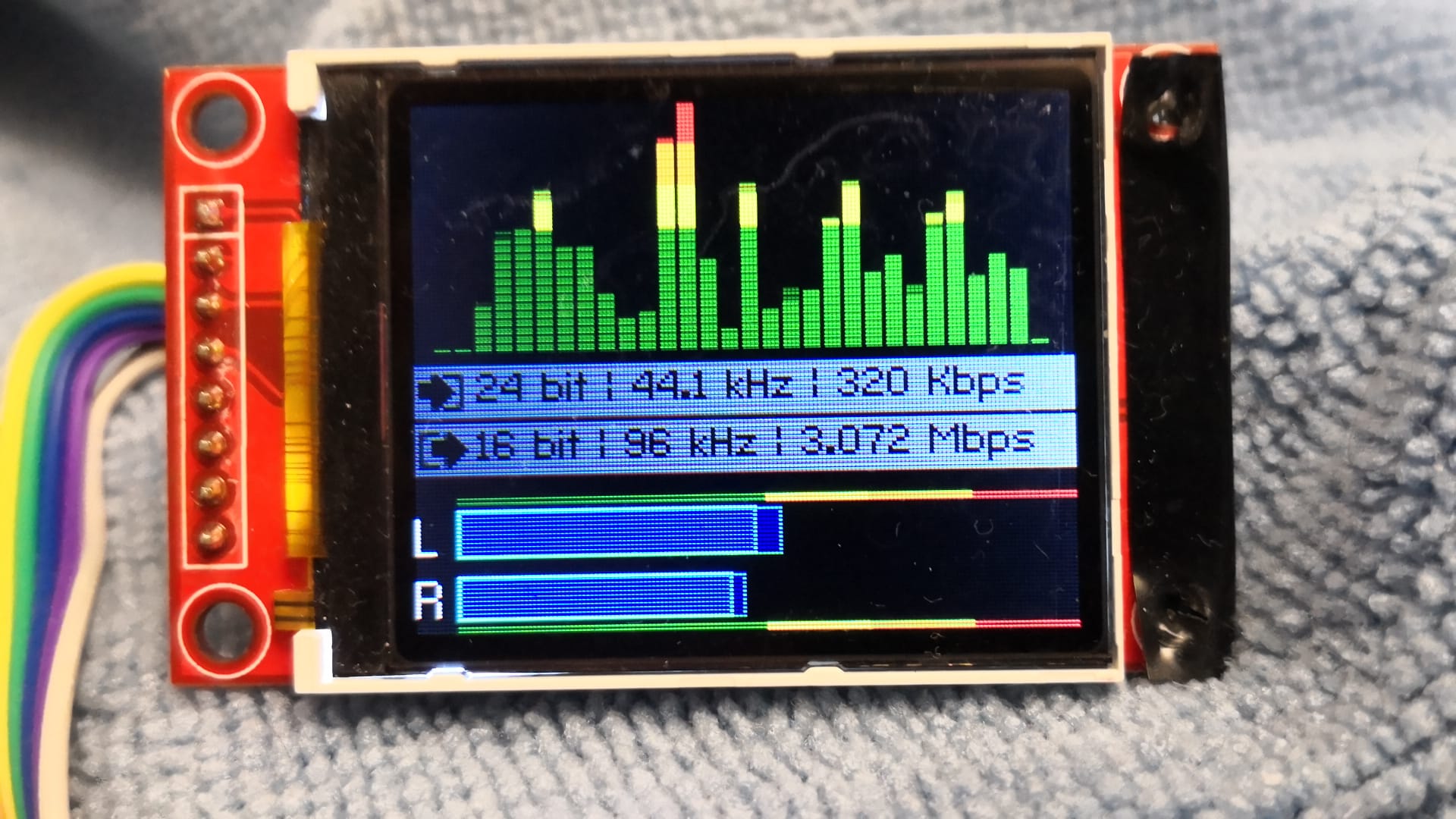

Hello Rpi, hello everybody,
I am working on my initiative to group some information on the same screen: in this particular case I would like to insert frequency spectrum, info on the input and output music flow and a bar VU Meter.
As you can see from the attached image everything is working but I had to use CAVA as the source for the spectrum and, of course, peppyalsa as the source of the VU meter.
My goal is to use peppy alsa's two FIFO files for both applications, but unfortunately I failed. In particular, if I insert "spectrum_size 30" in the configuration I expect to receive 60 bytes with the info: High and Low Freq.1 ..... up to ..... High and Low Freq.30, and instead I receive 120 bytes of which the first pair is significant and the second is not (only zero). It would seem as if, even for the spectrum, there is "LEFT and RIGHT" even if the second pair (the one that could, according to this theory be the right channel) is always at zero.
Trying to decode the info it would seem that the frequencies are not like what I hoped to expect (25, 32, 40, 50, 63, 79, 100, 126, 157, 197, 250, 320, 400, 500, 630, 790, 1000, 1260, 1570, 1970, 2500, 3200, 4000, 5000, 6300, 7900, 10000, 12600, 15700, 19700).
Is anyone able and willing to help me?
Thanks in advance and best regards to all,
Francesco

Hi rpi,
Thanks for the reply, the result is unfortunately not changed because I was already taking the least significant bytes into account; probably the frequencies I have considered are not correct: would you be kind enough to show me where I can find them?
Sincerely and thanks again,
Francesco

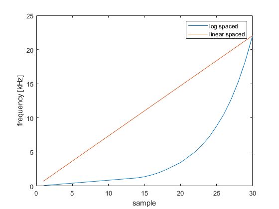

Hi fdealexa,
for every spectrum 512 time-domain-samples are taken. The fftw-algorithm calculates an output of 512/2+1 values, while the first one is the DC-part of the signal.
If you select a linear frequency axes of 30 values, the frequencies are
f👎 = n * (sample_rate/2) / 30
resulting in x kHz:
Code:
0.735000000000000	1.47000000000000	2.20500000000000	2.94000000000000	3.67500000000000	4.41000000000000	5.14500000000000	5.88000000000000	6.61500000000000	7.35000000000000	8.08500000000000	8.82000000000000	9.55500000000000	10.2900000000000	11.0250000000000	11.7600000000000	12.4950000000000	13.2300000000000	13.9650000000000	14.7000000000000	15.4350000000000	16.1700000000000	16.9050000000000	17.6400000000000	18.3750000000000	19.1100000000000	19.8450000000000	20.5800000000000	21.3150000000000	22.0500000000000
for an input if 41.1kHz. For log-spaced frequencies it is more complicated, as for the lower frequencies the resolution of the fft is not high enough to use log spacing in the lower frequency band.
the log-spaced frequencies are [kHz]:
Code:
0.0861328125000000	0.172265625000000	0.258398437500000	0.344531250000000	0.430664062500000	0.516796875000000	0.602929687500000	0.689062500000000	0.775195312500000	0.861328125000000	0.947460937500000	1.03359375000000	1.11972656250000	1.20585937500000	1.37812500000000	1.63652343750000	1.98105468750000	2.41171875000000	2.92851562500000	3.44531250000000	4.22050781250000	4.99570312500000	6.02929687500000	7.23515625000000	8.78554687500000	10.5082031250000	12.6615234375000	15.2455078125000	18.3462890625000	22.0500000000000
You can find a graphical representation in the attachment.
Unfortunately there is no physical correct way to combine the frequency bins, so the fft output is summed up over the values inside of a bin. This can cause a bit of overlapping.
The output is unsigned int, mono.
I got really good results using PeppyPlayer and the screensaver in it. I tested it using a frequency-generator-app on my mobile connected via bluetooth. You can see the result of a frequency sweep for spectrum_size = 32 in the attached movie.
If the amplitude of the signal is to high, there is distortion resulting in additional frequencies.
If you use spectrum_size = 256 you will get fine needles for pure sine input.
Kind regards
Tobias

I forgot to mention that there might be still a bug in the Spectrum part of Peppyalsa. Did you compile it by yourself? You can try this:
in spectrum.c, lines 190 and 191:
pow( output_buffer[m][ 0 ], 2 ) +
pow( output_buffer[m][ 1 ], 2 ) );
you have to change the index m to x:
pow( output_buffer[x][ 0 ], 2 ) +
pow( output_buffer[x][ 1 ], 2 ) );
In the next release it will be certainly fixed.
Best regards
Tobias
Hi Tobias,
the line you mentioned to be modified is at 189 but, unfortunatly, I don't know how to compile it: is it enough "gcc -o"? Could you please be so kind to help me on this matter too?
thanks in advance and best regards,
Francesco
Hi Tobias,
the problem was, most likely, related to the fact that I applied the change to the package downloaded directly from the PEPPYALSA GITHUB.
By downloading from your GITHUB and applying the change, both the "console spectrum" and my program work.
There is still a small area, larger in the linear case, that is not used because it is really outside the frequencies normally used in HiFi. For this, do you think a fixed frequency scale may be possible?
Thanks again and greetings,
Francesco
Hi Francesco,
that's interesting. I have to check where the difference in both sources is.
If you don't like to see the upper most frequencies, you can simply request a spectrum with e.g. 31 bins and ignore the last value.
It is also possible to hard-code the frequencies in spectrum.c, if needed. All you need is to create fill
Code:
unsigned int bins[spectrum_size+1];
with the indices where your frequencies are. The index can can range from 0 to 256, where 0 is 0Hz and 256 is samplerate/2. The frequencies are equidistant distributed.
Kind regards
Tobias
