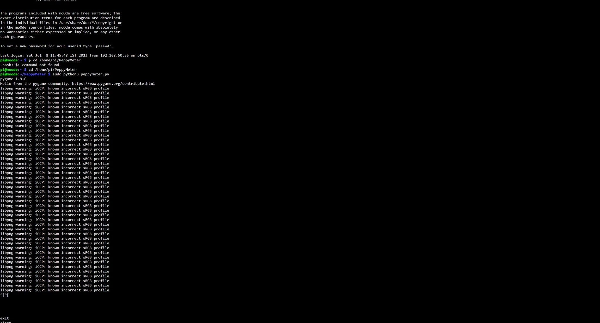

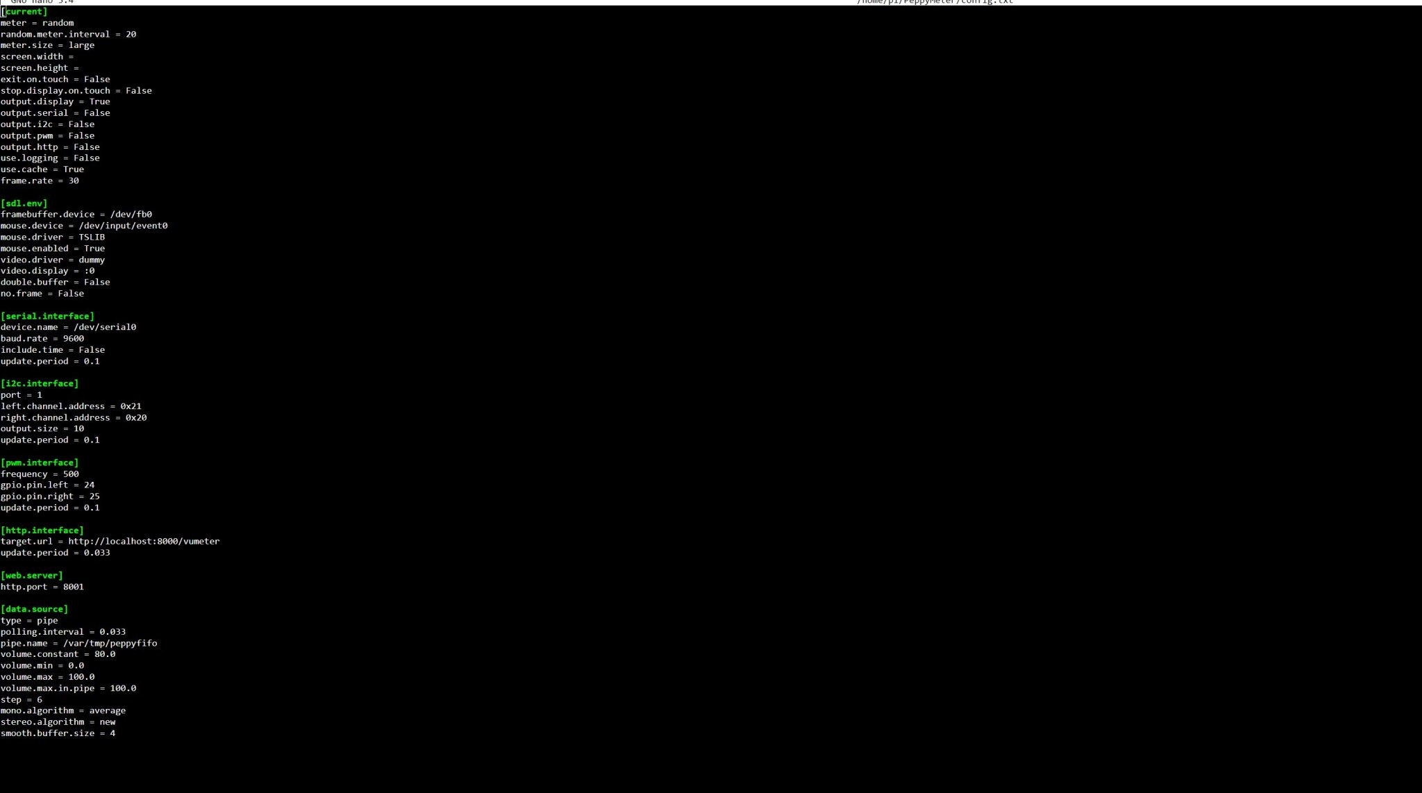

Dear @rpi I have recently activated PeppyMeter on Moode Audio with the help of @fdealexa. I have successfully completed the installation but stuck at the last stage. Though I have requested @fdealexa also to look into the issue but if you can also look into the logs and share your inputs please ---
1. When I am running the below command my 4k display goes blank, I have attached the logs..please suggest what is wrong ?
cd /home/pi/PeppyMeter
sudo python3 peppymeter.py

Kindly suggest please what changes I can make to get the Peppy Meter working on my 4K display.
2. If you can also please suggest me what will the right configuration for 4K display considering the logs I have attached.

Just to clarify some points:
  • The maximum resolution of the PeppyMeter is 800x480 (large) and 1280x400 (wide). That's why it will not occupy full screen of your TV. You can get meters in a higher resolutions on a Volumio forum but meters in resolution 3840x2160 don't exist at all as far as I know.
  • You can change the reolution of your screen (/boot/config.txt) and set it to 800x480 for example.
  • The screen resolution can be specified in the PeppyMeter configuration file (properties: screen.width and screen.height).
  • Meters coordinnates on a large screen can be specified in files meters.txt for each meter type.
  • I don't know how PeppyMeter works with Moode. Probably Francesco can clarify how it can be started/stop with Moode.
