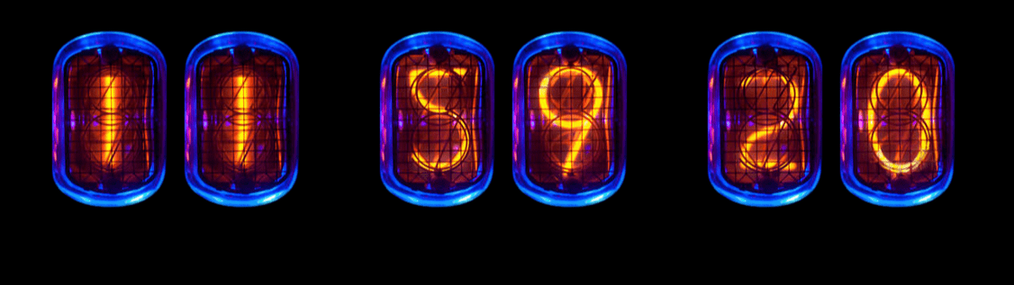

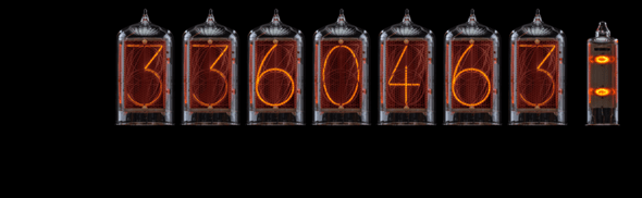

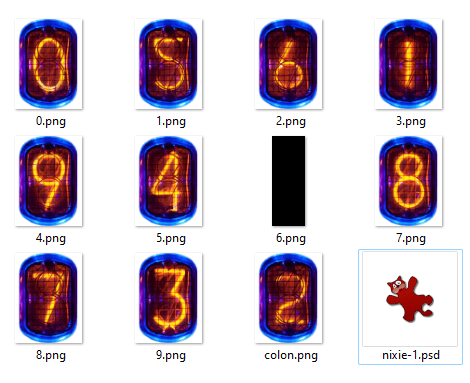

thanks for the fast reply. It worked, somehow. But for "image"-mode of the clock something strange happens, the assignment of the images does not work as expected:
Instead of the colon, a 6 is displayed, number 3 shown as tube is in fact a 1, if I see the colon, it is meant to be a 2 and so on. I renamed the Nixie-Images and time is presented correct:
Do you have a similar issue?

Hi, this is a bug in the code. The default file sort order is different on Windows (used for development) and Linux (Pi).
The following line should be added to fix the issue:
https://github.com/project-owner/Pe...3aaa00679ebb3/screensaver/clock/clock.py#L186
I'll update the disk images soon.
