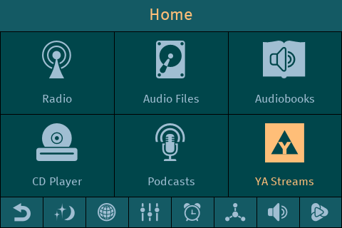

- Added new mode - YouTube Audio Streams (YA Streams). It allows to listen to YouTube audio streams.
https://github.com/project-owner/Peppy.doc/wiki/YA-Streams

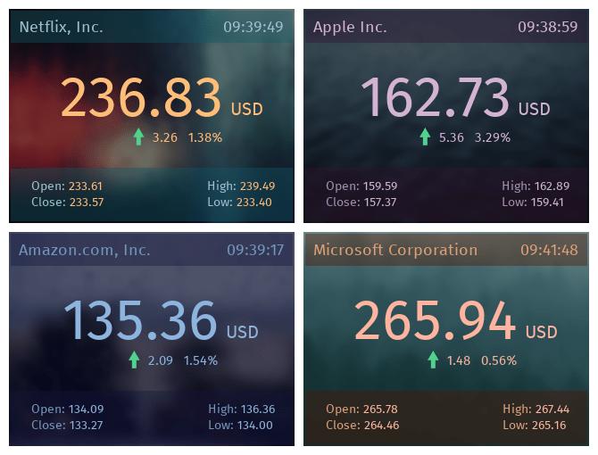

- Created new screensaver - Stock. It fetches the current information about specified stocks.
https://github.com/project-owner/Peppy.doc/wiki/Stock
