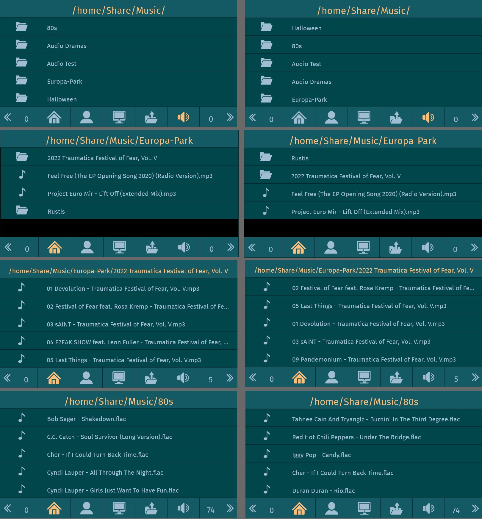

File browser sort order:
Sorry i did overlook that in your Wiki. Normally its my first point of call.
I was confused that then the folders are also sorted alphabetically.
Is it possible to sort like Windows? Alphabetically but folders first.

To see the folders first, you need to set sort.by.type = True as explained here:
https://github.com/project-owner/Peppy.doc/wiki/File-Menu#sorting
The only difference with Windows will be that images will come before folders. I should probably introduce new configuration properties which will control the order of different file types and ability to disable some file types (e.g. images).

2. There are no images in the folders. And if i want the folders first (Sort by Type), why are the files not alphabetically?
Left side is without "Sort by Type":

That's how sorting works right now- it sorts either by file type or alphabetically: https://github.com/project-owner/Pe...ea31152ad773777a0f590c9/util/fileutil.py#L211
I'll try to improve it in the next release (tentative date - end of December).

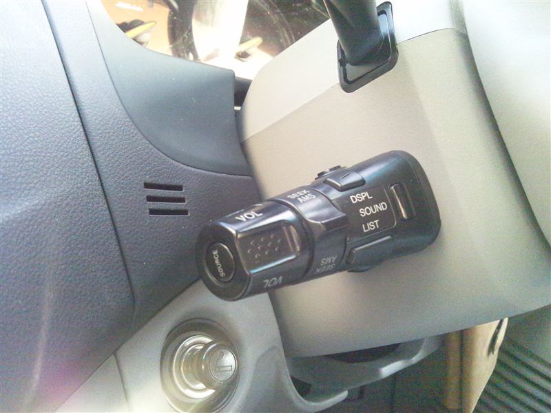

I need to control it via Bluetooth in the car and thought a BT HID device would work.
I already ordered this little guy: https://www.seeedstudio.com/Seeed-XIAO-BLE-nRF52840-p-5201.html
The idea is to use an old school Sony RM-X4S:
It would open all kind of possibility's to control Peppy.

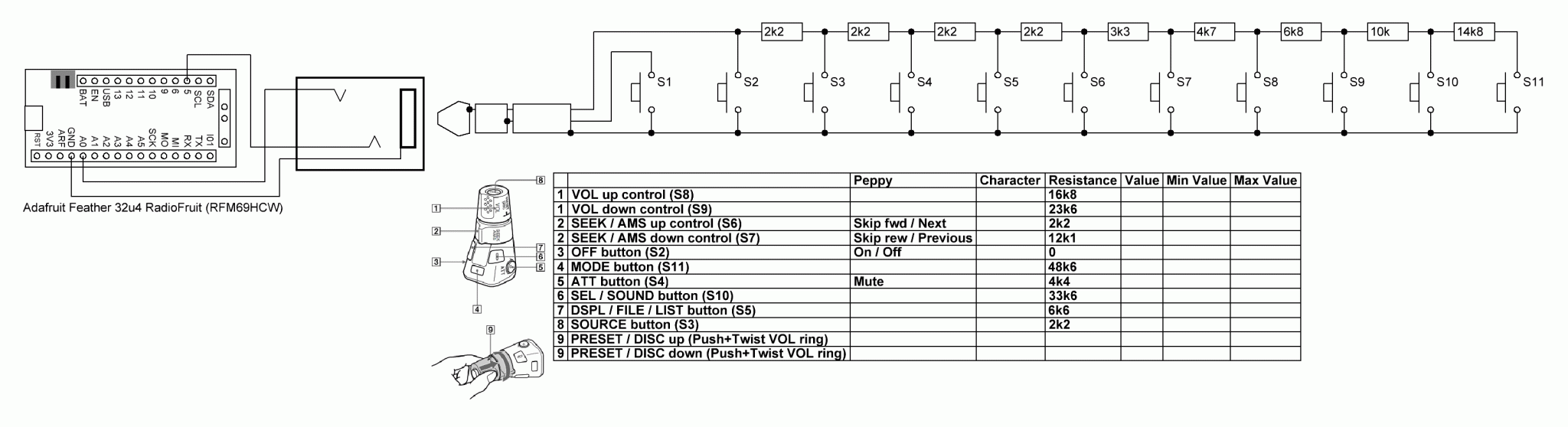

Since you said "dummy driver doesn't handle keyboard events" i was thinking about using a HDMI Dummy.
But i also want on/off via the remote and that will not work over BT because if off BT does not work.
So now I will use RF and ordered some Adafruit Feather with RFM69:
https://www.adafruit.com/product/3077
They have lipoly charger onboard so i don't need to think about how power is handled.
I also did thinks in the past with RFM69 so I have experience with it.
I can use I2C or serial to communicate with the Odroid (Peppy).
Here is a quick sketch of the remote/transmitter:

You still need to integrate that Adafruit Feather to the Peppy player.
I'm not sure how you are going to connect that Sony remote to the Odroid. As far as I understand this is a wired remote which connects through the cable. Can you connect it to Odroid using the audio jack? If this is the case why do you need anything else? Do you want to control the player from that wired remote and from wireless remote?

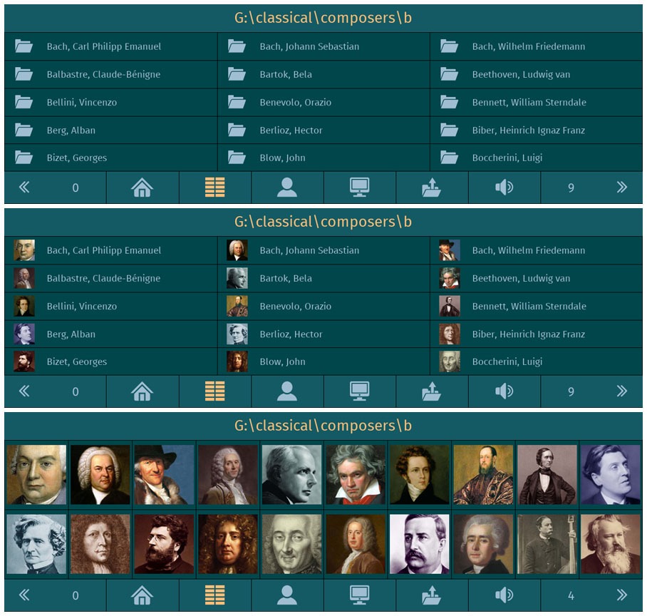

- Added File Browser Quick Configuration popup menu:
https://github.com/project-owner/Peppy.doc/wiki/File-Browser-Quick-Configuration-Menu
It allows quickly change different File Browser parameters.
Here is the example of switching from the List view to the Icon View, enabling/disabling folder images and changing the number of rows and columns (resolution 1280x400):

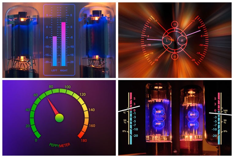

- Refactored the VU Meter screensaver. Added new default meters.

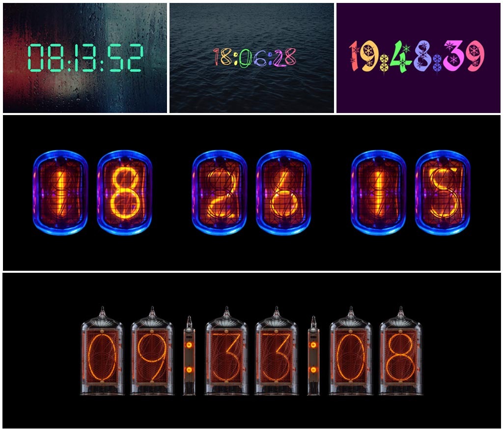

- Improved Clock screensaver:
https://github.com/project-owner/Peppy.doc/wiki/Clock
It's possible now to enable seconds, change font and use images for the Clock screensaver.
Here is the example of using different screensaver parameters (resolution 480x320 and 1280x400):
