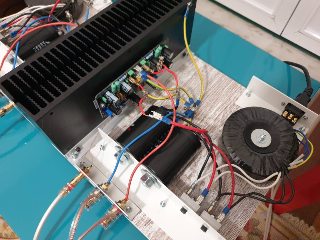

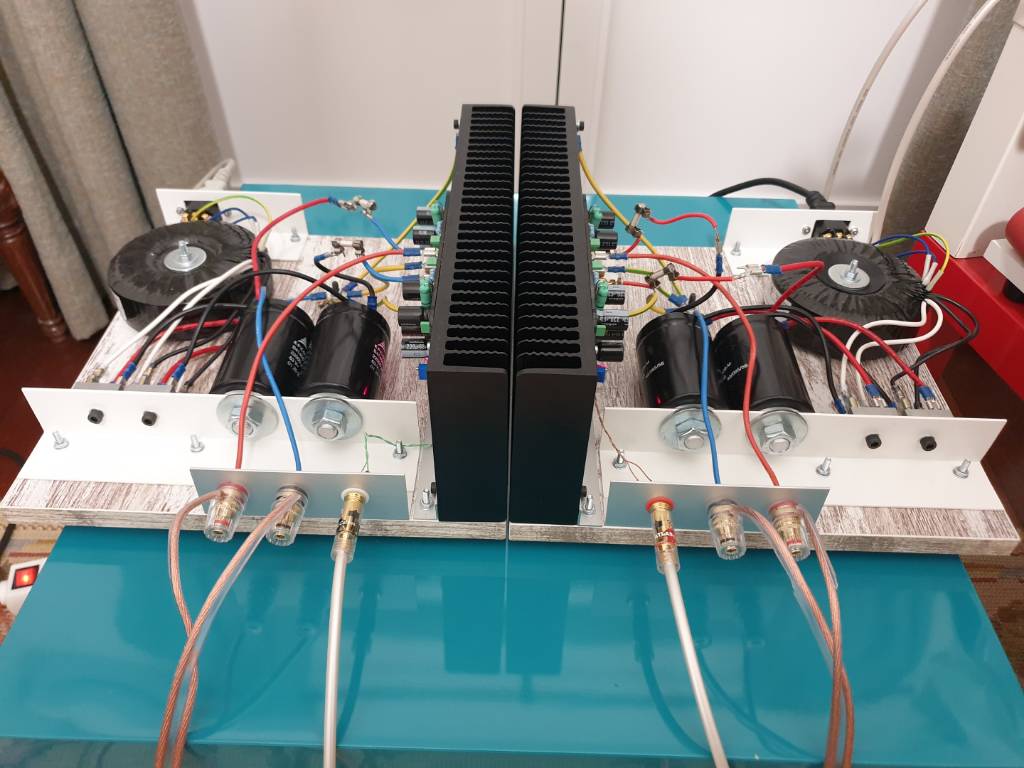

hello... bad news... after an hour of playing i heard a pop on one speaker a music stoped then bzzz... when i got close to the amp i see the little firework and smoke and very bad smell... so.. one amp is gone😡😡... i have to check later if was something related with the dac (once i had a problem with one channel of the dac blown away) or the speakers... i don´t know why the fuses on rails did not break (8a fuses), the transformer was hot and main filter caps also....this amp is not an easy animal...🙂
i was controlling the temperature since beginning and the amps were around 40 º celcius but after a wile they got hotter around 55/60º.
i think the amp over heated.. what should be the normal working temperature?? any problem with 4 ohm speakers?

My congratulatory message for getting your V4H powered up has now turned to troubleshooting. From your pictures I noticed the heatsinks are mounted flat to the board. The fins need to overhang the board and be raised so proper convection airflow is enabled. As built, the heatsinks are ‘suffocating’ and will not effectively cool the V4H. Also, as Shaan pointed out, please use some sort of dc speaker protection, rail fuses are not sufficient protection.

This amp is a very easy animal when there is no sustained short circuit or inadequate cooling. The fact that the transformer and filter caps are hot seems to suggest the channel has been under immense stress for more than just a few minutes. If that was due to a short circuit, the mosfets didn't die immediately possibly because their on resistance (around 1ohm each) and the zener diodes were trying to limit the current.

I have been running the amp in 43C summer heat with heatsinks similar to yours and with fins open to the air and it has no issue driving 4ohm speakers.
I think you are right, it overheated. Looking back at the pictures you shared, it seems there would be problem for fresh air to reach the heatsink fins.
Before dismantling the channel, carefully check for shorts between the mosfets' Pin 2 and heatsink metal.

You are right the amp strougle 30 seconds or more before blow up... the problem is that i was resting listen to music and heard the pop and get up and tried to find witch amp was connect to the speaker making noise...should disconnet the power faster.
In the weekend i will try to troobleshoot.
I m using that thermal pads instead mica and grease.. could that be also a problem?
As Vunce and I suspected before, when the fault happened, were the channels situated like in the pictures you shared? If yes, then this can slowly push any amp into the thermal danger zone!
Thermal pads are fine.
