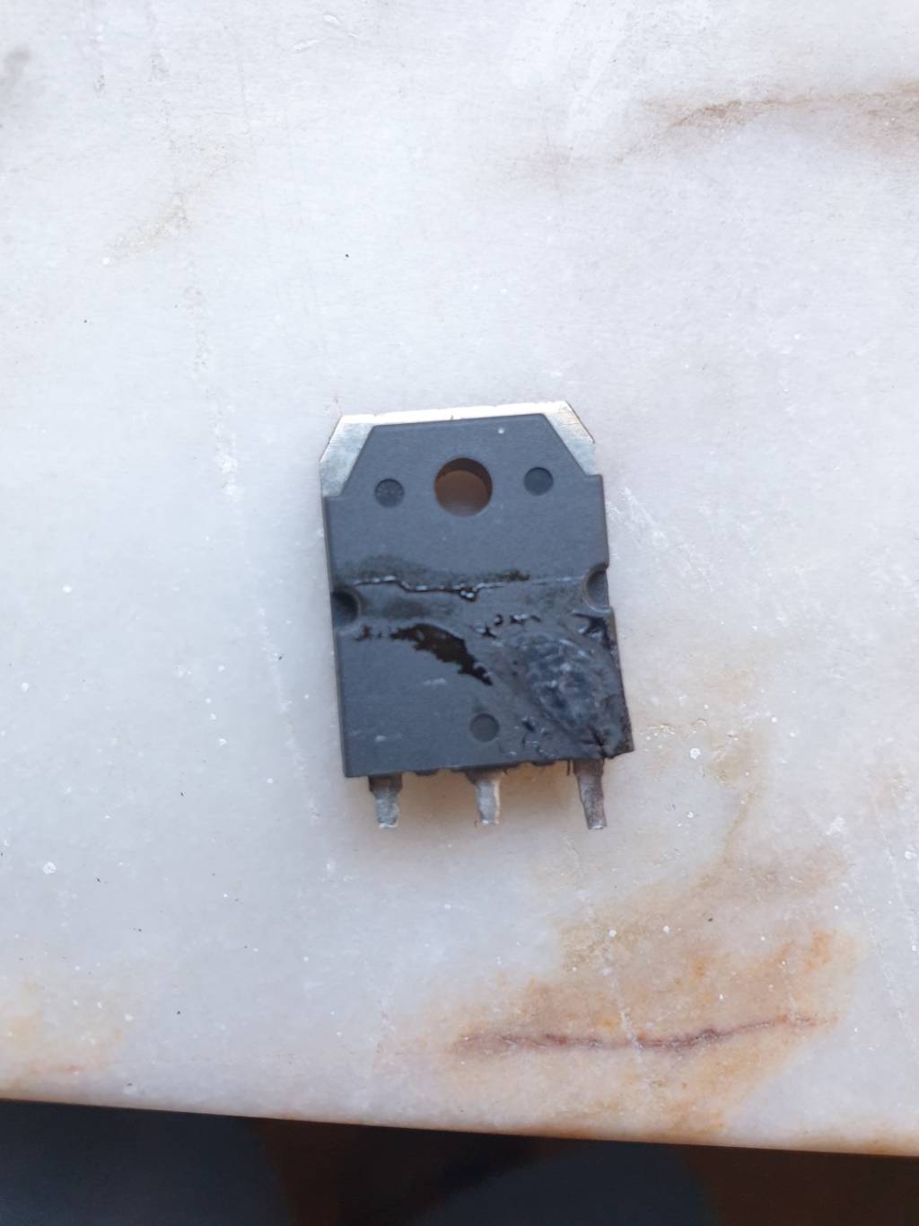

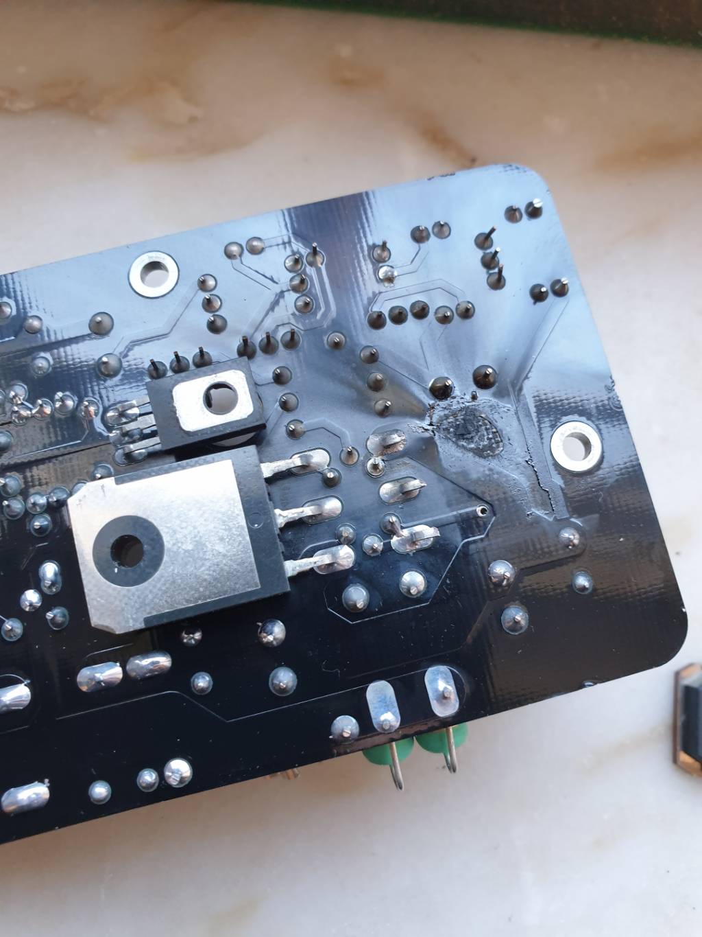

Hello Shaan, i want to start troubleshoot the sick amp.
On the good amp i will put the heatsink fins floating of the wood.
The sick amp:
1- I tested mosfet pin 2 (midle pin) continuity to heatsink and i don t have continuity.
2- i found the positive rail fuse blown.
When i saw fire and smoke was on the right side.. i don t know what burned....
What should i do now?

Check if the mosfets are shorted between drain and source. Set the meter to diode test mode, for Q11 and Q13 connect red probe to pin 3 and black probe to pin 2, for Q12 and Q14 swap the probes.
Looking from the input side, Q12 and Q14 are on the right side. You may desolder them from the board and individually check the MOSFETs.

On the first amp i have one k1058 bad and an j162 bad( burned one)
On the second board i have only one k1058 bad...

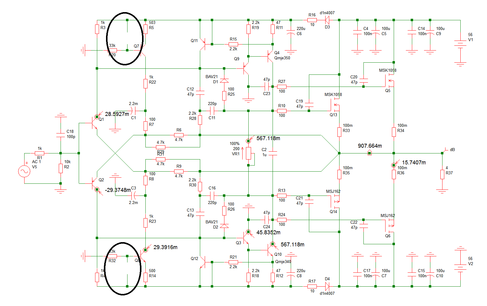

Hi Pistollero.
I have abused the amp (particularly after rev2 mod) so much, so many times, in so many ways that unless something was seriously wrong, like a fake or misplaced component, it just works.
From your reports I could not figure out a problem in the design that might cause it to do what it did. First I thought the MOSFETs are fake, but it looks like they are not. Then after backtracking for sometime I found that a few days ago the LEDs were placed in reverse (effectively absent in the circuit) and the amp was given power (post#1606, post#1617).
So I simulated it to check what fault condition may occur with the LEDs not present in the circuit. The readings are well in the red zone! Check the attachment.
With the LEDs absent, the current sources go out of control, the input pair is passing about 20 times their normal bias current, the VAS buffer is passing about 50 times and VAS stage (and VR1 trimmer) passing about 55 times. Real world readings will vary somewhat but will be similar, and if that doesn't cause the components to let off smoke immediately it may cause some internal damage to some of the overloaded components so that they work normally for some time and when conditions such as load or temperature changes they start working out of their specifications. Exactly which way this may have caused the MOSFETs to blow is hard for me to say without direct probing, maybe the high current degraded the conductive strip of VR3 or maybe something else, but I think this is what has happened in your case.
It is recommended that you check each transistor, possibly after desoldering them from the board, or better just replace the whole set, as after such faults sometimes they read fine in a meter, but fail in the circuit. Also measure all the resistors and replace the ones that seem to deviate from their values, that includes the three trimmers.

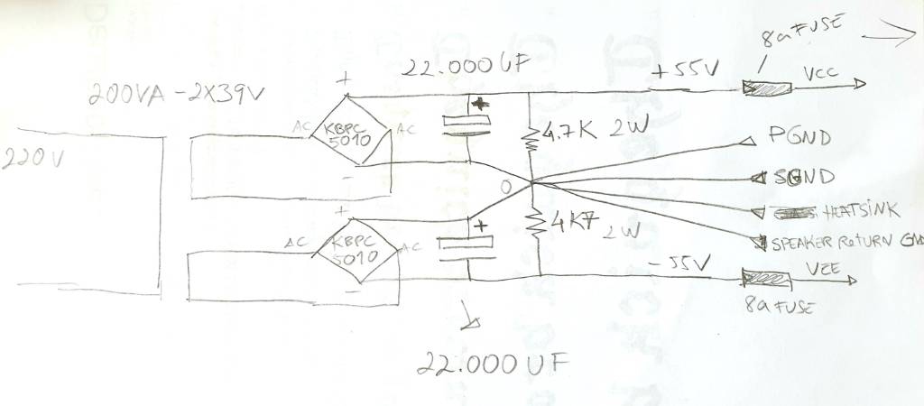

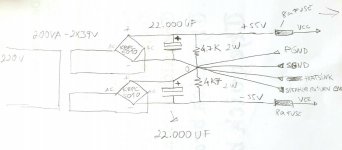

later i will post the schmematic and how a made the connections of my psu for you and others to see if is anything wrong that could damaged the amp.
The power supply has DC protection for the speakers, no protection for the amp modules. The MOSFETs are given basic protection for momentary short circuits with the SMD diodes but only as long as as the diodes themselves are not overloaded/damaged by the previous stage.
