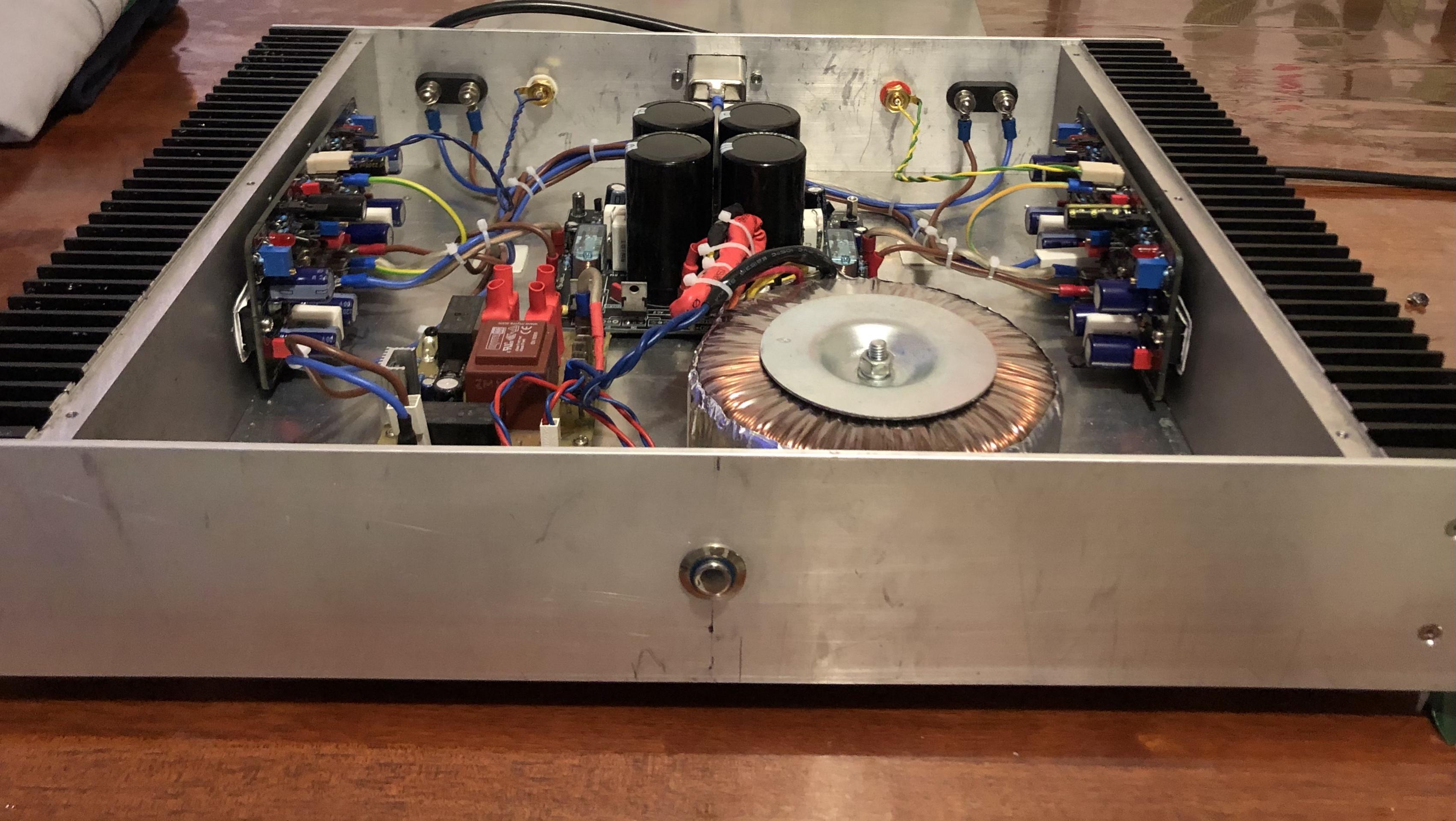

Below is a picture of a previous revision of V4H, which has then been upgraded to the latest version. And plays fantastic, is very happy. Runs on KEF 107 speakers.
Power supply is from SMPS 800VA with ± 55V, all built in dual mono.
