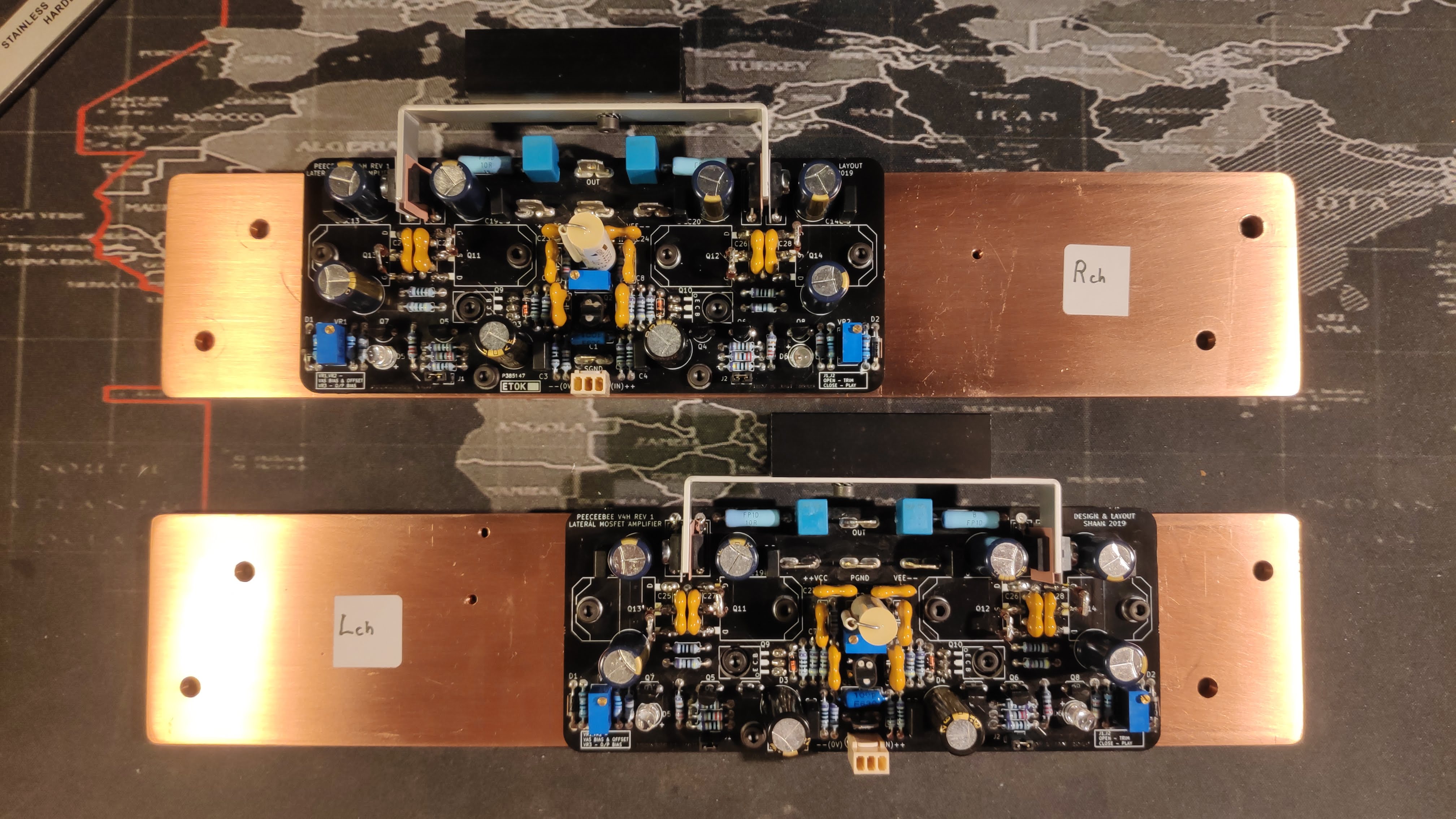

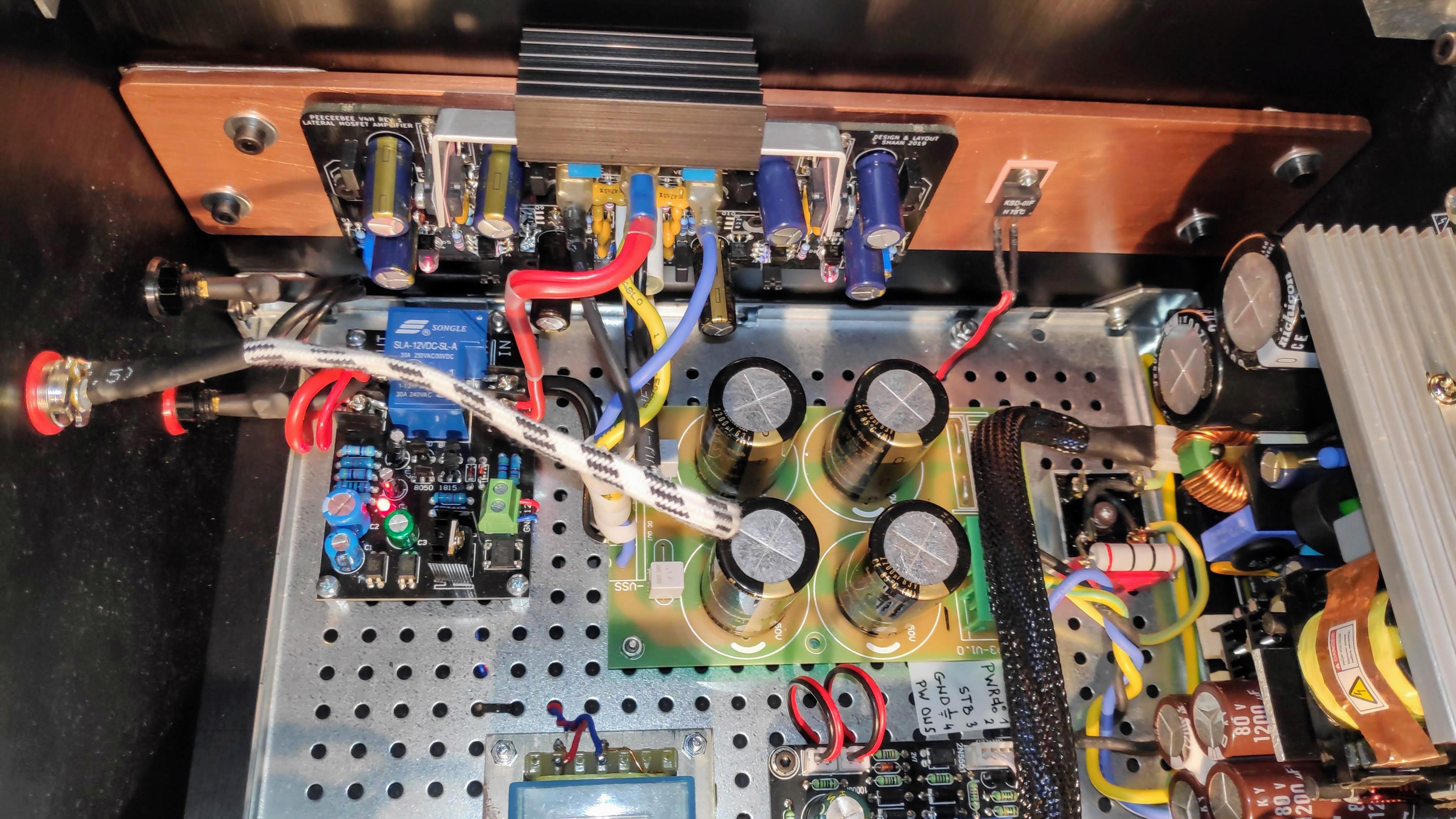

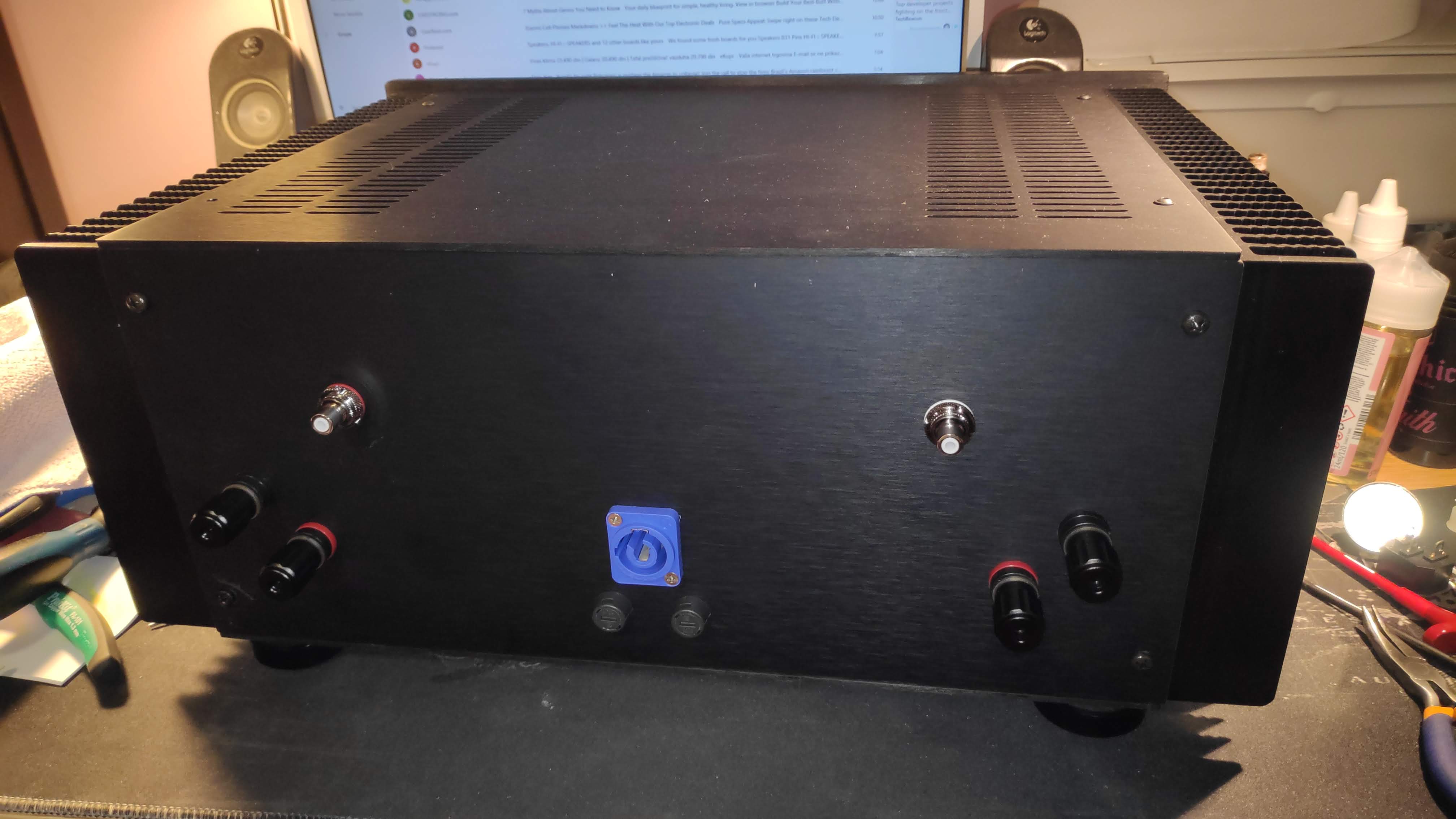

Finally done! I'm a happy owner of a V4H amplifier.
Actually it has been a couple of weeks now since I finished it but I got stuck in work so I had no serious time for listening and reporting till now...
I am very happy with the sound. To my surprise, it turned out to be much more in control of my SBA10 speakers bass compared to FO1.4M. And all of that with half of power from pair of Sammi's SMPS600 (VS Hypex 1200 on FO)
Tonality is superb, imiging spot on. I would say that only thing that I miss compared to FO1.4M is midrange sweetnes to some degree. But in the end I feel that V4H is more true to the source.
Special thanks to Shaan for the support and patience, who made this build and amp setup a pleasant DIY experience!!! 🙂

That is really a nice build Bassivus , congratulations 🙂
I still have also SBA-10 speakers.
Fab
Fab
Thanks Fab!

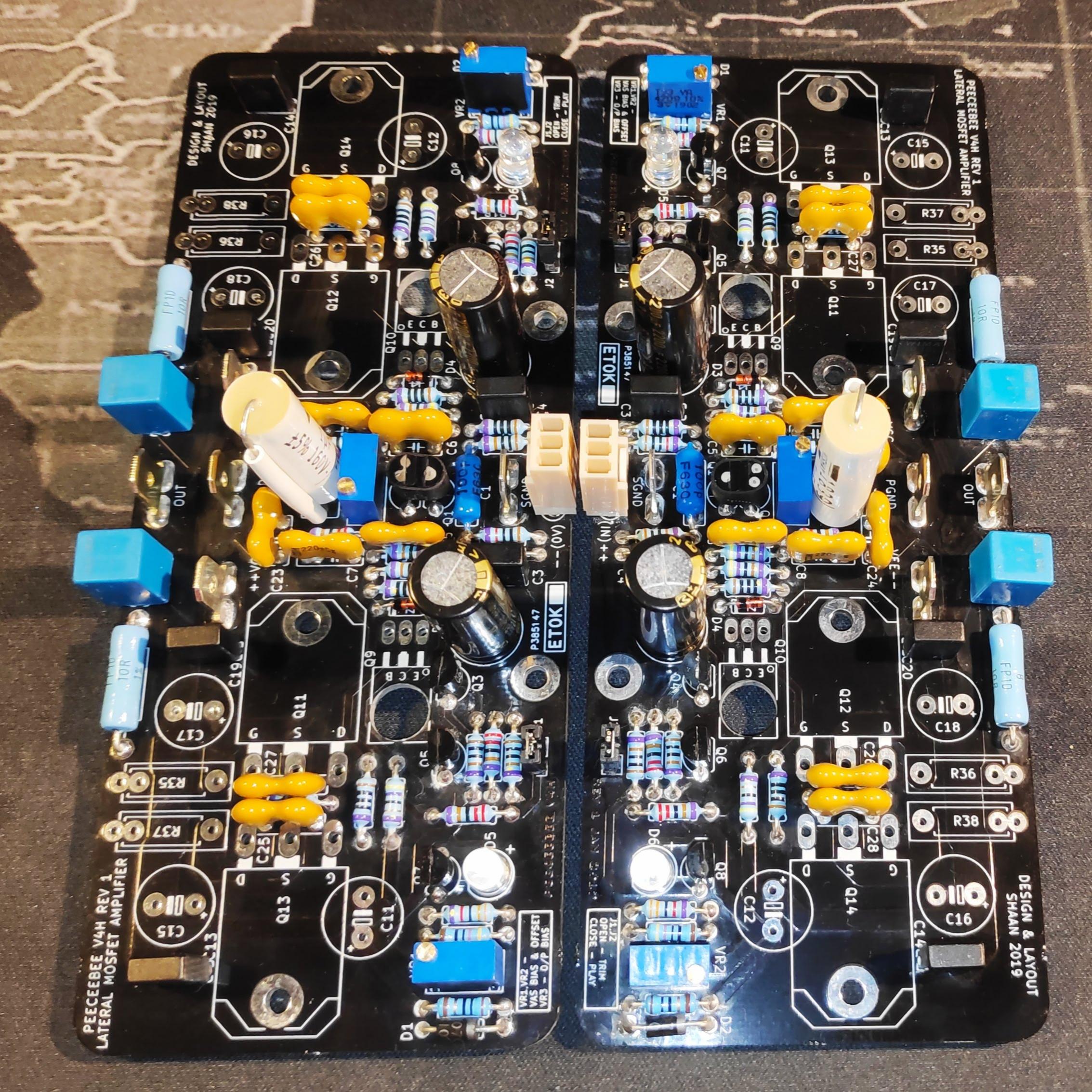

Hi Shaan, I have a DC offset of +350mV at one channel output, can you please tell me what could be the problem and what components should I test?
Mosfets are matched as Q1/Q2 too.
