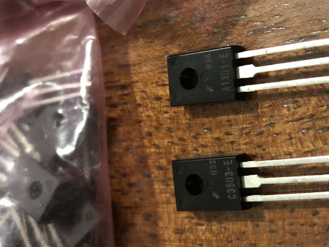

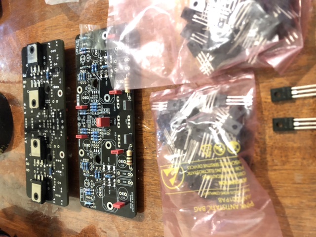

Thanks a lot Shaan, one additional question I would like to ask is, can I use the complimentary C3503 and A1381 instead of mje340/350 without affecting stability of the amplifier? Attached is the picture of the transistors and my build in progress.

Hi mj777,
Have used alternative transistors for MJE340 / MJE350 with the transistors KSA1220A / KSC2690A with good results. The V4H amplifier with version rev.1 and performed all upgrades that a rev.2 version requires. Adjustment and testplay went straight ahead.
Is very satisfied with the finished product of V4H. I chose to use SMPS at 800Watt (it continuously delivers 500W at 25 ° C), and the amplifier is set up as Dual Mono.
Regards
Helge
