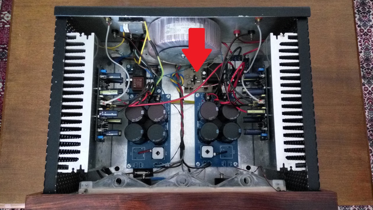

Finally, here some pics of the amp
wow! super nice. where did you connect the meters?
In this module, I think.
Yes Shaan is right, the VU meters panel is taken from an old Uher reference 1 150W power amp which used STKs at the output stage and had awful sound, I copied the VU driver stage to a protoboard and the VU meters are driven exactly as they originally were, the meters driver is fed directly from the amp's output.
Wow, so you're not feeding line level signals to the driver? Does this mean the driver board doesn't need any on-board amplification and a passive bridge rectifier is enough?Yes Shaan is right, the VU meters panel is taken from an old Uher reference 1 150W power amp which used STKs at the output stage and had awful sound, I copied the VU driver stage to a protoboard and the VU meters are driven exactly as they originally were, the meters driver is fed directly from the amp's output.
