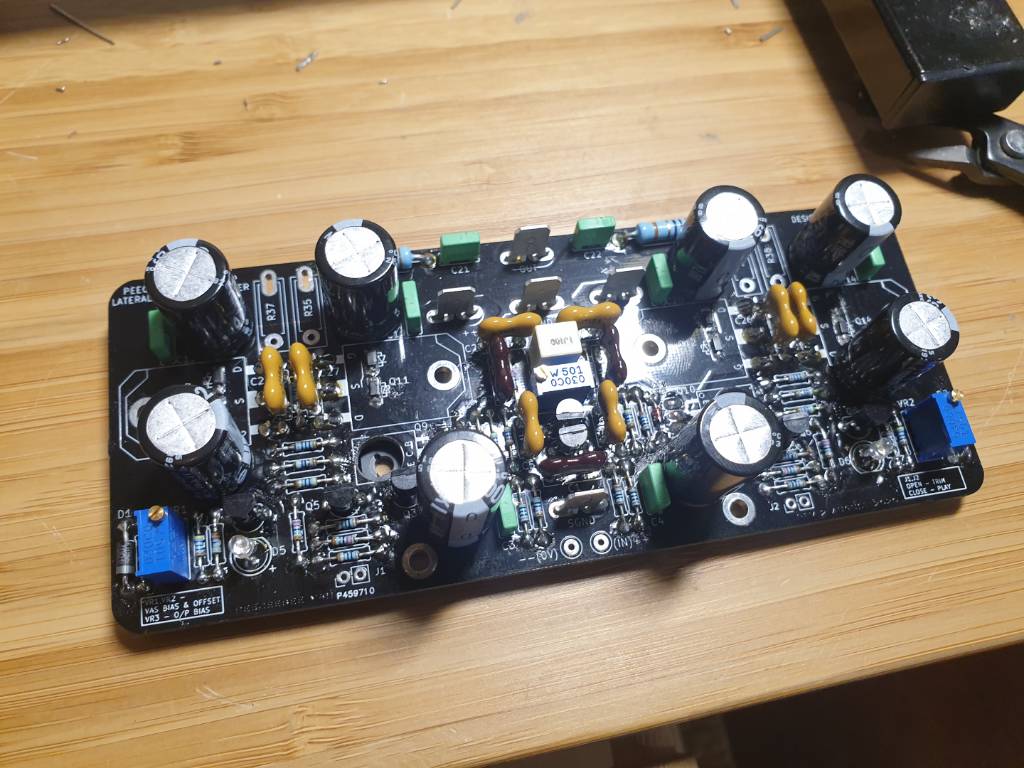

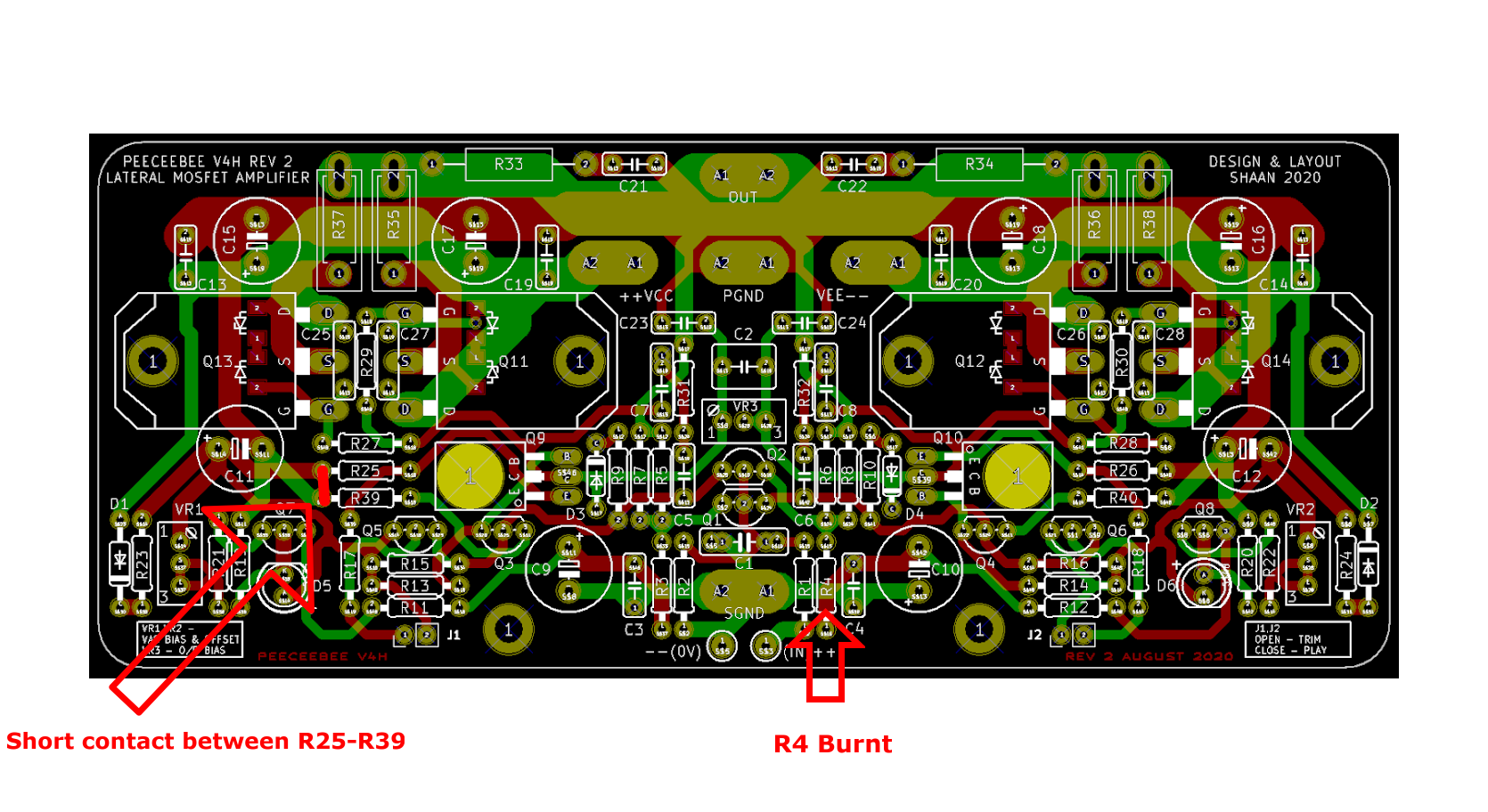

Hello,
please HELP 😕
When setting VAS biasing, I was carelessly manipulating the multimeter probe and a short time I connected the legs R25 and R39. :headbash:
It sparkled a bit and the R4 resistor burned out before I turned off the power on. Shown in the picture below.
What was destroyed? Transistor? Who? :scratch:
I'm not an expert to find a mistake. I can only measure components if I know which ones.
I hope this is a small problem and I can repair it.
Thank you for the advice. :worship:

Hi Robodo.
Check all the resistors. Replace the burnt ones.
Check all bipolars for base-emitter and base-collector voltage with multimeter in diode test mode. For Q1,3,5,7,9 black probe goes to base, for Q2,4,6,8,10 black probe goes to base. Pin 2 is base for small bipolars and pin 1 is base for Q9/Q10. If any junction shows open or short, replace that transistor. Remove jumpers before probing.

Hi shaan,
Thank you for your help. I measured all the resistors and replaced only the burned R4, the others were fine. Then I measured the transistors and I detected faulty Q2
First I also desoldered the Q4, Q8 and Q10 because I thought they were also defective,...
shaan said:
...for Q2,4,6,8,10 black probe goes to base
...before I found out that for NPN transistors it is necessary to apply a red probe goes to base and then these transistors were already good.
So I soldered them back. I'm glad I have more of these transistors, because I destroyed the desoldered ones.
After attaching the finished board to the heatsink and connecting the power supply. Everything seems to be fine.
Tomorrow I will make setup VAS, Offset and more, I'm finishing today.

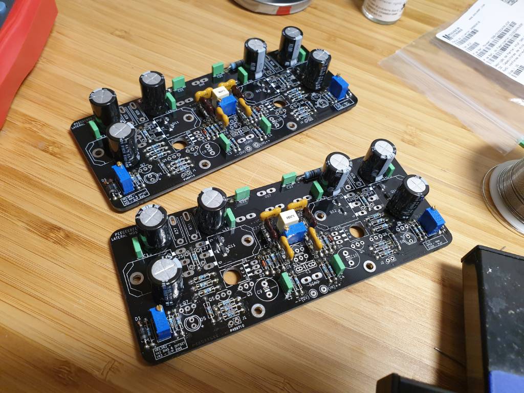

I don't like two differences. It just seems to me that the LED D6 versus D5 is a little dimmer. And resistance between the output terminal and heatsink body is 4,7 MOhm.
This does not happen with the second PCB module. I already have it installed and all setup fine.
Any advice? Thank you.
