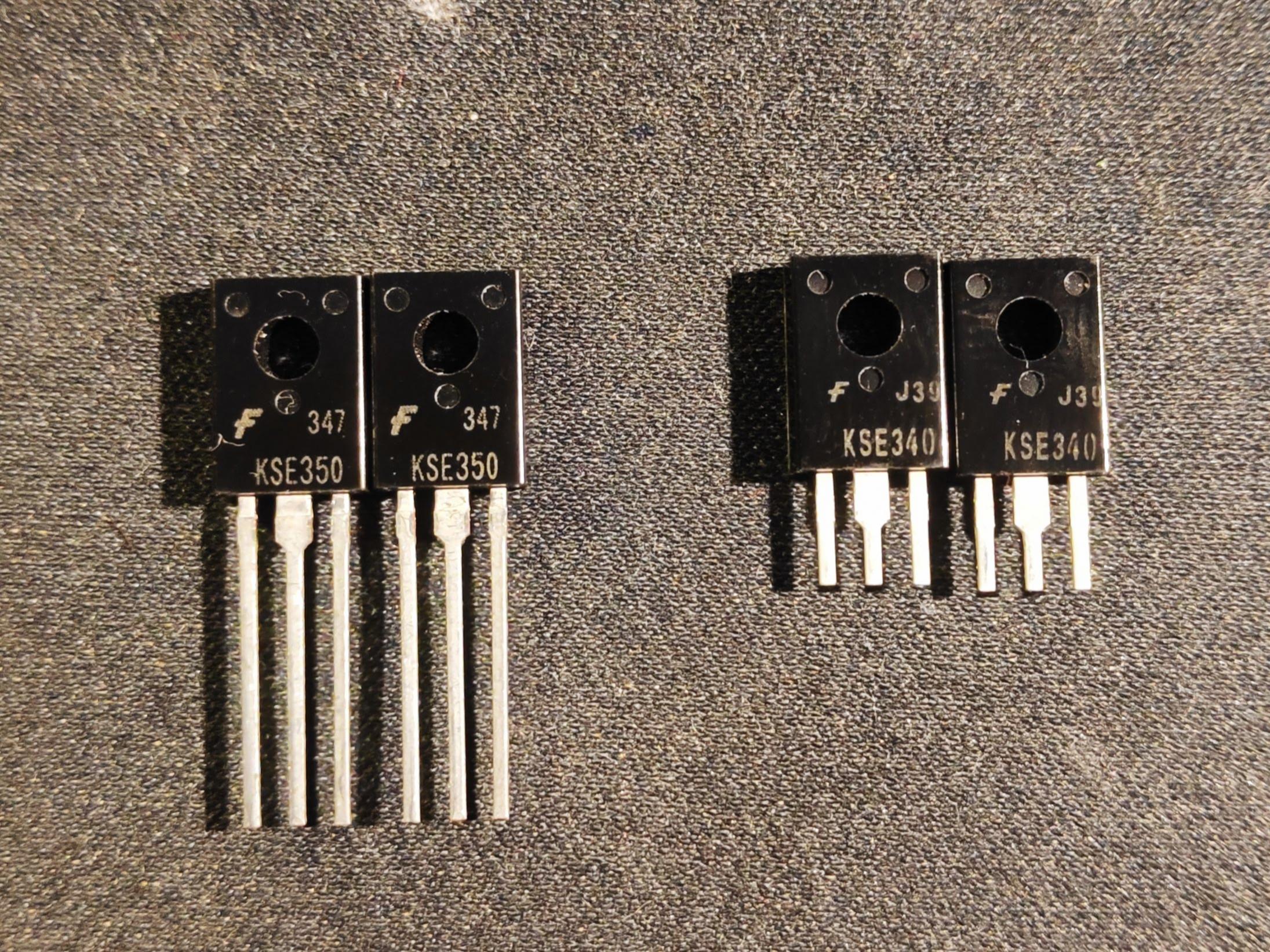

The 340s look fishy. So be careful. They dissipate about a watt each under load so you may be able to mount them on the front and cool them with small heatsinks.
But the 340s do give me a bad feeling. The legs look wrong somehow, apart from the fact that these are cut off already!

Hi Shaan,
I am using MJE340/350 instead, can I mount them in front with individual heatsinks too?
Will make my install easier.
Hi Bassivus
I have inspected 340s with magnifier and it is never installed and production short-legged for sure! Also it measures fine.
I have bought it from eBay but, reputable UK seller. I truly believe that this seller is legit.

Hi Shaan,
I think you can but please note that I have never used them mounted on front with their own heatsinks, so cannot guarantee thermal stability this way.
