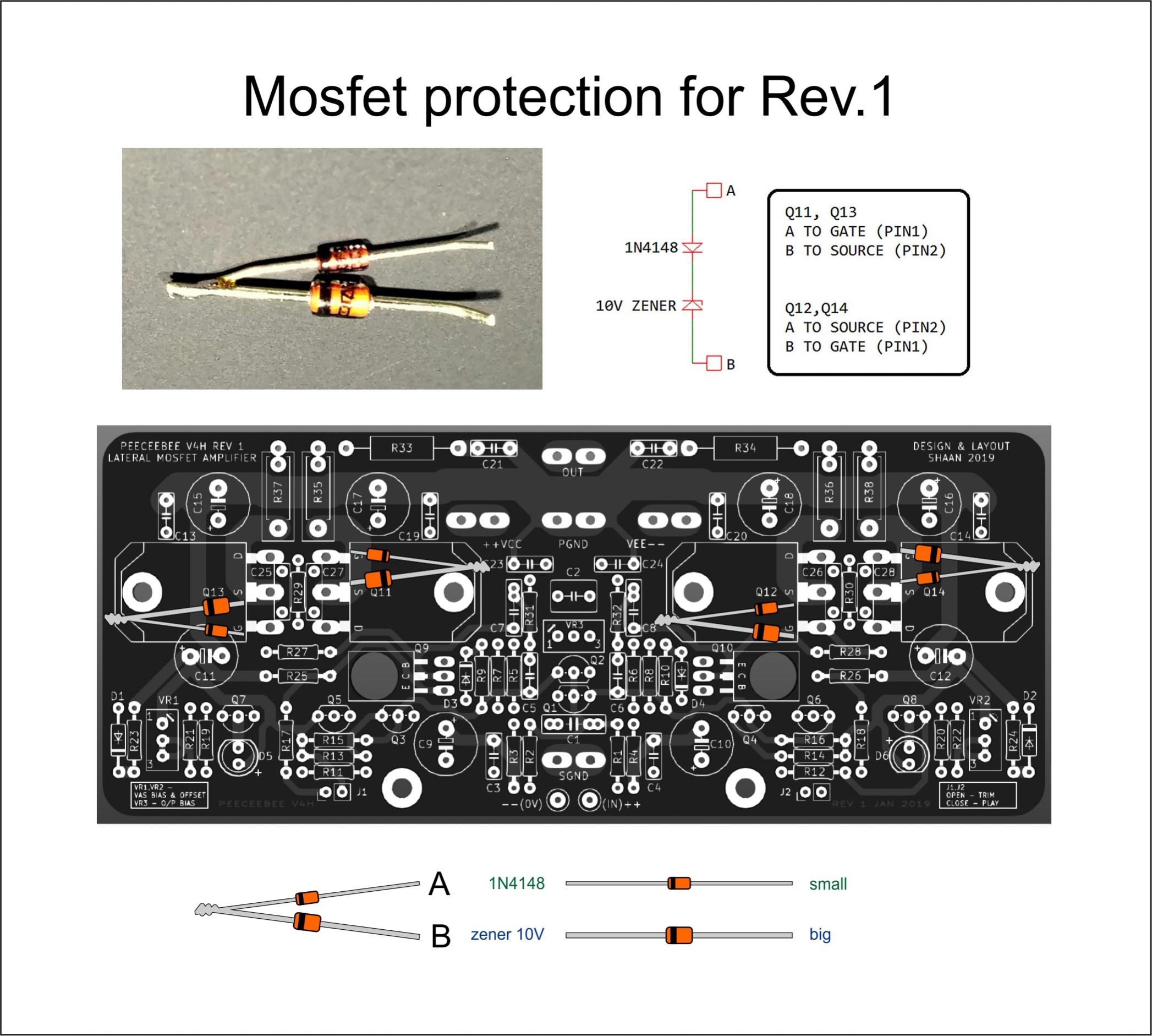

Here is a basic short circuit protection for the MOSFETs that will be implemented in the next revision of PCBs, shown in first attachment. You can install it right between the gate and source pins (pin 1 and pin 2) of each mosfet. Four networks needed per channel. You can easily make them the way shown in the second attachment. The diodes can stand vertically or lie down horizontally as per your convenience.
For Q11 and Q13, anode of 4148 (marked "A") goes to gate (pin1), and anode of zener (marked "B") goes to source (pin2). For Q12 and Q14, anode of 4148 goes to source (pin2), and anode of zener goes to gate (pin1). Cathodes of the two diodes are joined together in each network. Total diodes needed - 1N4148 x8 and 10V zener x8 for two channels. Typically half the number of diodes are used, but this way we bypass the gate resistors and have the protection right at individual mosfet gates.
It is not essential for normal operation of the amp but will save the mosfets in case of a short at the output happens.

OK, thanks a lot ........... but I have a question :
What actually happens in case a short on output actually happens - and lasts for some time before you realize what just happened (beside no sound in the speaker if connected) ?

In that case a high current will keep flowing through the mosfets heating the heatsink as hell, until the power supply rail fuses or the mosfets blow due to overheat. Hence power supply output rail fuses should not be more than 10A rated for a couple V4H channels.
This protection is in a sense basic, i.e. not elaborate ones like VI limiters which directly monitor output current. In the sustained fault condition stated above BJT output devices will commit suicide in seconds, and zener protection is useless for BJT output - VI limiting is must. In contrast, lateral's very high on resistance and very high Vgs to Id ratio (low transconductance) means it will not go into secondary breakdown like BJTs when a short sustains, and the Vgs value for 5A+ drain current is sufficiently high that we can use zener diodes to limit Vgs (hence Id) to a safe limit until other forms of failsafe mechanism triggers i.e. fuses blow, or power is turned off.
