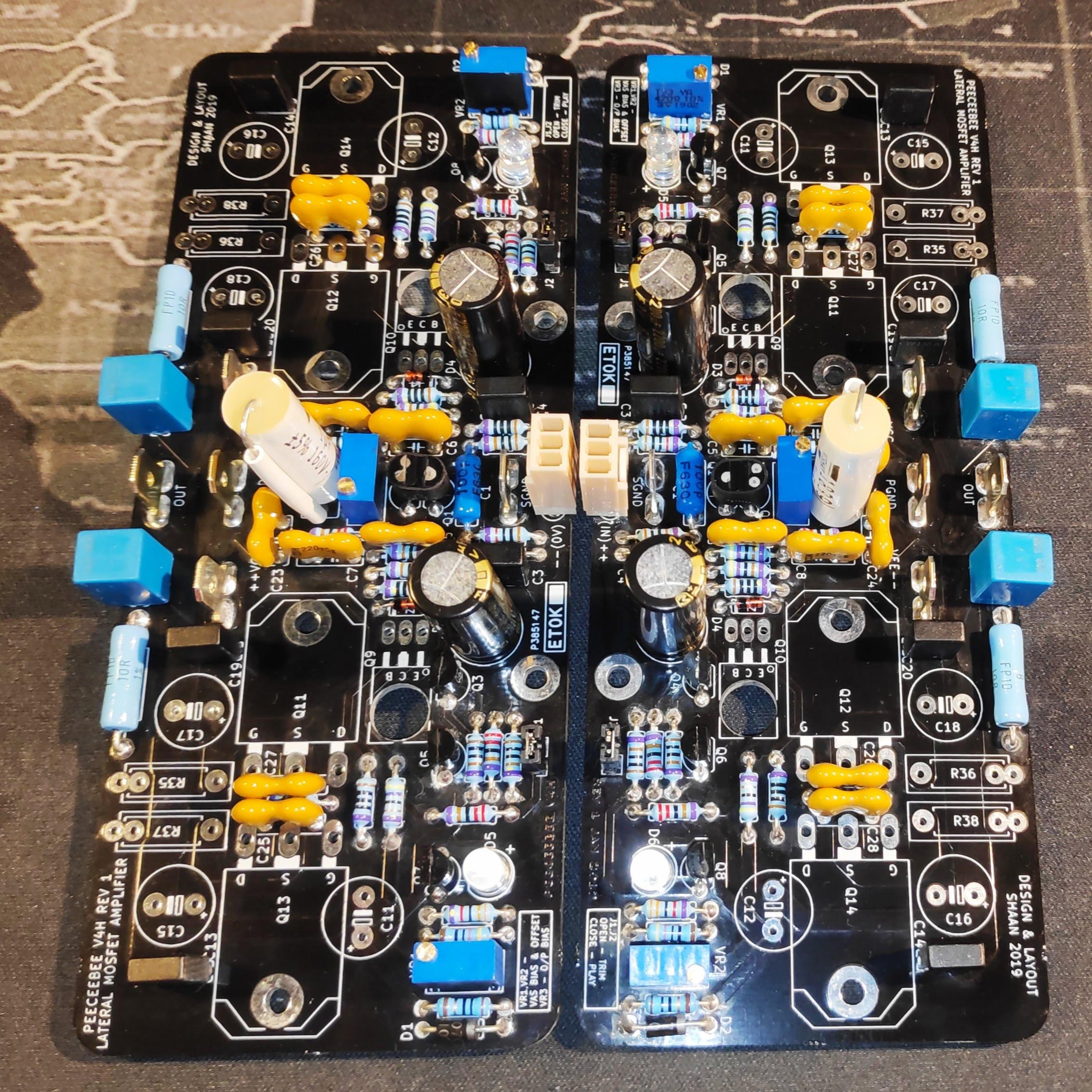

Looking nice!
Is the blue part near input the 100pF cap? Never seen one that looks like that! Film? Ceramic?
Thanks! I took some nice NOS parts from my parts bin
That blue ones are Philips Polypropylene Film Foil Capacitor 100pF 630V 1% (not polystyrene) Also used some black Wima PPS foil caps on 100nF

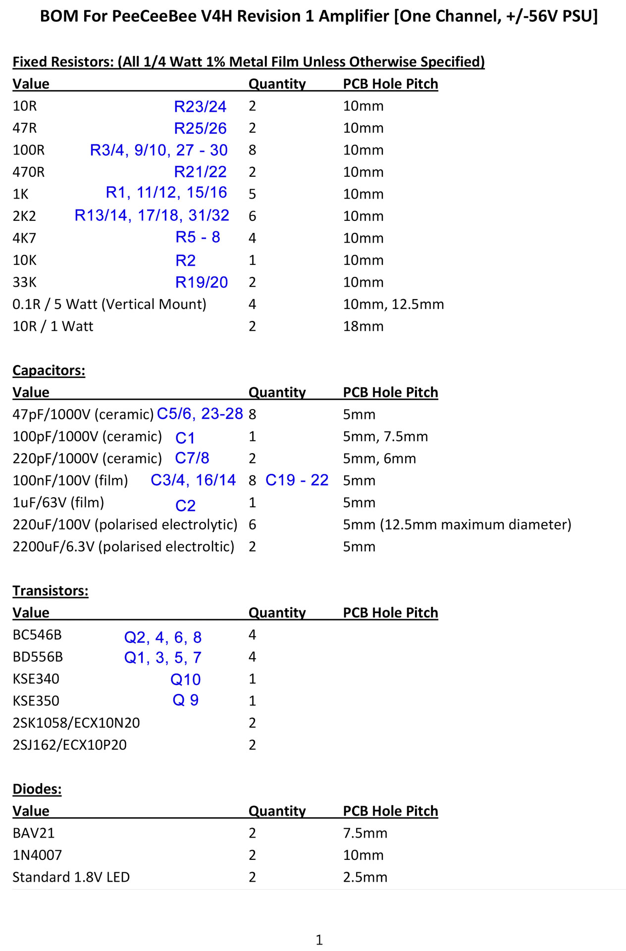

I'll attach my position number list that I have made for convenience. Might come in handy for future builders

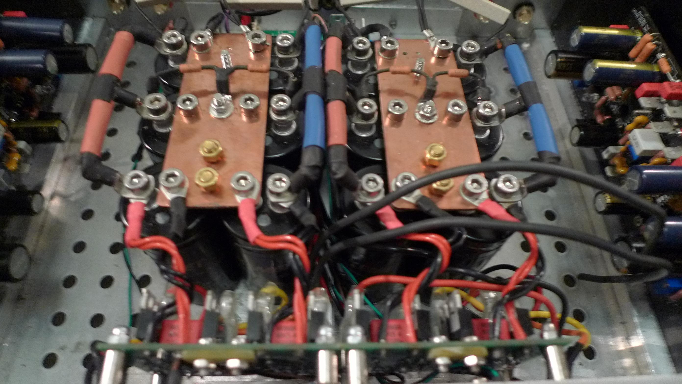

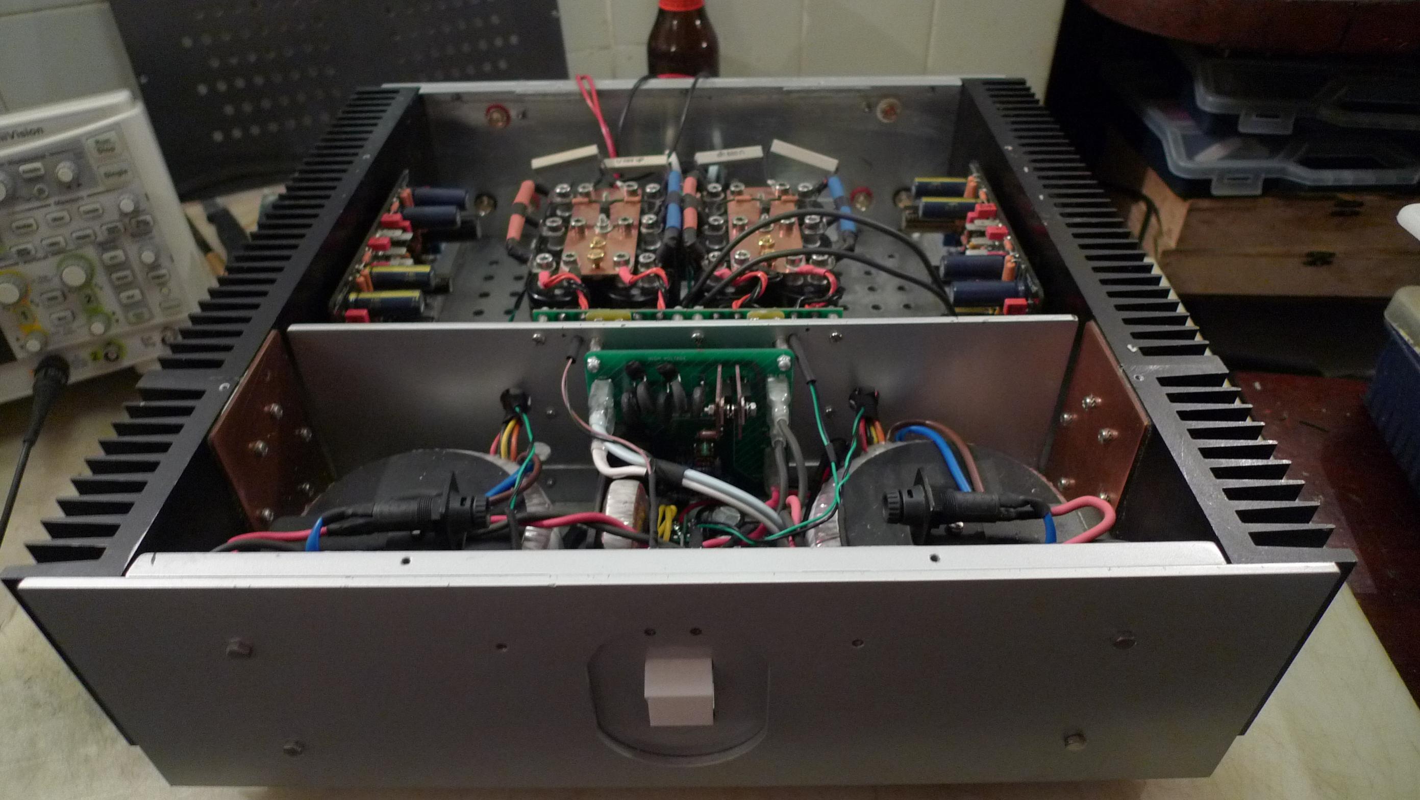

It's my first amp build . Soft start and speaker protection both SSR are tested and working , going on with the mosfet fever i've made a four LT4320 bridges power supply . I'm getting 52v from a 35v toroid with 600R each rail - 65mv ripple pp made directly with the ground clip , looks very clean and quiet.
The question is . Speaker and power supply ground are going on the first 2 caps ? power supply wires have to be twisted , 10CM ( i have the white and grey 5mm flat wire seen on power supply but i can,t twist it)
It's not a CRC only a capacitor bank 6 X10.000 uf.

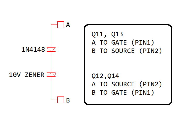

Here is a basic short circuit protection for the MOSFETs that will be implemented in the next revision of PCBs, shown in first attachment. You can install it right between the gate and source pins (pin 1 and pin 2) of each mosfet. Four networks needed per channel. You can easily make them the way shown in the second attachment. The diodes can stand vertically or lie down horizontally as per your convenience.
For Q11 and Q13, anode of 4148 (marked "A") goes to gate (pin1), and anode of zener (marked "B") goes to source (pin2). For Q12 and Q14, anode of 4148 goes to source (pin2), and anode of zener goes to gate (pin1). Cathodes of the two diodes are joined together in each network. Total diodes needed - 1N4148 x8 and 10V zener x8 for two channels. Typically half the number of diodes are used, but this way we bypass the gate resistors and have the protection right at individual mosfet gates.
It is not essential for normal operation of the amp but will save the mosfets in case of a short at the output happens.

Thanks Shaan for the new added protection .
