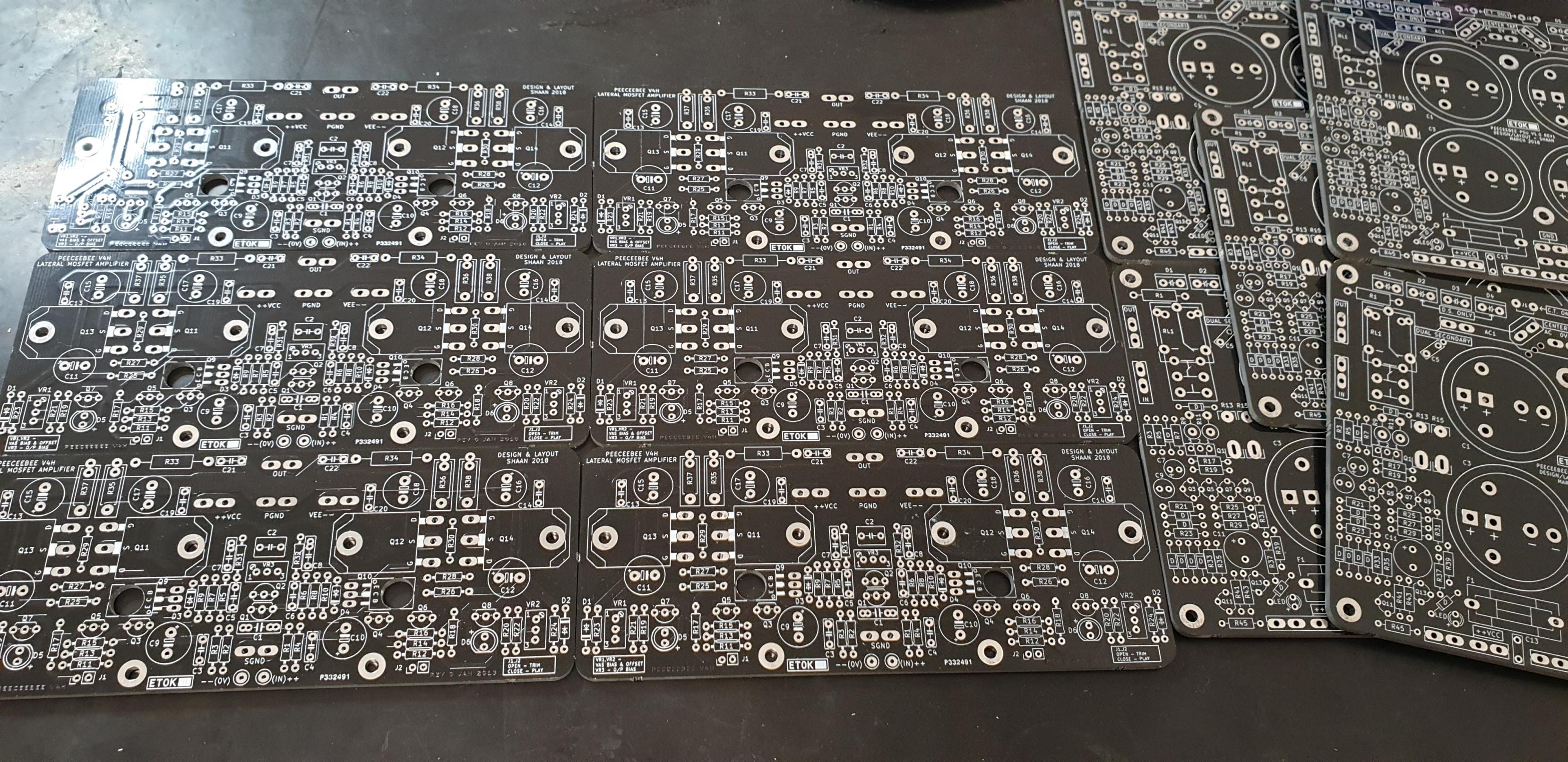

Happy to report that I received my PCB's last week.

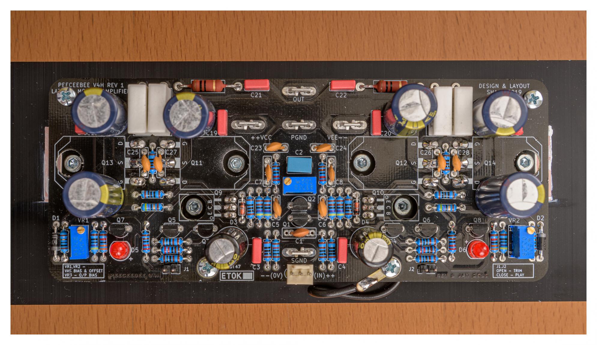

Today I started populating the first channel of the V4H Rev 1.
When I finished populating the parts I got confused. There where a bunch of components I hadn't used and I thought I forgot to order some 220 and 330 ohms resisters.
The reason why I got confused is due to the fact the the setup guide hasn't been updated to reflect the revision 1 changes. I just mention this so that new builders don't make the same mistakes.
Maybe it is a good idea to update the setup guide?

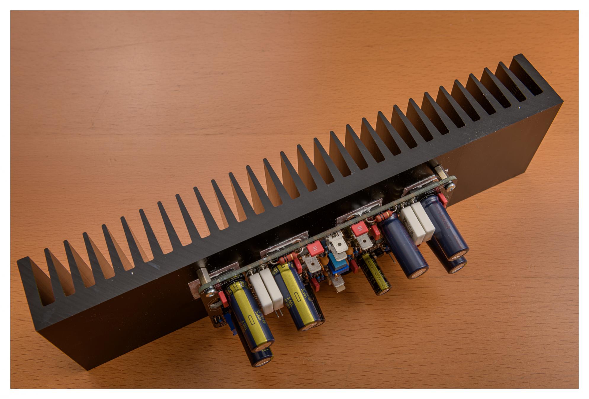

I have a question in regards to mounting the mosfets:
From what I understood, the documentation suggests to mount the mosfets against the PCB (bottom side) and fix them to the heatsink by means of the screws from the top side of the PCB. The mosfets are sandwiched between the PCB and the heatsink.
I'm a little bit concerned about this mounting method since the mosfets will also be heating the PCB even though they are mounted against a headsink.
What about long term reliability?
Has anyone measured the temperature on the top side of the PCB while putting the amp under moderate load?
I'm toying with the idea of mounting the mosfets 5mm away from the bottom side of the PCB. I could do that in two ways:
1. use 5 mm spacers to fix the mosfets to the headsink. Downside of this method is servicability; I would need to desolder all mosfets in case of a mosfet failure.
2. Drill two additional 3mm holes on the top sides of the PCB (where the text is). Use those and the holes at the bottom to fix the PCB to the headsink by means of four 10mm standoffs. I would also enlarge the four holes for the mosfets in the PCB so that I can reach the screws to fix the mosfets with a screwdriver "through" the PCB (hope this makes sense).
I'm interested in any thoughts and experiences you guys have.

You are right. R27,28,29,30 are replaced by 100R in Rev1. Also the new 47pF caps are not indicated. I will update it shortly. Thanks for pointing it out.

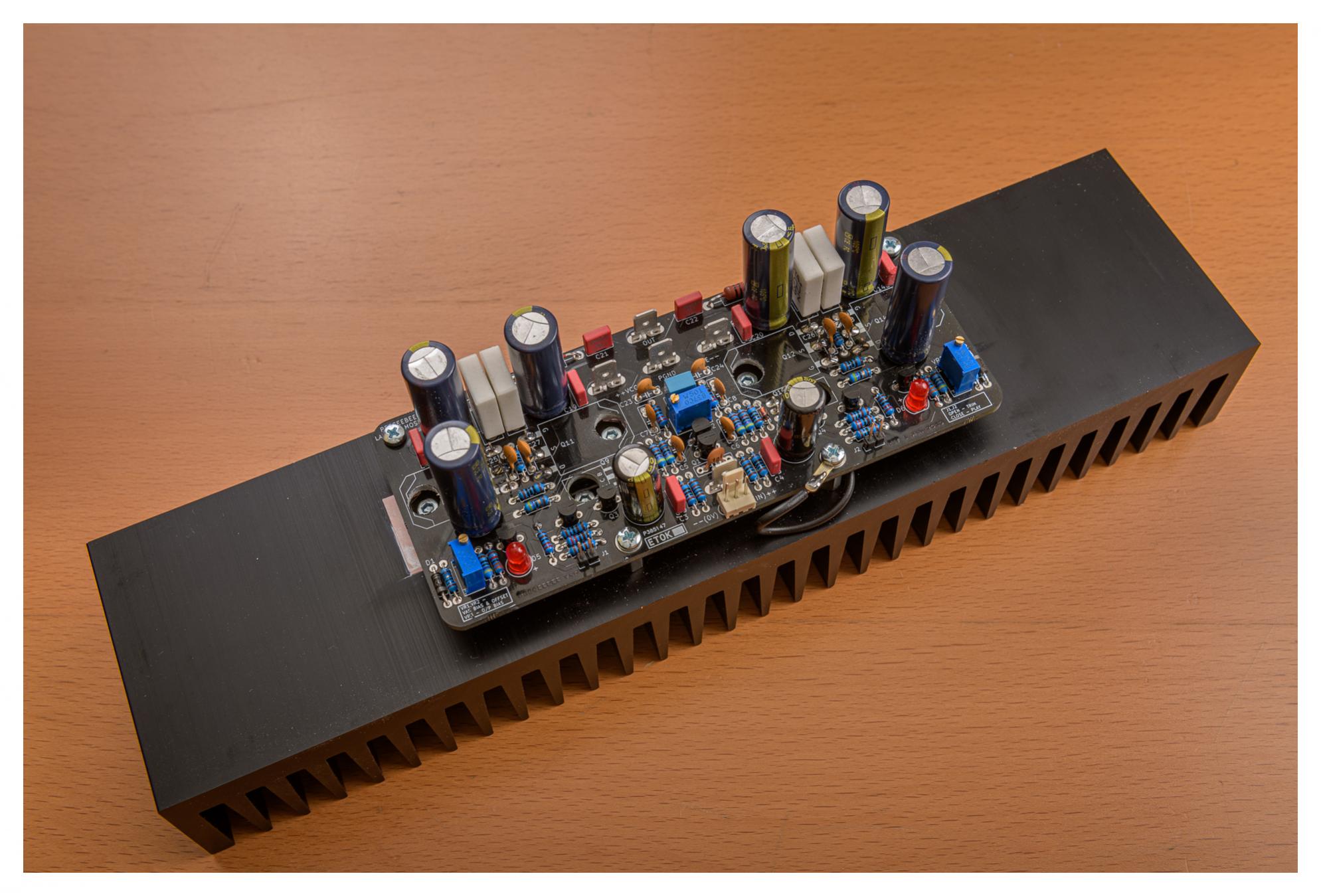

First channel finished. I now need some patience and wait for my power supplies to arrive. I'll be using two SMPS600RXE's; I'll be building two monoblocks.
I finally went for the second mounting option (post #814). I drilled two additional mounting holes on top of the PCB. And I enlarged the holes of the mosfet mounting to 8mm. I used 4 metal standoffs to mount the PCB to the heatsink. This provides 5mm of free space between the mosfets and the PCB.
This setup gives me better easy of mind 🙂
I also added a ground wire to ground the heatsink.
Pictures attached.
Pictures attached.
