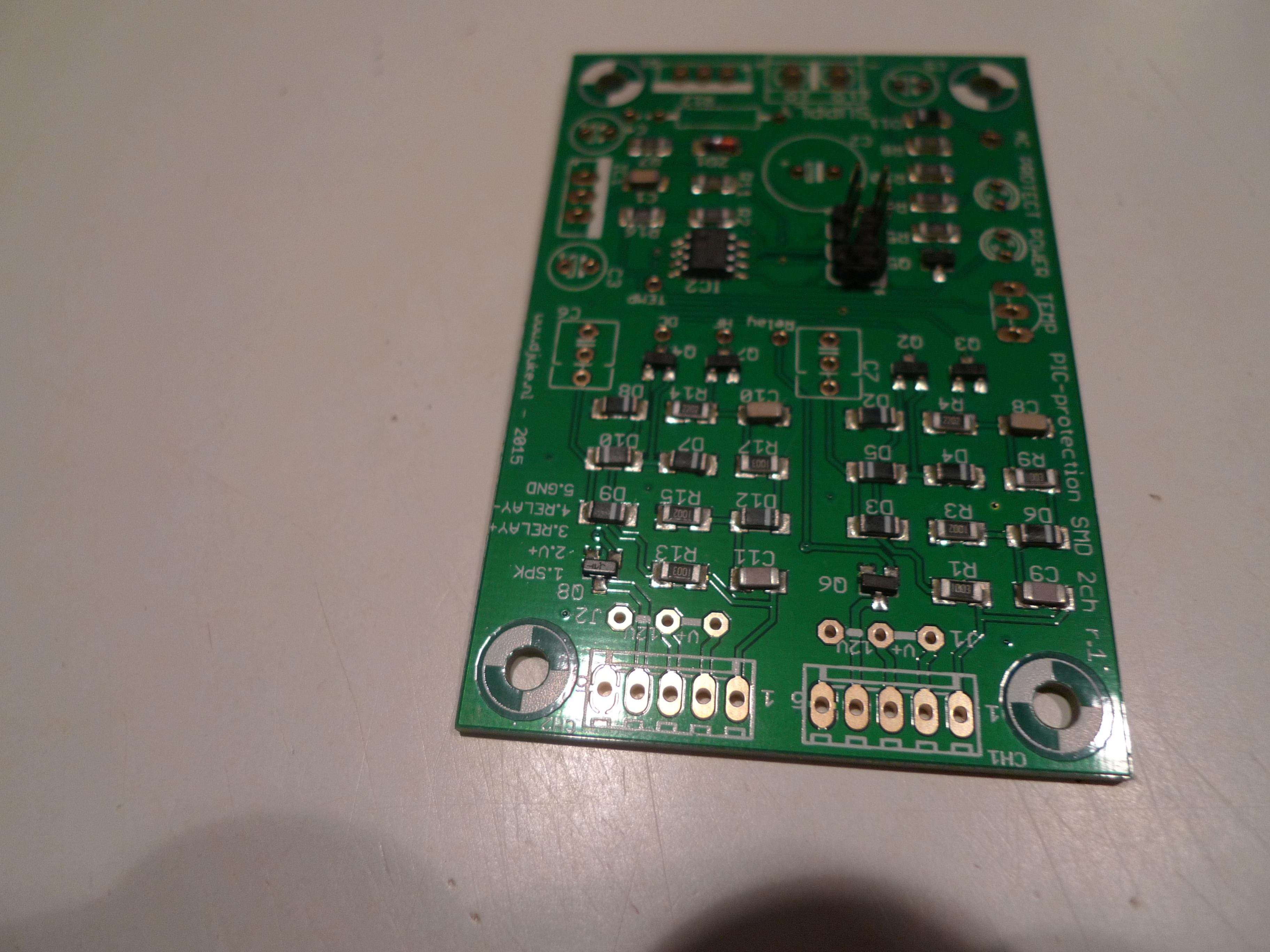

Speaker protection
I just bought
PIC-based Speaker Protection
The board is very nice made half with smd and cost 35€ with shipping .Can be powered from rails or independent supply . Protect dc, hf inestability and temperature .
