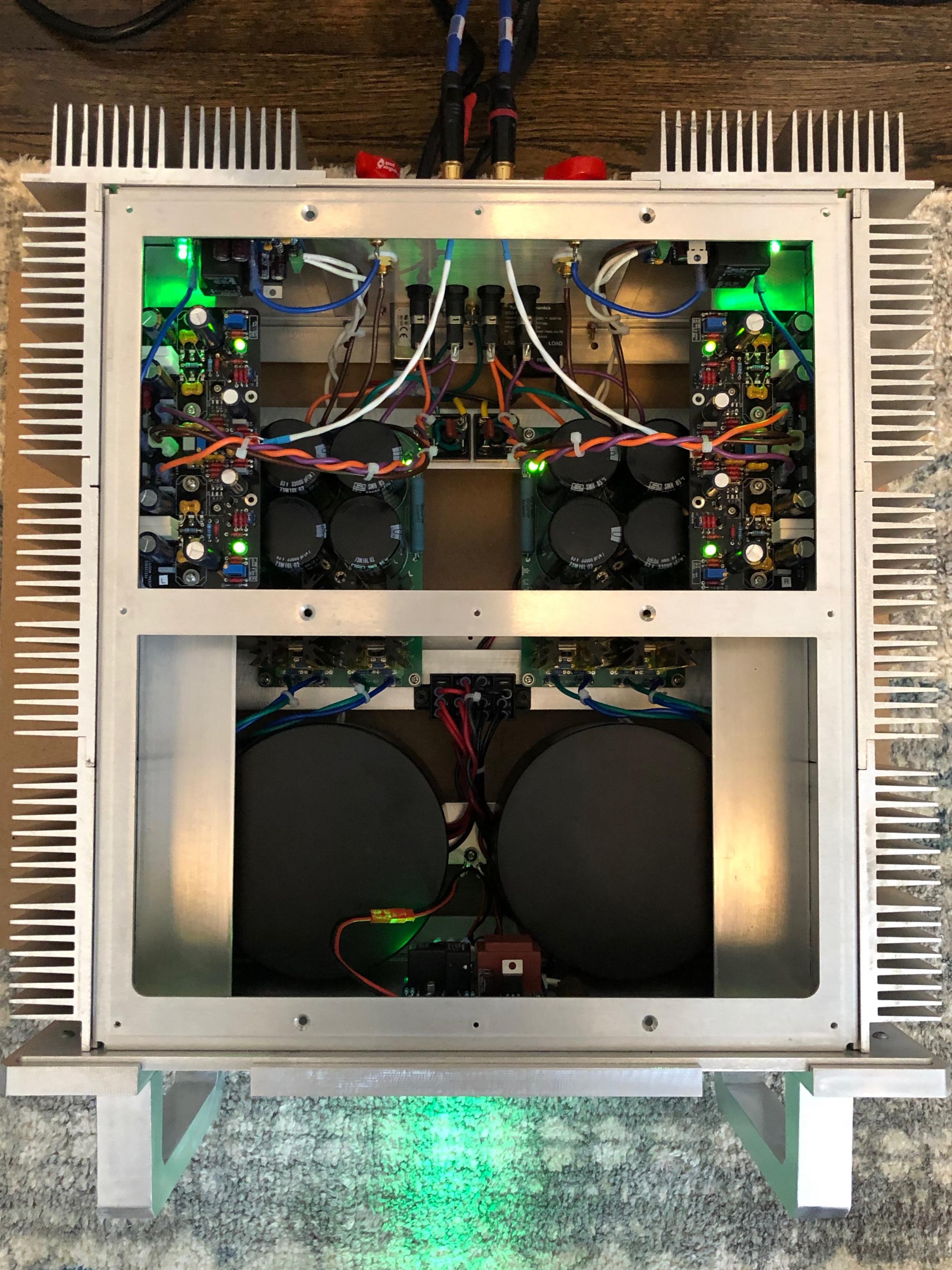

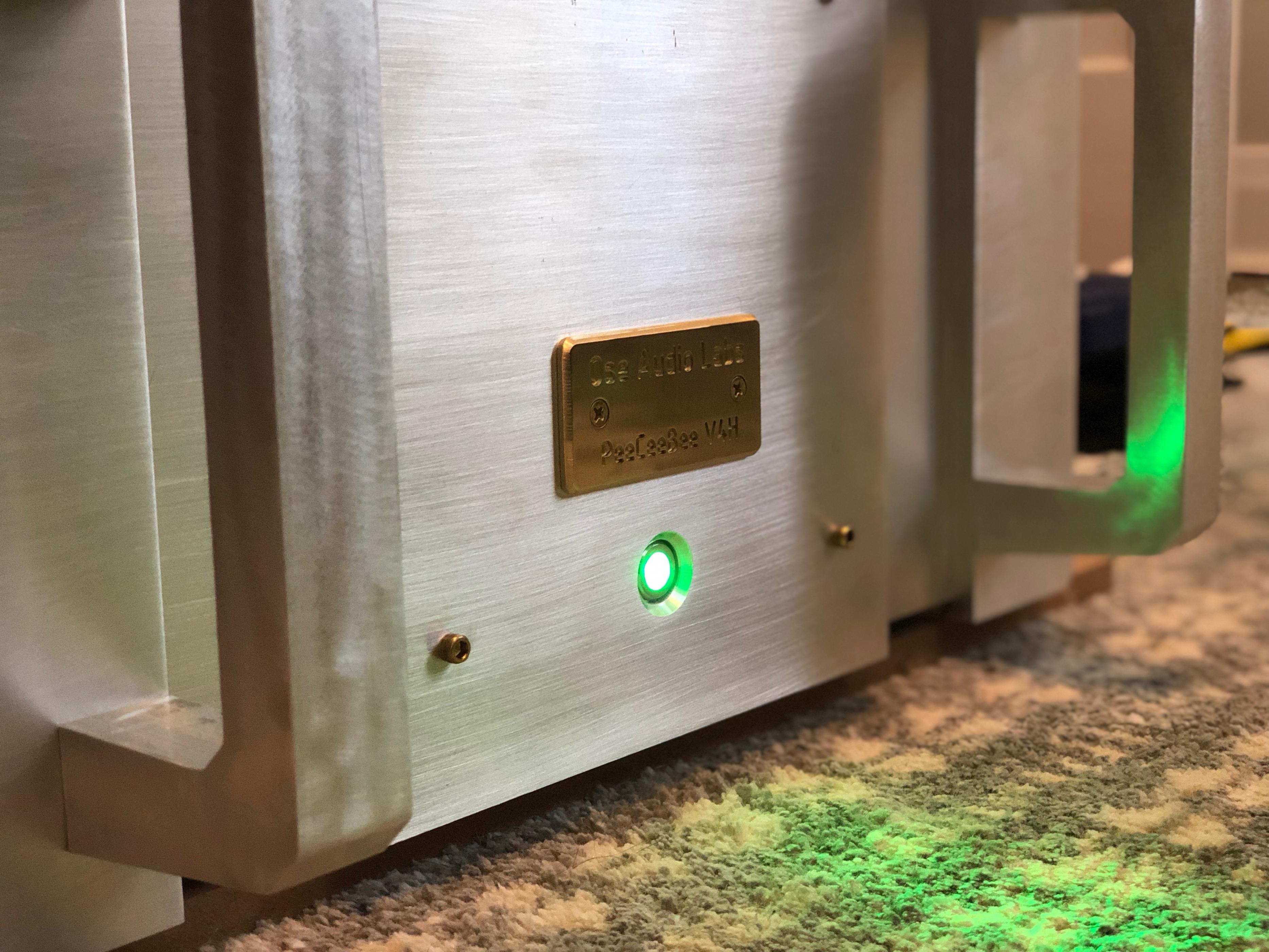

Time for an update from my original post in February (https://www.diyaudio.com/forums/group-buys/317151-peeceebee-v4h-gb-72.html#post5691617). 2 months into daily listening and I haven't run into any stability issues and the V4H has continued to occupy my number 1 spot in my listening setup! Again, thank you for such a great amp Shaan!

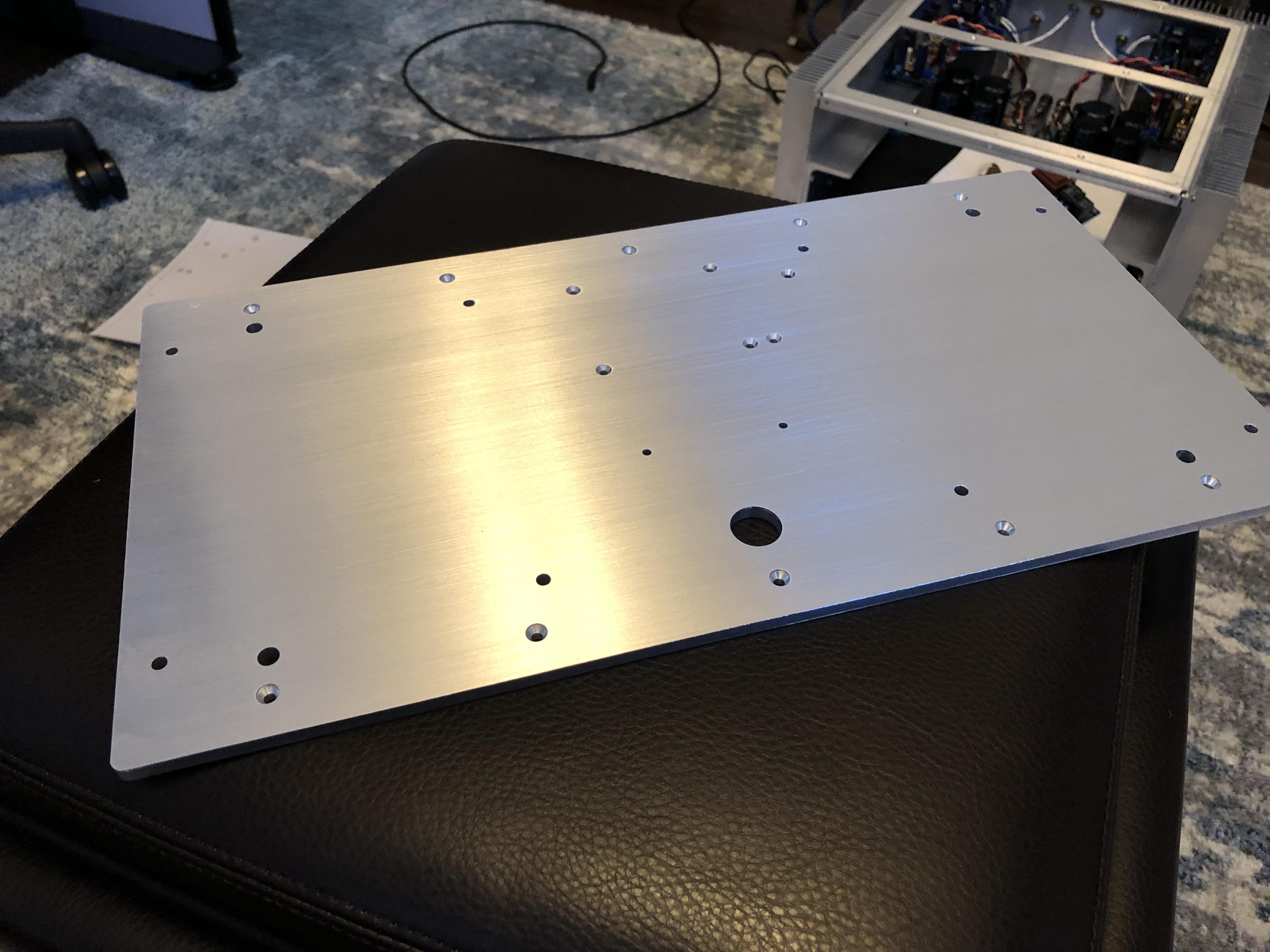

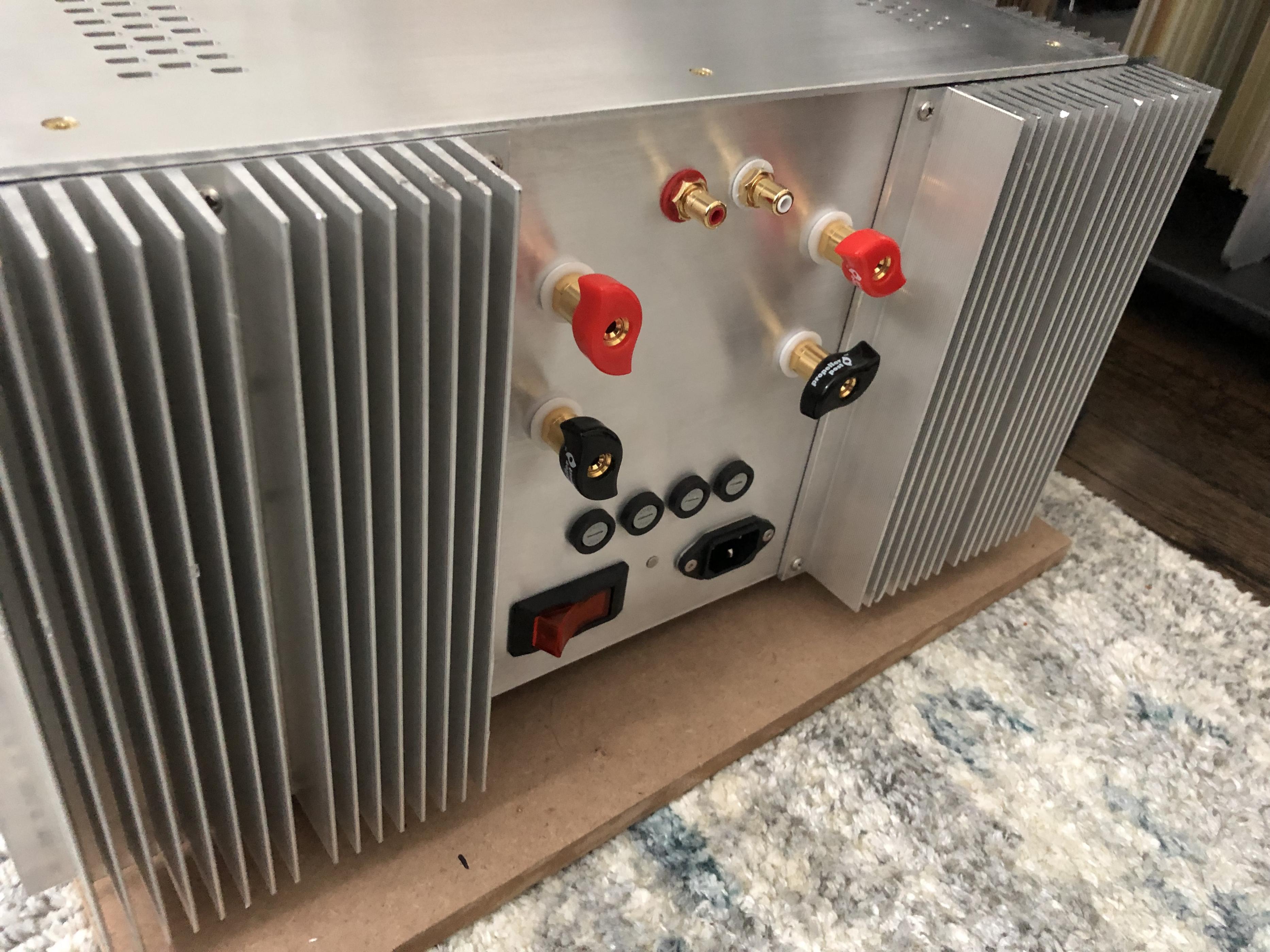

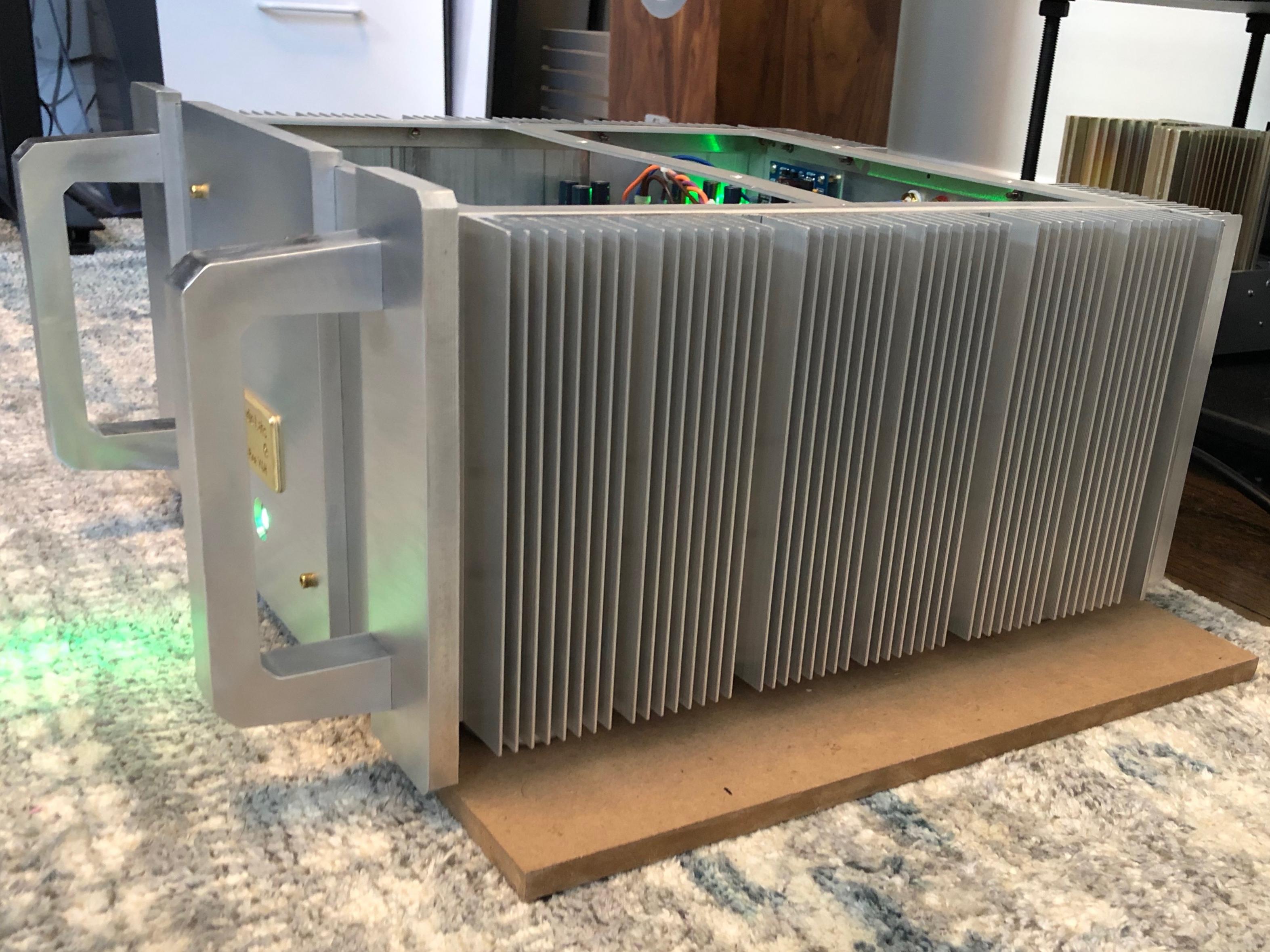

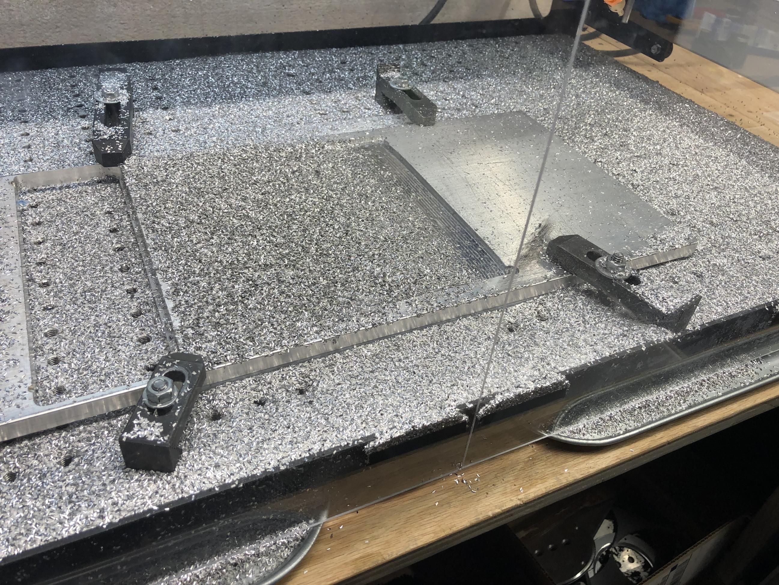

I've also now completed the work on the front panel and handles for my V4H chassis and wanted to share some glamour shots. The front panel is made up of a 1/4" 6061 base plate which is used to mount the softstart and resistor and mount the front to the inner frame. To hide those screws, I milled out 3x 1/2" plates that are tapped from the rear. Then brass hardware and an engraved nameplate was added. The handles were milled out of 1" 6061 (quite a challenge on my hobby desktop CNC), tapped, and bolted on from the inside.
Only thing left to cut are the top and bottom covers and then move it to its spot on the shelf!
Hi G,
Fantastic V4H amplifier build!!
Your chassis work makes me envious, great job.
Enjoy your new baby, as you already know, it sounds excellent 😀

Awesome! I couldn't be happier to know the v4h topped for you! Happy listening.
And that frontplate is a looker! 😀

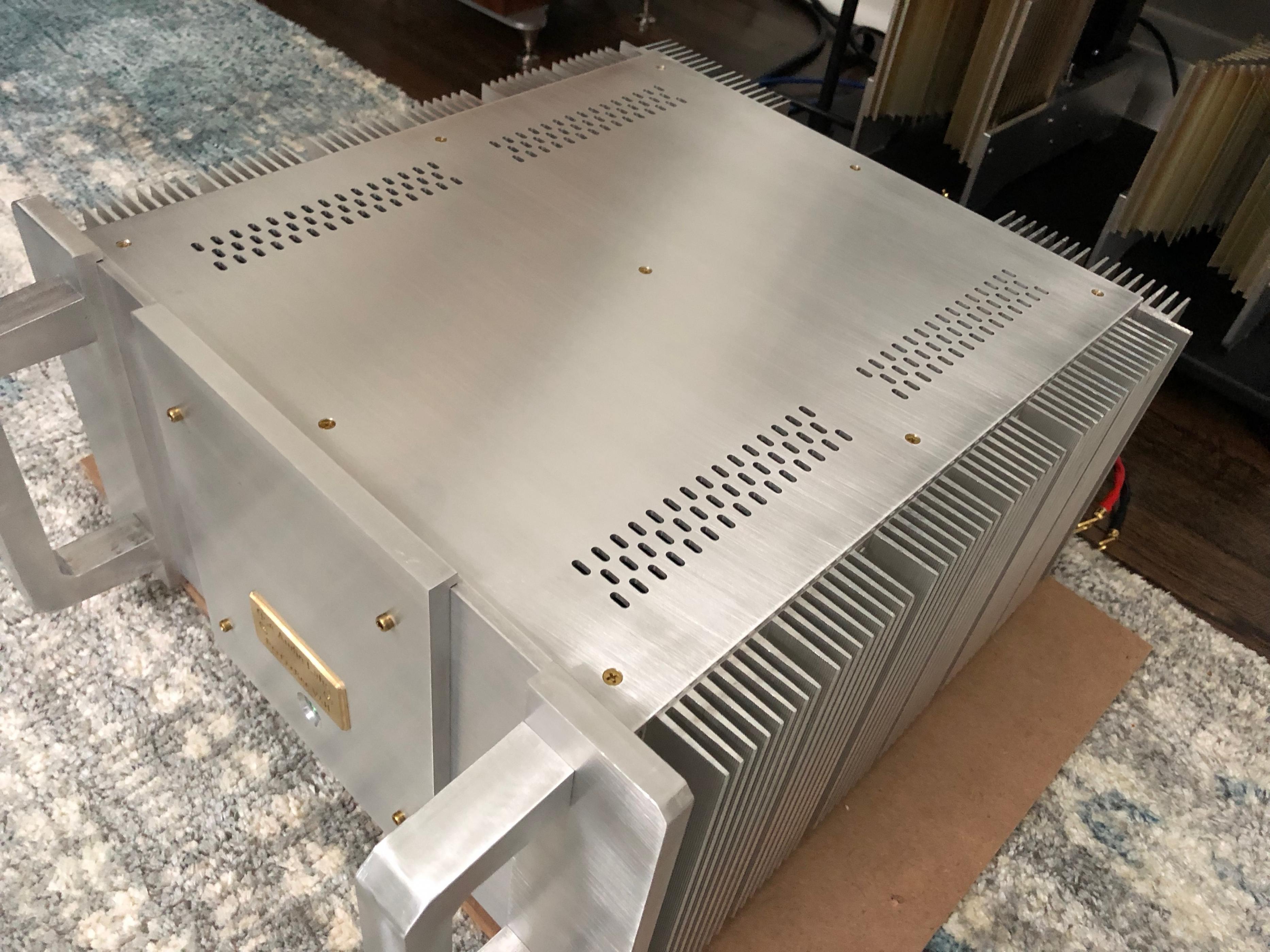

Thanks all for your kind comments! I just finished up the top and bottom panels and finally have it on the shelf 😀

... (quite a challenge on my hobby desktop CNC)...
Excellent work!
What kind of CNC desktop machine do you have?
I have been playing with the idea of buying one too.

It is a Shapeoko 3 XL with a bunch of upgrades, 1.5kW water cooled spindle, reinforced Z-axis, etc. Some details from a few years ago are at My 1.5kW water cooled SO3 XL - Shapeoko - Carbide 3D Community Site.
