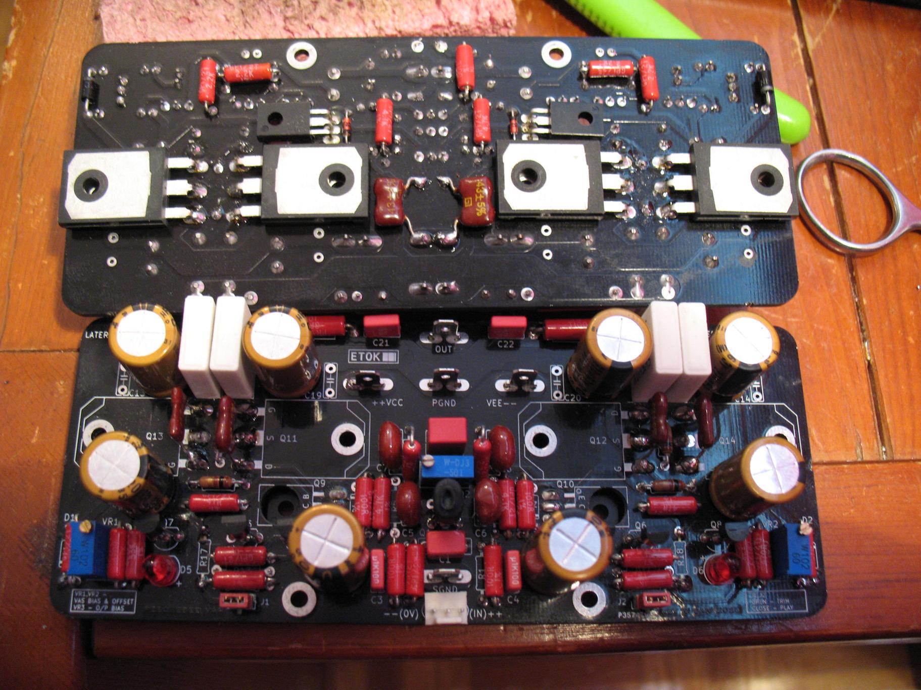

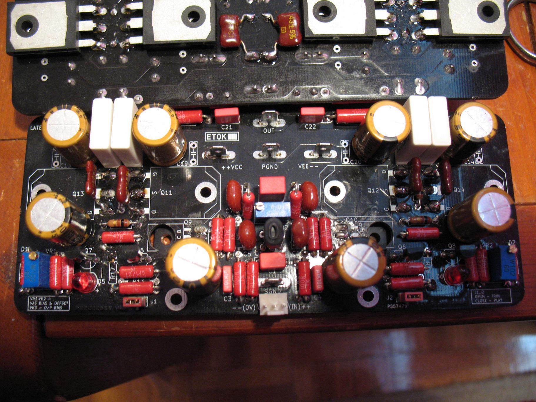

Last Friday I received the 100R replacement resistors, I managed to replace the 330r and 220R without damaging the PC boards.🙂
I added the 6Pc silvered mica capacitors, I need to clean the PC boards (I do not want to use Acetone it will remove the solder mask finish and mess up the boards) and ready for power up. The 70% of alcohol I got does not work.
I think I will use some old heatsink I used for testing to power up and after I do some listening tests I will purchase a decent amplifier enclosure.
I see some people built some nice looking amp and based on the feedback this amp deserves a decent enclosure. Slowly I will get there.
Some parts are mounted at the bottom if you see missing from the top of the PC boards.
