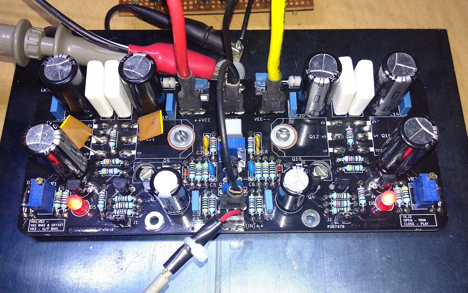

I found it to be strange that the voltage across R25 is 0 volts and the voltage across one of the 1 ohm resisters is only 0,004 volts.
I'm guessing that is not normal?
Yes this is normal.
Depending on hFE of the bjts, sometimes vr1/2 need to be turned to start current flow in the vas.
Yes this is normal.
Okay, went ahead and continued the setup.
As you mentioned, all is working fine. The amp let it adjust itself as described in the setup guide. I finished the adjustments and will continue with the tests tomorrow. But it is looking promising.

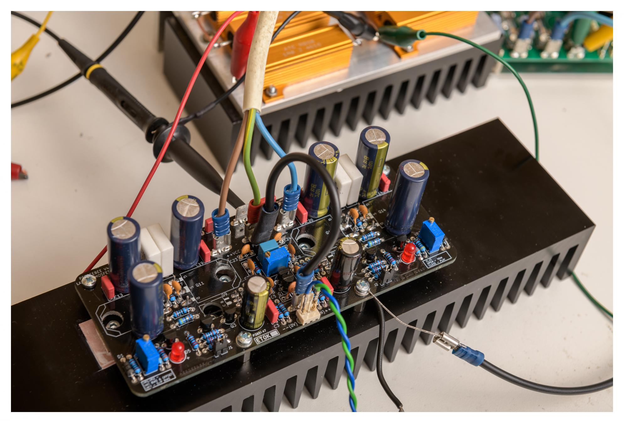

During the mosfet bias adjustment, I left a second voltmeter connected to R26. I noticed that the VAS bias is slowly rising too during the 10 - 15 min settle time. After 15 min. the mosfet bias was about 275 mA. The voltage over R26 was about 460 mV. But I suppose that is normal?
I continued with the testing after I had setup the amp yesterday.
First thing I did was to remove the 1 ohms / 2 watt resistors from the power supply rails. I then connected a test speaker (4 ohms) to the amp and switched it on. There was some loud noise coming from the speaker so I switched off the amp immediately.

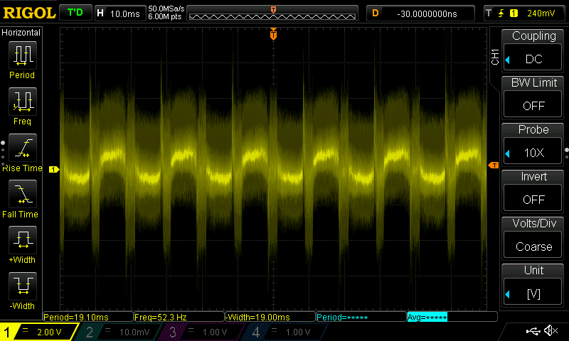

Removed the test speaker and connected the oscilloscope without any load.

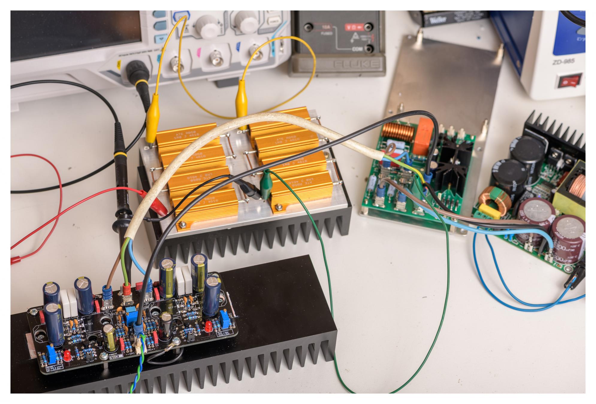

The amp is clearly oscillating - see attached trace. The oscillating gets far worse when connecting a load (4 or 8 ohms doesn't matter). So much worse that my 600 watts smps goes into protection mode when connecting an 8 ohms dummy load.
Any ideas?

Is the heatsink properly connected to PSU ground?
Is the problem happening with inputs open or input connected?
Can you upload a couple pictures of the setup?

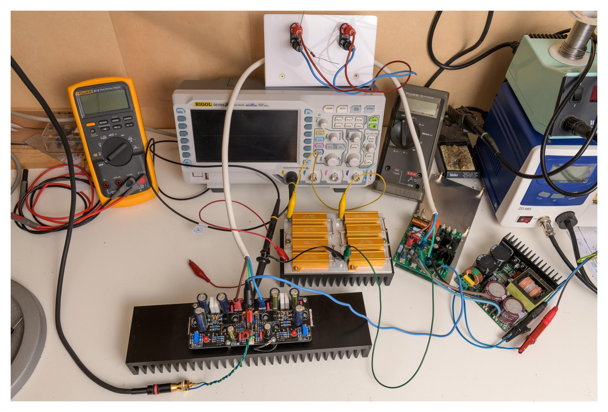

Here is an overview of the setup on my test bench.
From right to left we have:
* The SMPS600ReE power supply. It is a dual 55 volts supply.
* Amp protection board: at present I only use the part of the power supply. It holds the rail fuses (8A) and two bleeder resistors.
* Power supply leads / board: the DC rails are transported from the protection pcb to the amp through this "junction box". You'll notice 4 terminal blocks. I either use this to connect the two 1 ohms resistors in series with the rails (during setup) of bypass the resistors (after setup).
* PeeCeeBee amp on its headsink. Notice the black wire who connects the heatsink with the ground of the supply.
Both GND's are connected to the power supply GND though a separate wire.
Hope this all clear; otherwise just ask if you want more details or clarification.

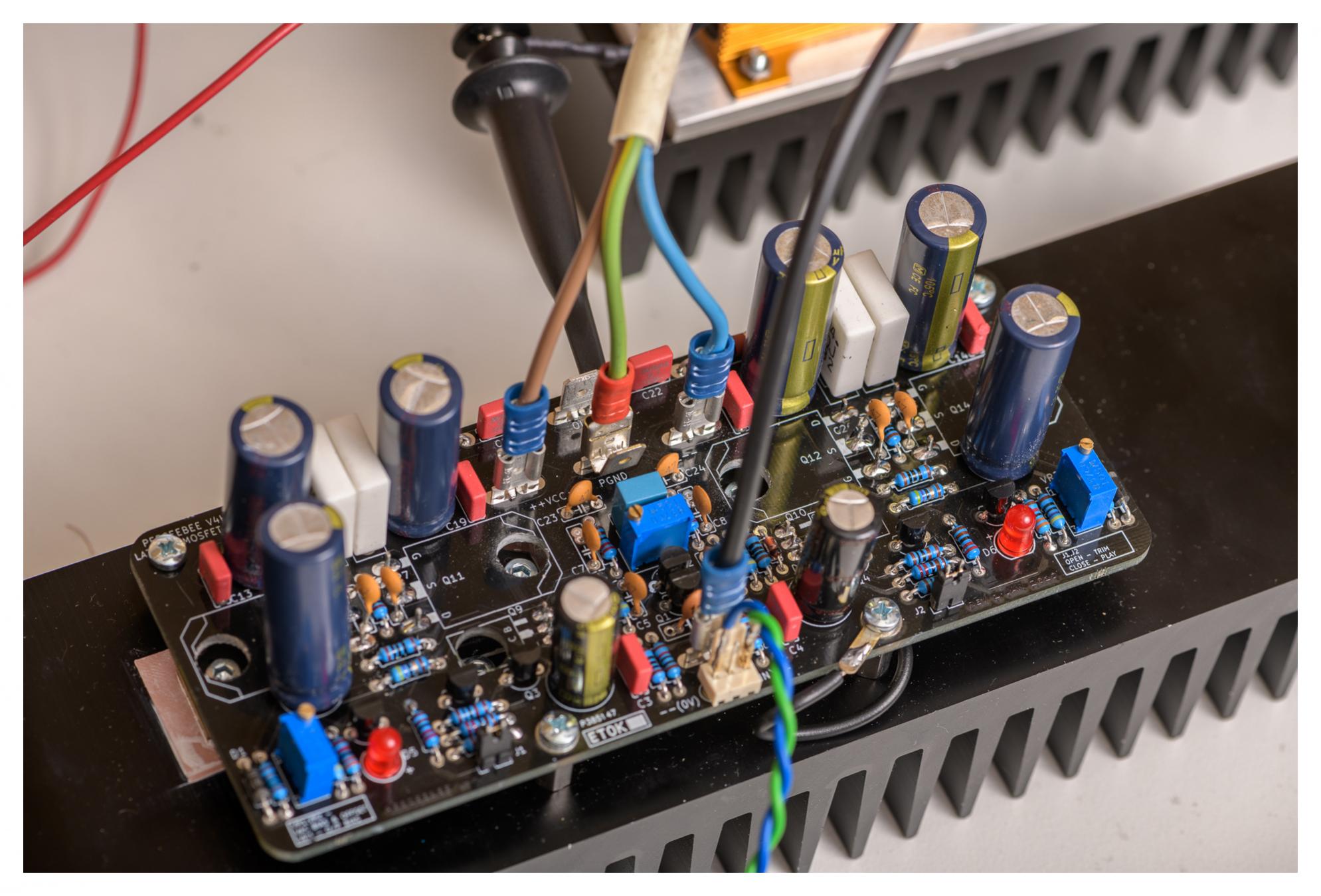

And two more close-up pics.
In the mean time I remove the "junction box" out of the equation. The power supply leads are now running from the protection pcb straight to the amp (with shorter wires). The amp is still behaving the same way (oscillation).
I'm out of ideas.

Are the speakers Gr. connected to the Power Gr? See the picture
Yes, both PGND and SGND are connected to power supply GND by means of separate wires all the way to the power supply. I retain a star connection this way.
I can't connect real speakers at this time due to the oscillation. Connecting the dummy load increases the oscillation quite heavily. My smps is even going into protection mode when connecting a load.

Which point underboard is the black heatsink cable connected to?

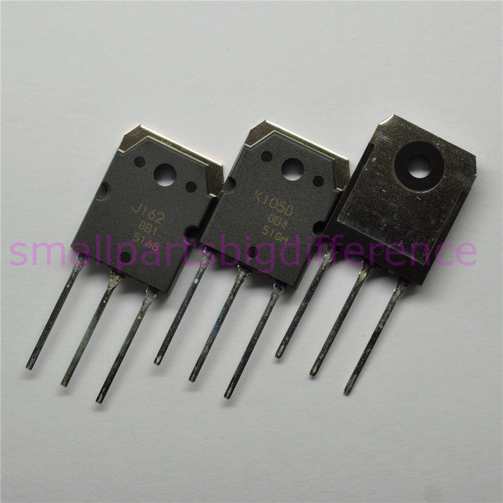

What MOSFETs are you using? Are these genuine?
What is the voltage rating of the pF capacitors?
To the SGND connector.
I hope so; you have shipped them to me 🙂

Try disconnecting the cable from the heatsink. Use a separate cable and connect the heatsink directly to PSU ground.

Ok. Yes these are genuine.
What VAS and small signal transistors are you using?

As no external influence affect the oscillation in your case it is an onboard problem, which can be as simple as a loose solder joint or a faulty component. If changing the heatsink cable as suggested doesn't solve the problem then remove the board from the heatsink and carefully inspect the solder joints and test all the BJTs between base-emitter and base-collector.
It's strange because the board set-up readings were normal, and with oscillation the reading should have gone haywire. We'll get the problem sorted soon.
Okay, that did the trick. The oscillation is gone and I can connect the dummy load and the amp behaves nice.
Ran a 1kHz sin trough it and the amplifier behaves normal.
Connected a test speaker and played some music. The amplifier appears functional.
During various tests I changed the GND wiring as following: power supply GND to PGND and then bridge that to SGND (see attached picture).
Is this what you would suggest to use as final wiring or would you run seperate GND wires to PGND and SGND?
As to your question in regards to the transistors I used: I used the transistors as mentioned in the setup guide.
Anyway, thanks for your patience with me. I thought it was a smart move to connect the heatsink to SGND on the PCB...
Great that it worked for you.As to your question in regards to the transistors I used: I used the transistors as mentioned in the setup guide.
I guess the question really reads "where did you source the transistors?"
There are alot of fakes around.
Oh, I misread that. Yes I know, lots of fakes out there.
But I always buy from trusted resources, never buy from ebay or the likes.
Although that is not always a guarantee but I'm quite confident these are genuine. I bought from Conrad.

In case anyone wonders, here is why it oscillates if SGND is connected to heatsink:
The back of the MOSFTEs are directly connected to output terminal. With the insulator between their metal back and heatsink body, each mosfet creates a very small capacitor between output and heatsink. If the heatsink is left floating i.e. not connected to ground then its body starts acting like an RF radiator and any tiny output noise of sufficiently high frequency is loaded to this radiator via those very small capacitors. The radiated RF is caught by the input and oscillation occurs. Solution is simple - short the antenna i.e. the heatsink to ground. Now, SGND is also ground. So why does connecting the heatsink to this terminal still cause oscillation?
Any length of conductor has some impedance. When the heatsink is connected to the ground via any cable a tiny high frequency noise current flows between output and ground via the aforementioned capacitors. This current creates a tiny noise voltage along the length of the cable due to its impedance; with highest value at the heatsink and zero at PSU ground. If dedicated cable is used for heatsink then this noise voltages does absolutely no harm. But when the heatsink is connected to SGND, and SGND is connected to ground via a cable, at SGND terminal that noise voltage appears at its highest value (only a microvolt or less at the moment of power-on). Now, SGND is connected to input bases via R2 and via this resistor this noise voltage is seen by the input section as a signal to be amplified, and it does just that, presenting the exact noise voltage to the output. The output sends it again back to SGND (now amplified 23 times) and SGND feeds it again to input for amplification. The cycle continues and we have oscillation.
