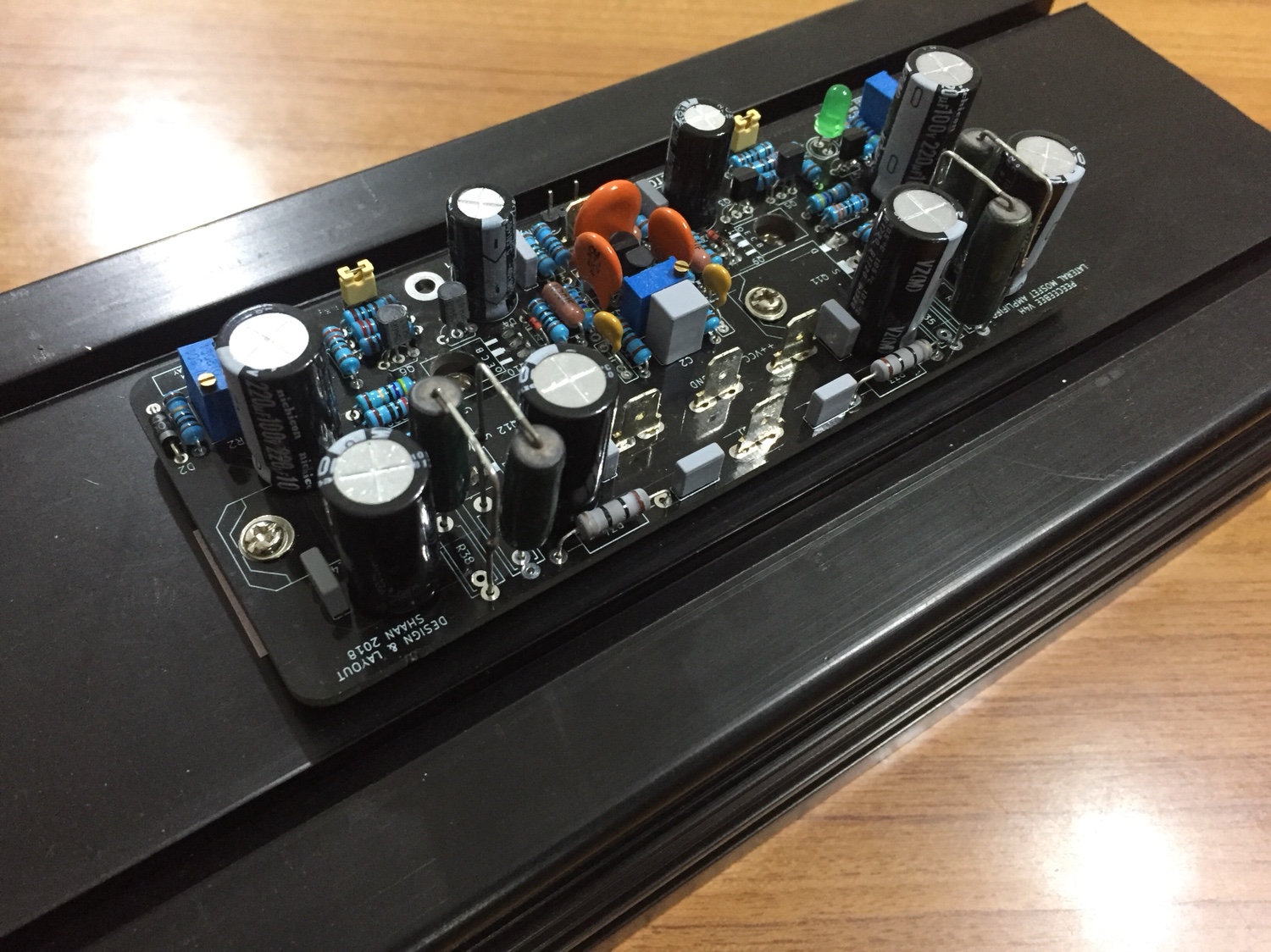

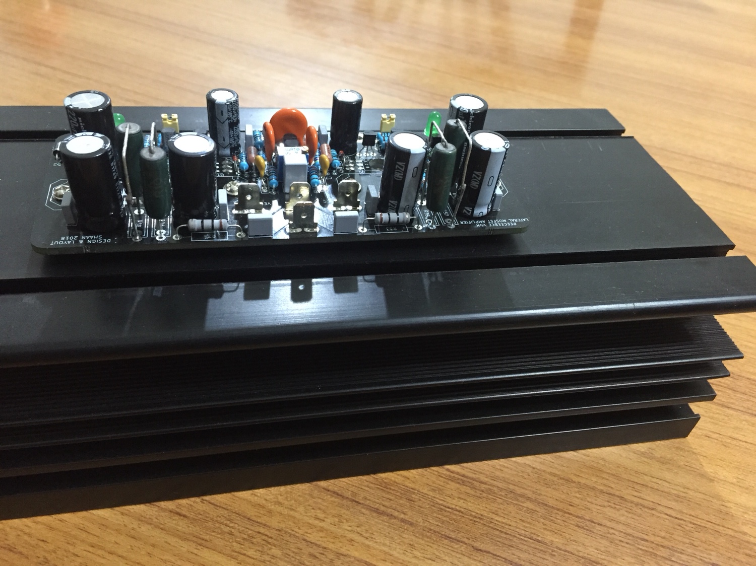

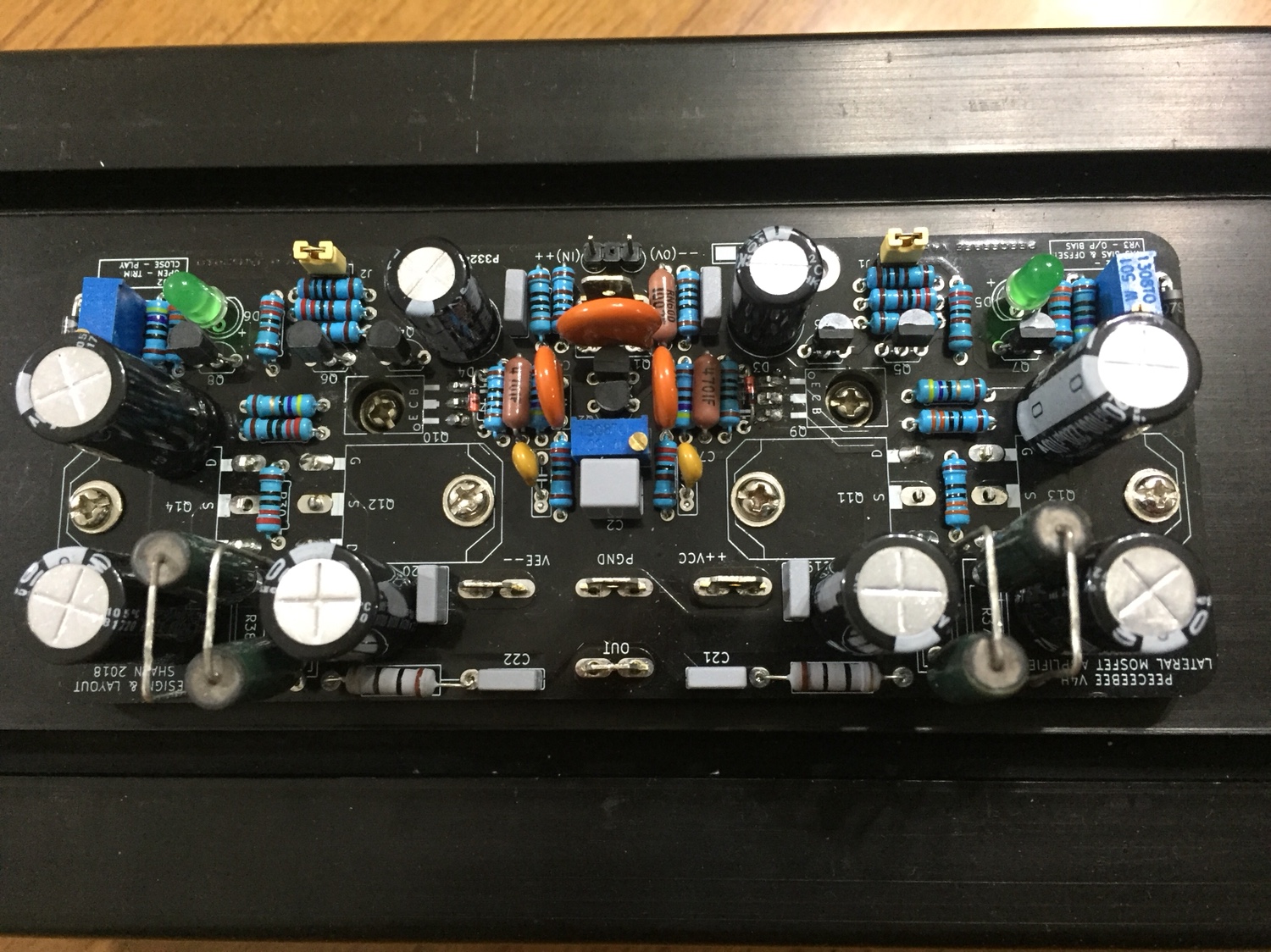

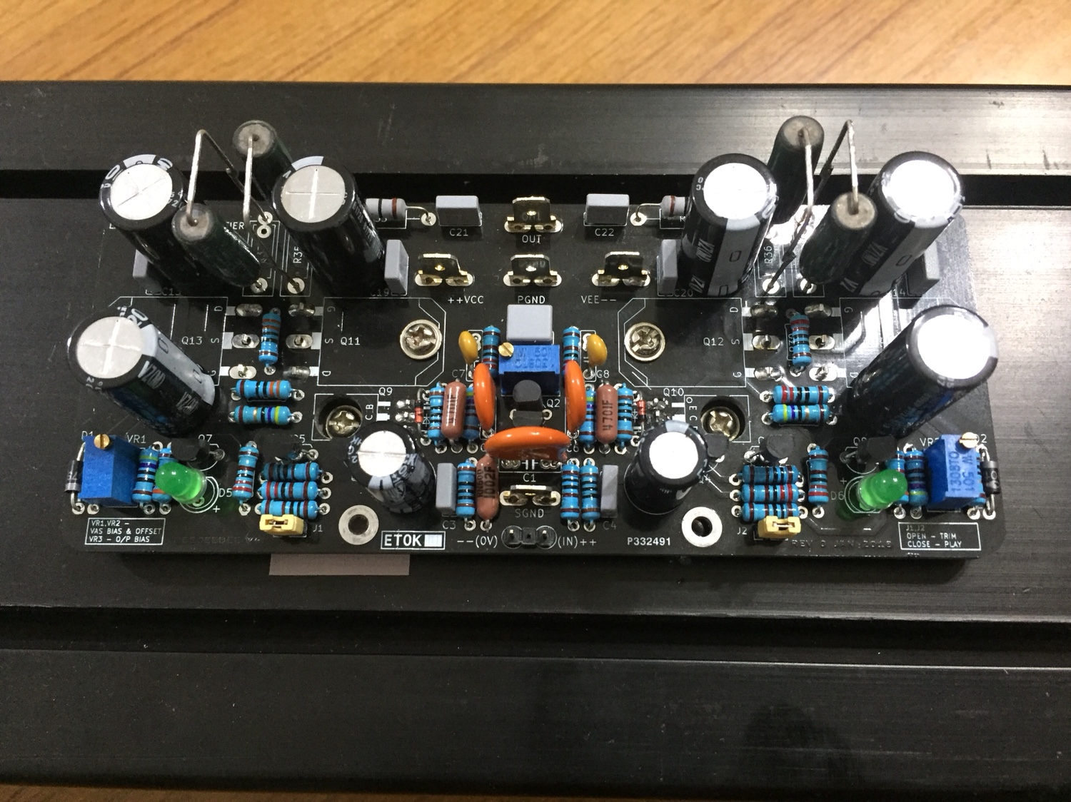

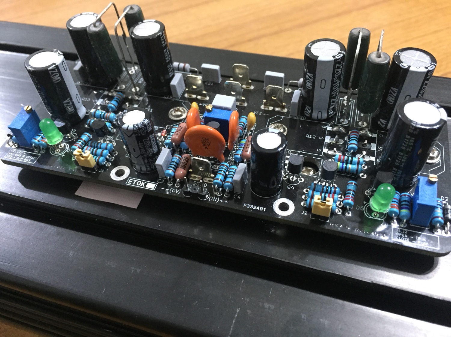

Looks good, I see from the pic that some of the legs of the mosfets are not soldered on top with gaps on the pads. May be it will be better if you can reflow some solder again on those legs.
There’s a lot on downside, so not too much to worry...soldering the MOSFET’s from the top after the components is very difficult
Manniraj is right about solder on top too, for cold joints and of course, it will look better too.
