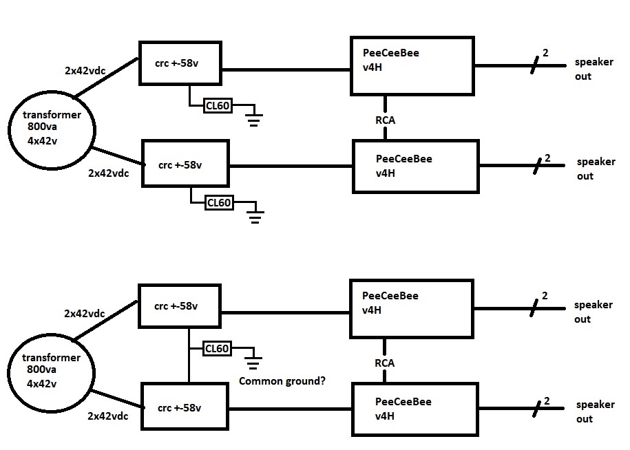

I found a transformer for cheap with 4x42v, but im uncertain of the grounding layout. I've attached a sketch, but uncertain if the RCA will cause a ground loop. Any suggestions?

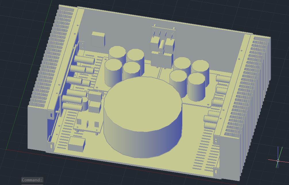

I was too late for the PSU, so im using diyaudios protection boards. Had some fun learning autocad and drew my build. Dissipante 3U 300mm. Looking forward to actually build it 😀
I always suggest a star ground created as far as possible from the transformer. Every ground connection except speaker return connected to star, speaker return connected to capacitor bank 0V.
It is hard to tell as it depends on many factor. Best to try your config and see.
