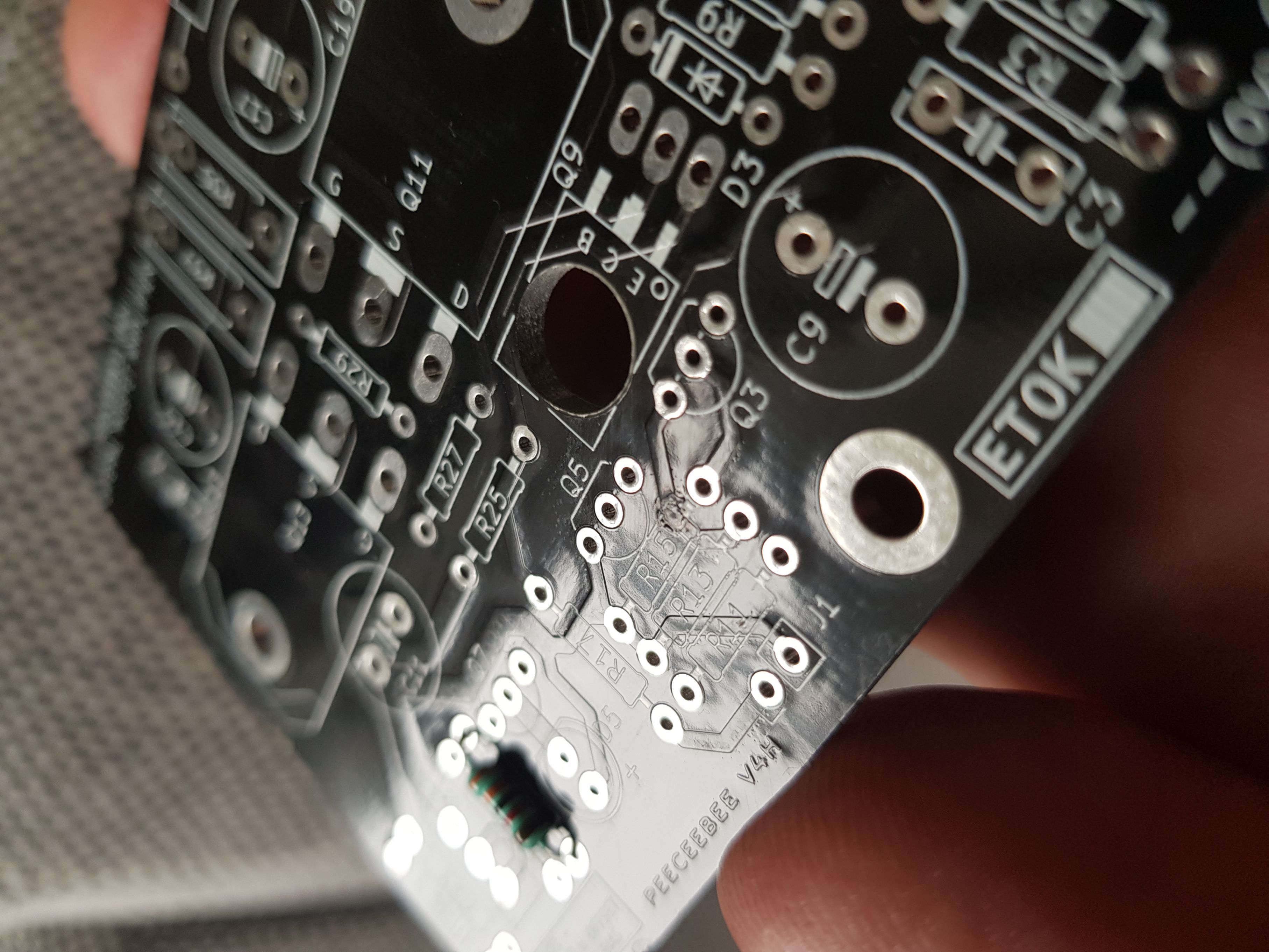

Hi Shaan,
Could you clarify the values of R27, R28, R29 & R30 again? It looks R27/R28 & R29/R30 should be pairs from the board's layout, but your circuit diagram and setup instruction show R27/R29 & R28/R30 ate pairs.

Hi Daniel, have a look to #245.
Both the FETs on the left side are N channel and on the right side are P channel. N channel Gate resistors 330R, P channel Gate resistors are 220R. Odd numberd resistors R27/29 are 330R for N channel FETs, even numbered R28/30 are 220R for P channel FETs.

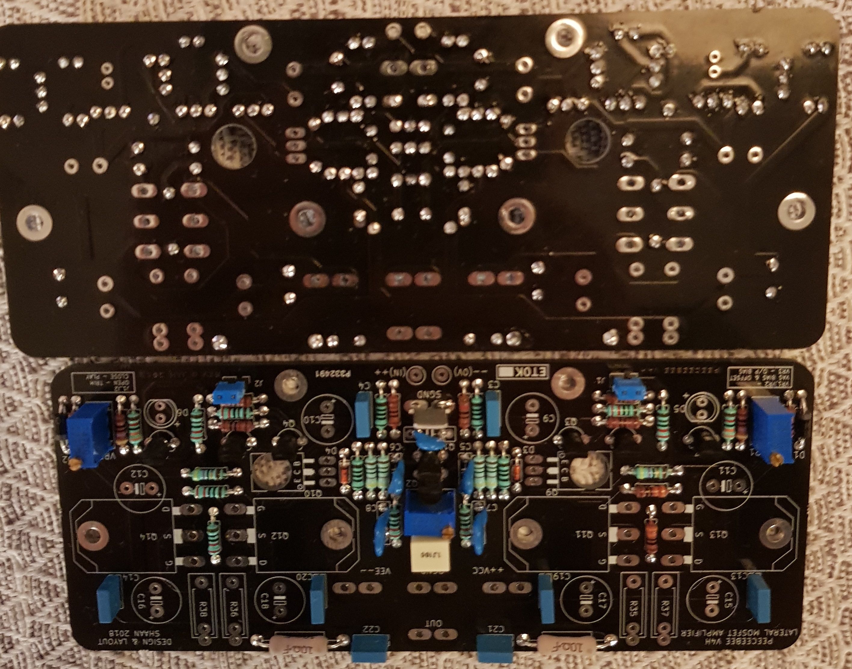

Hi ckwong99
I see metal resistors on the board, but also a bunch of solid colour resistors, eg the red 100R ones. May I ask what make and series they are from?
