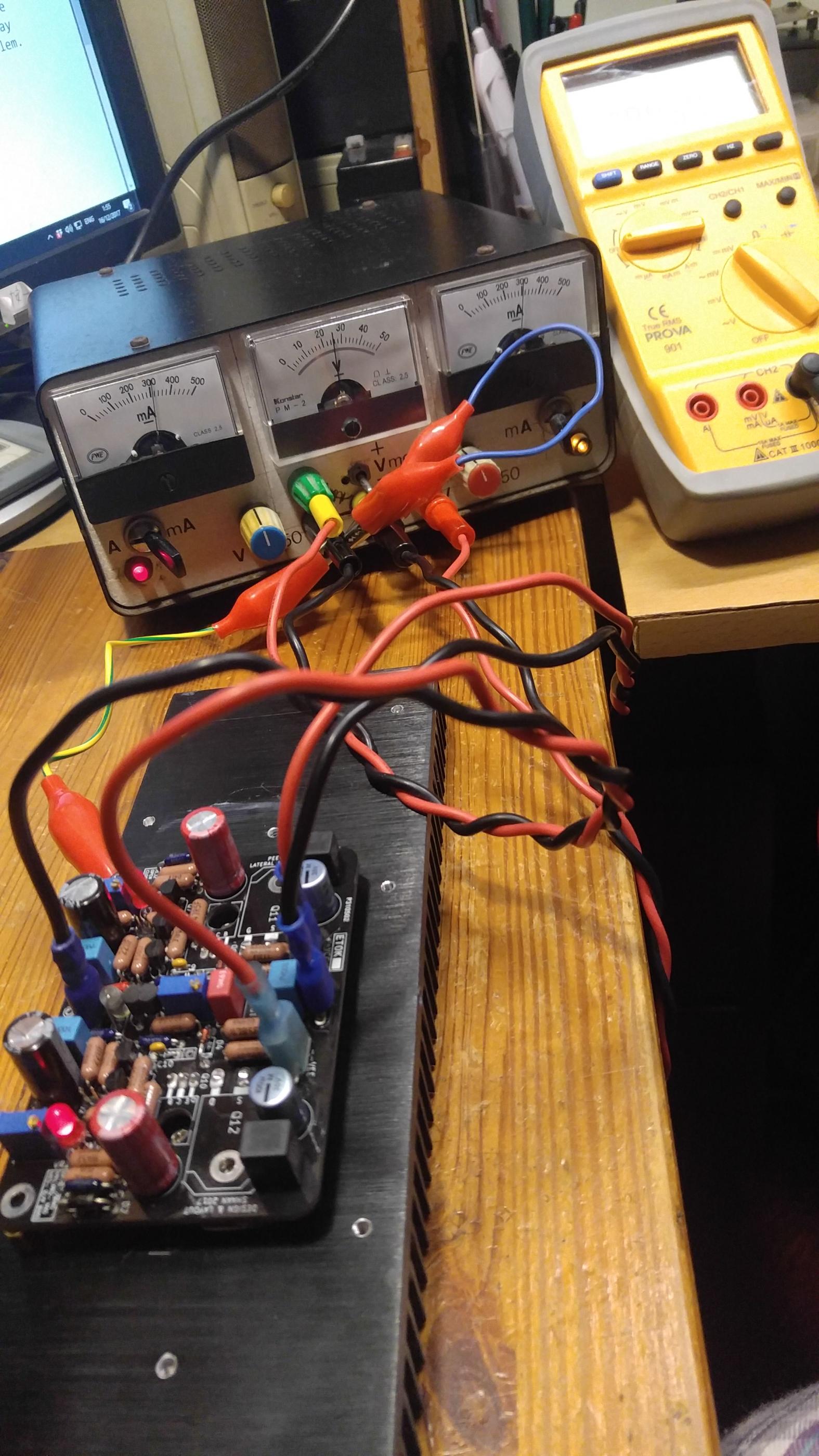

Hi Shaan,
This is my V4 board +/-24VDC rails with ECX MOSFET under testing. According to your instruction manual, it is very stable and well control in DC offset (within few Vm) and able to bias upto 600mA value. After 30 minutes, heat sink tempature up to 45 degree (in room tempature 20 degree).
Finally I adjust the bias current back to 300mA due to overheat on my bit small size heatsink.

Have you tried to keep the heatsinks in a vertically oriented fin position i.e. standing up instead of lying down? From its apparent size it seems to me that it should be able to take the extra dissipation well if placed vertically.
