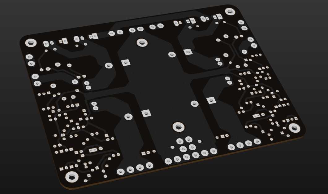

Ordered a couple prototypes of the semi-final layout of the dual-MOSFET 250W PeeCeeBee, the V4H!😉
I know I'm in the minority but I would prefer the Mosfets to be twisted around 90 degrees so they are at the top of the PCB and not completely underneath it.

Yes that orientation does have its advantages and in the past I did release a couple layouts that allowed for it. Advantages of having them underboard outnumber other methods. I like it for its simplicity of mounting, heatsink sharing with VAS transistors and saving of space inside chassis.

Future Layout ...
... and a little bit more space to have the possibility to avoid this awful faston connectors ...

Screw terminals?
For example ...
If there is enough space for screw terminals, there is place for everything,
and everybody can choose the prefered (faston, screw, PCB terminal blocks, ...).
