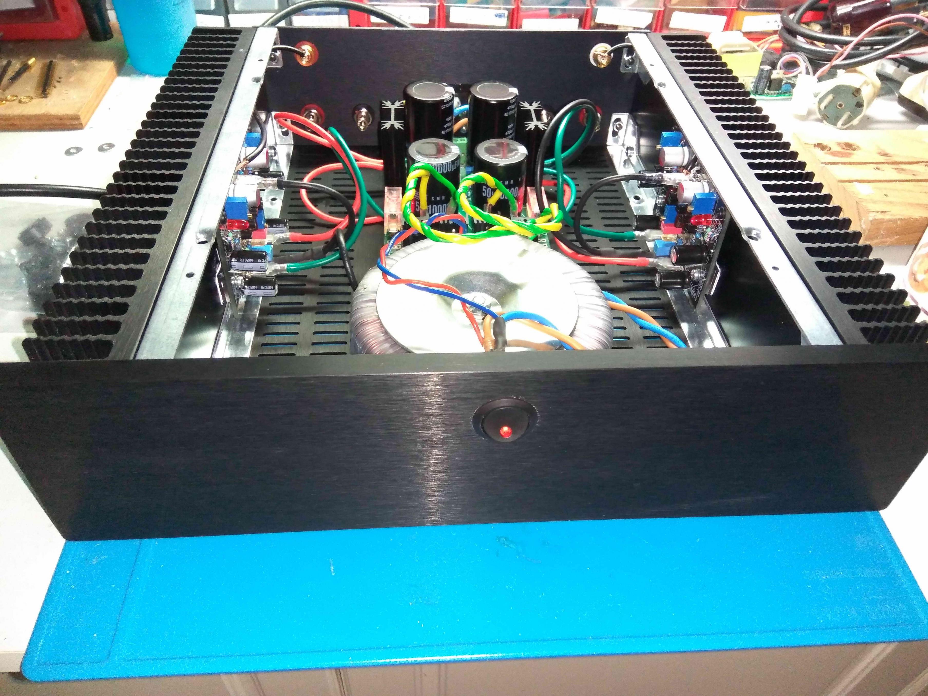

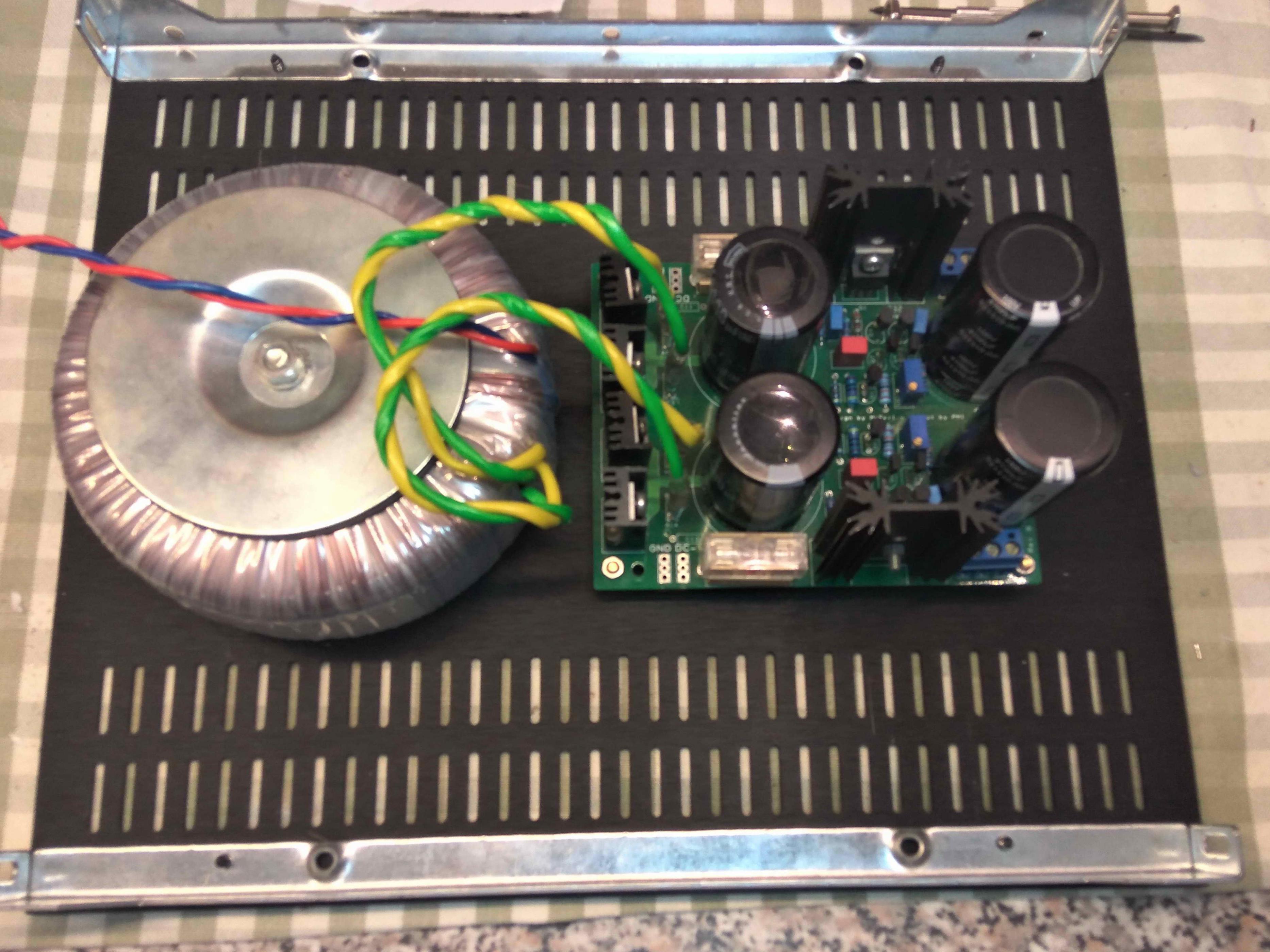

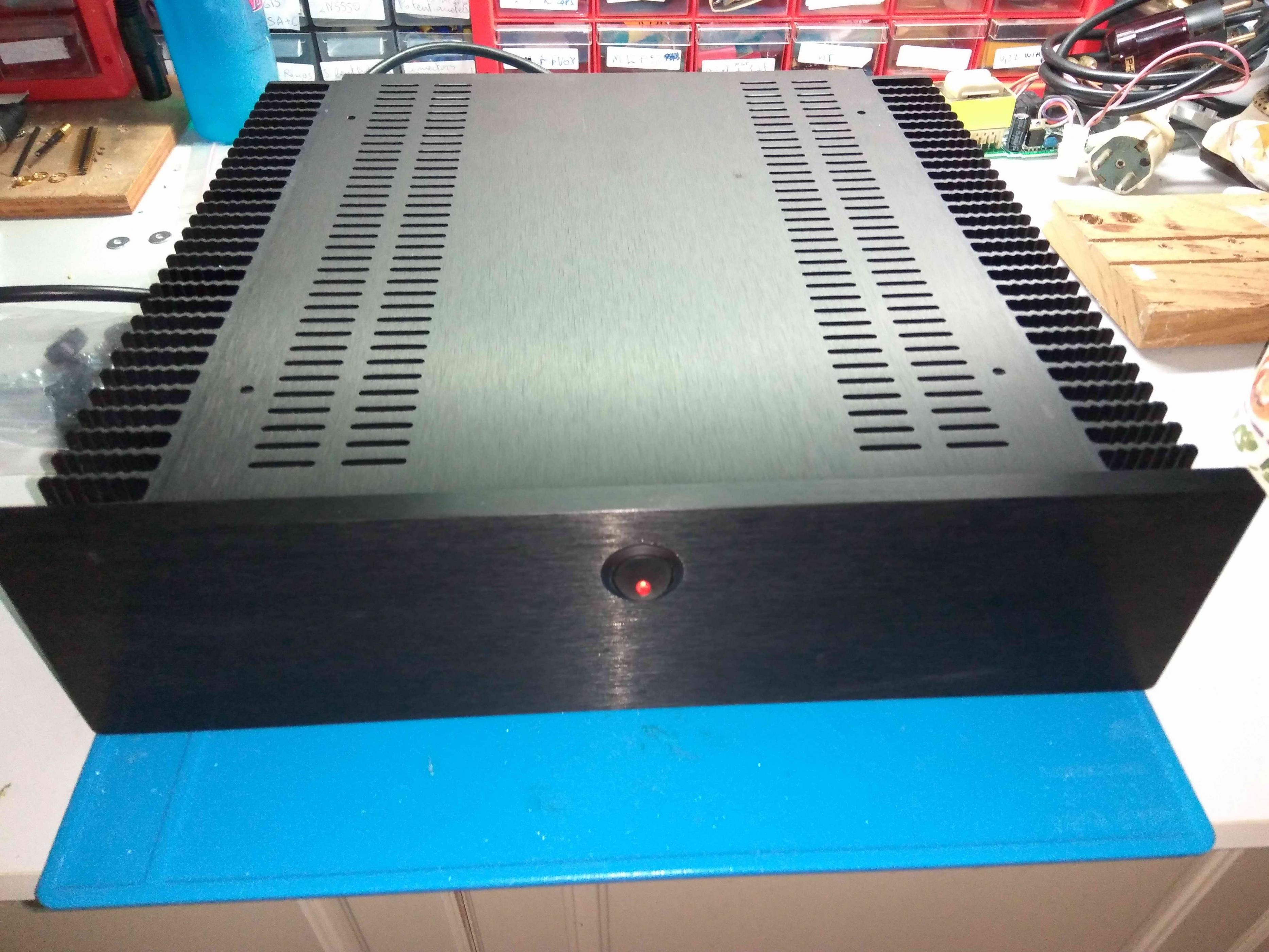

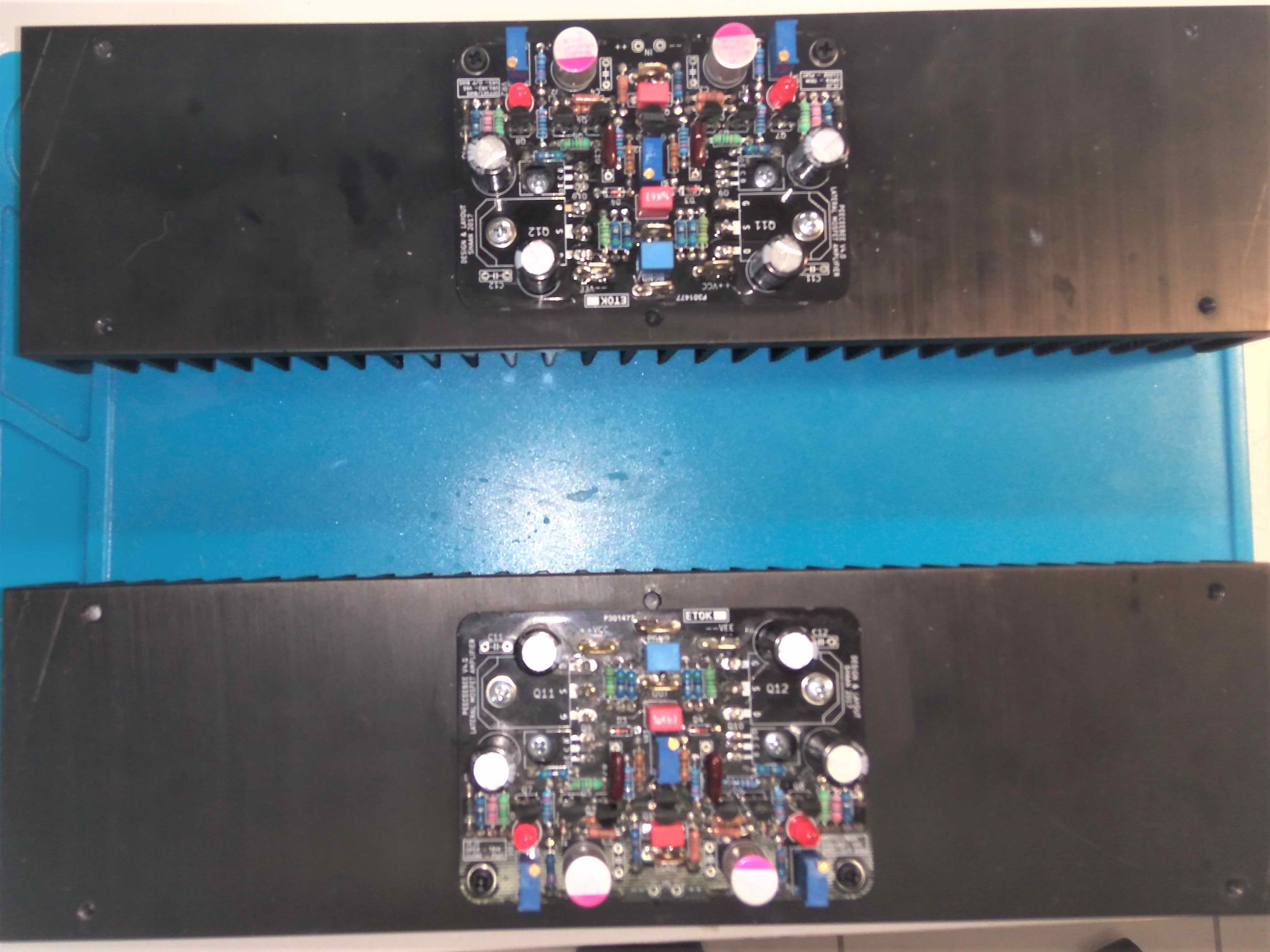

Slowly finishing my PeeCeeBee.
Used Alfet laterals for exit and ksc5303 ksa1381 for VAS.
Also polymer capacitors for feedback and panasonic FR for the rest.
One wrong resistor in one channel got me puzzled for a couple of days, but finally found it!
Will use a capacitor multiplier that I had laying around, for power supply.
Thanks for a fine amp Shaan!
