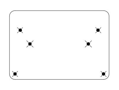

Sounds very much like you have some scaling enabled on your printer or in the pdf-reader somewhere ("fit to page/paper" maybe)?
I checked this everytime i printed the template.
Maybe some other diy-ers can print and say if their print is the same size with real pcb

Printed 103% and is ok.
Yay!!! 🙂
