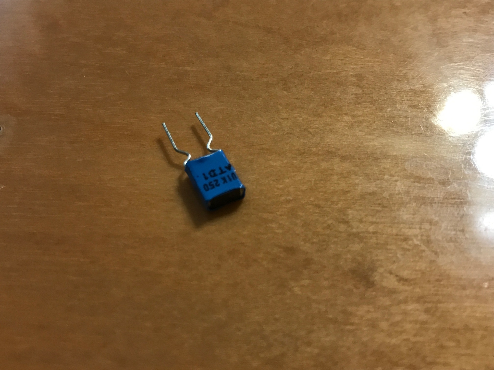

Cool. But what are the two "open headed" 0.1uF near the MOSFETs? Never saw such capacitors before.

info about those:B32559C3104K000 EPCOS (TDK) | Capacitors | DigiKeyCool. But what are the two "open headed" 0.1uF near the MOSFETs? Never saw such capacitors before.
Maybe not the best cap here but I did not have any other ones.

Nice. Wish these were available here. All Epcos I find are fully encased.

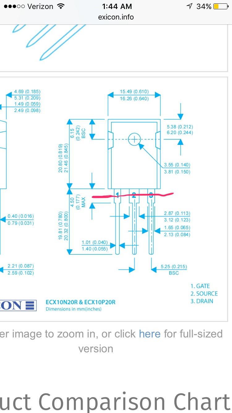

ECX10N20/ECX10P20 are a little bit different than the 2SK1058/2SJ162,
Atupi , are you trying to use the exc s mosfets?
How is the alignment for the pcb mounting holes?
I think you have to bend those legs all the way from the body of the transistors not from where the legs get skinnier, the wide part of the leg for an exicon transistor is longer than the wide part of the legs for the renesas transistors.
Plz correct me if I'm wrong...

Yes I think you are right as I am using the 2sk series and not the Exicons in mine. Now that should be the reason of mis-alignment I guess.

Yes asuslover, you need to bend the exicons legs very nasty.
