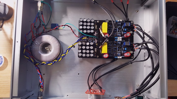

Finally Done.
Finished wiring and final fix...
195 Bias & under 0.003v offset for each channel.
Listening "Winter Night" by Al Di Meola...Perfect sound!
This is my first time to fully make a pre amplifier, though another one is
on the go.
Shaan...thanks for all the help and advice you've provided. =)

Very happy to know you like the pre's sound. Nice clean build.

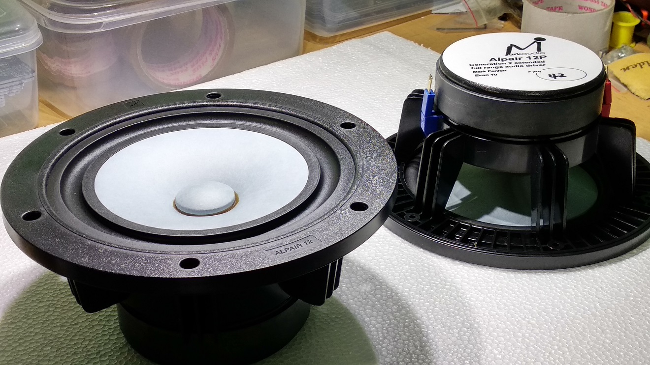

* Your new full range speakers look great...lowther?
Thanks. MarkAudio Alpair 12p.

dr. shaan, where can I see the full characteristics of the preamplifier, for example: input sensitivity, output voltageб etc.?
Hi Alekstar.
It's input sensitivity pf the preamp is basically your desired output voltage divided by 2 (due to default +6dB gain). So if your amp needs 2VRMS input for producing maximum power then the preamp will need 1VRMS to drive the amp to maximum power.
The preamp's maximum output voltage is about +/-11.5V (23V peak to peak).
