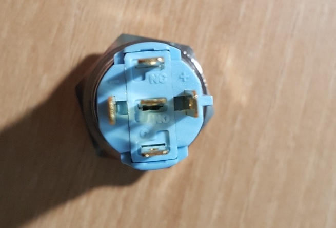

How to connect 12v led?
Now casing all the parts...but I have a question.
The led switch has 5 pins and requires 12v.
I think there are three ways as follows.
1. 220 mains
2. 2nd of the troidal (18v)
3. the psu of PeeCeeBee (15v)
Which is the most recommended and How?
Thanks.

Hi Ksjung88
TP1 and TP2, with a 10K-22K resistor in series (LED may remain lit for quite some time until the cap bank drains). Or the two AC input of the board, with a single diode rectifier and 10k-22k resistor in series and a 100uF capacitor to smooth it slightly (LED will shut down quickly at power off).
