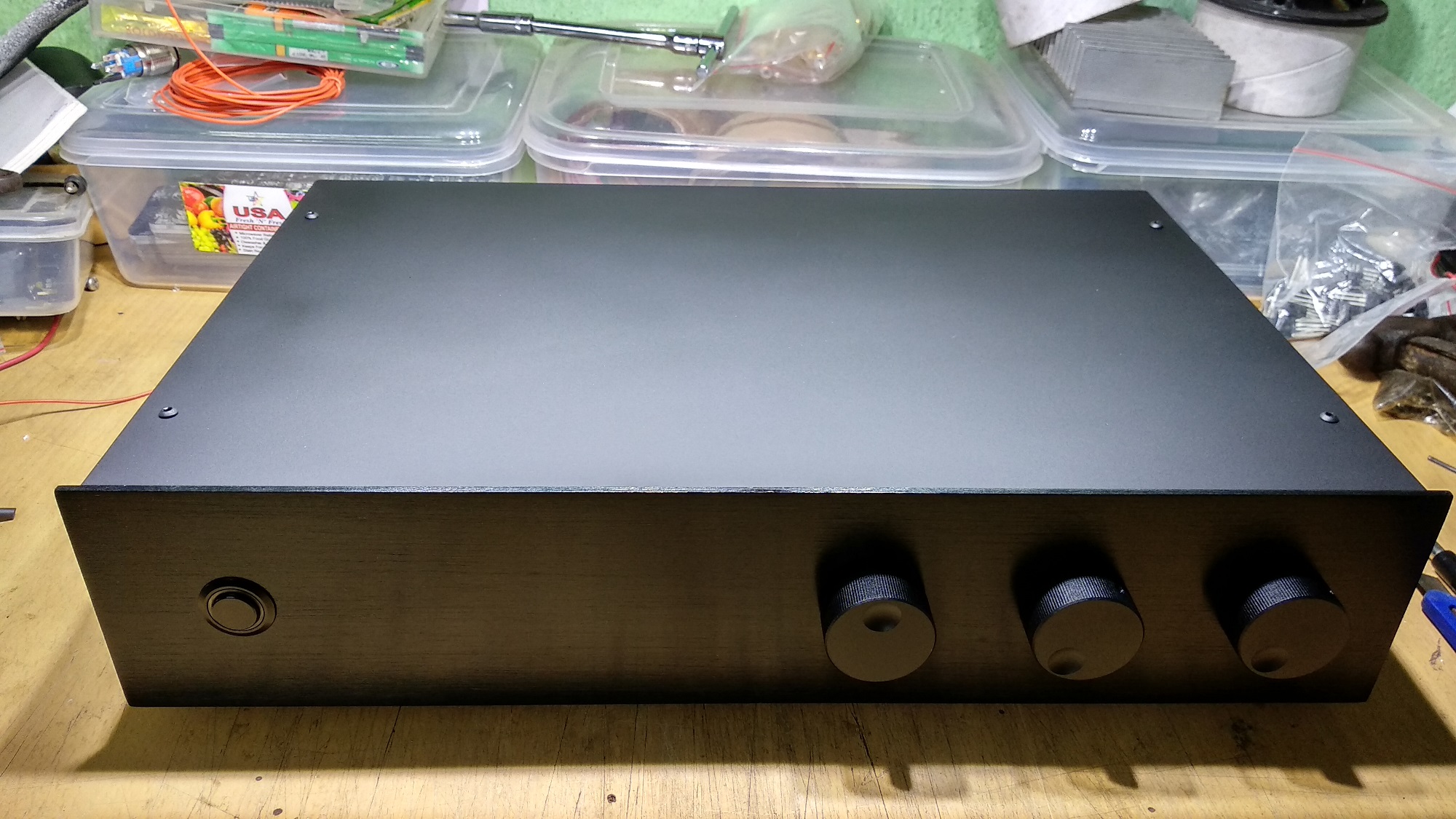

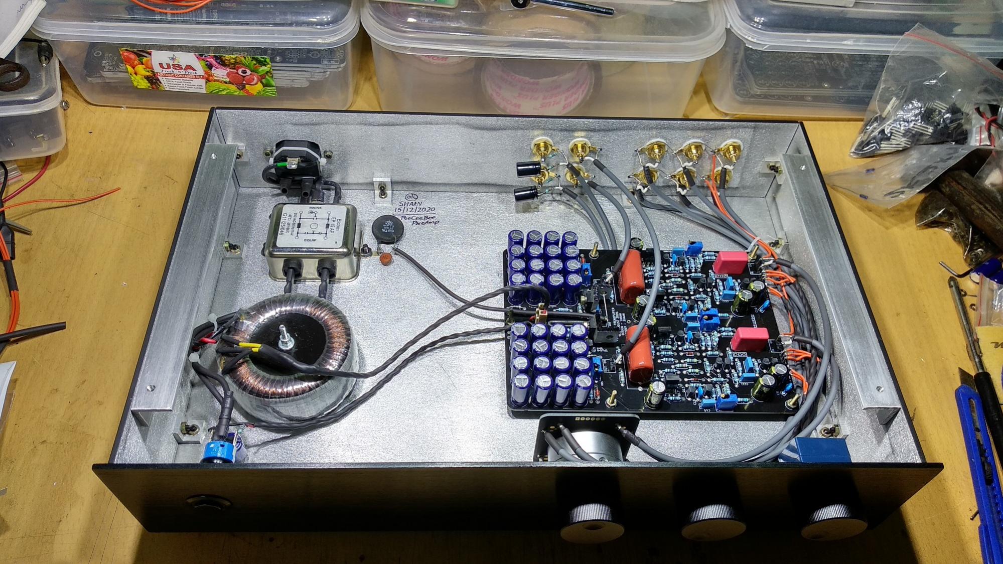

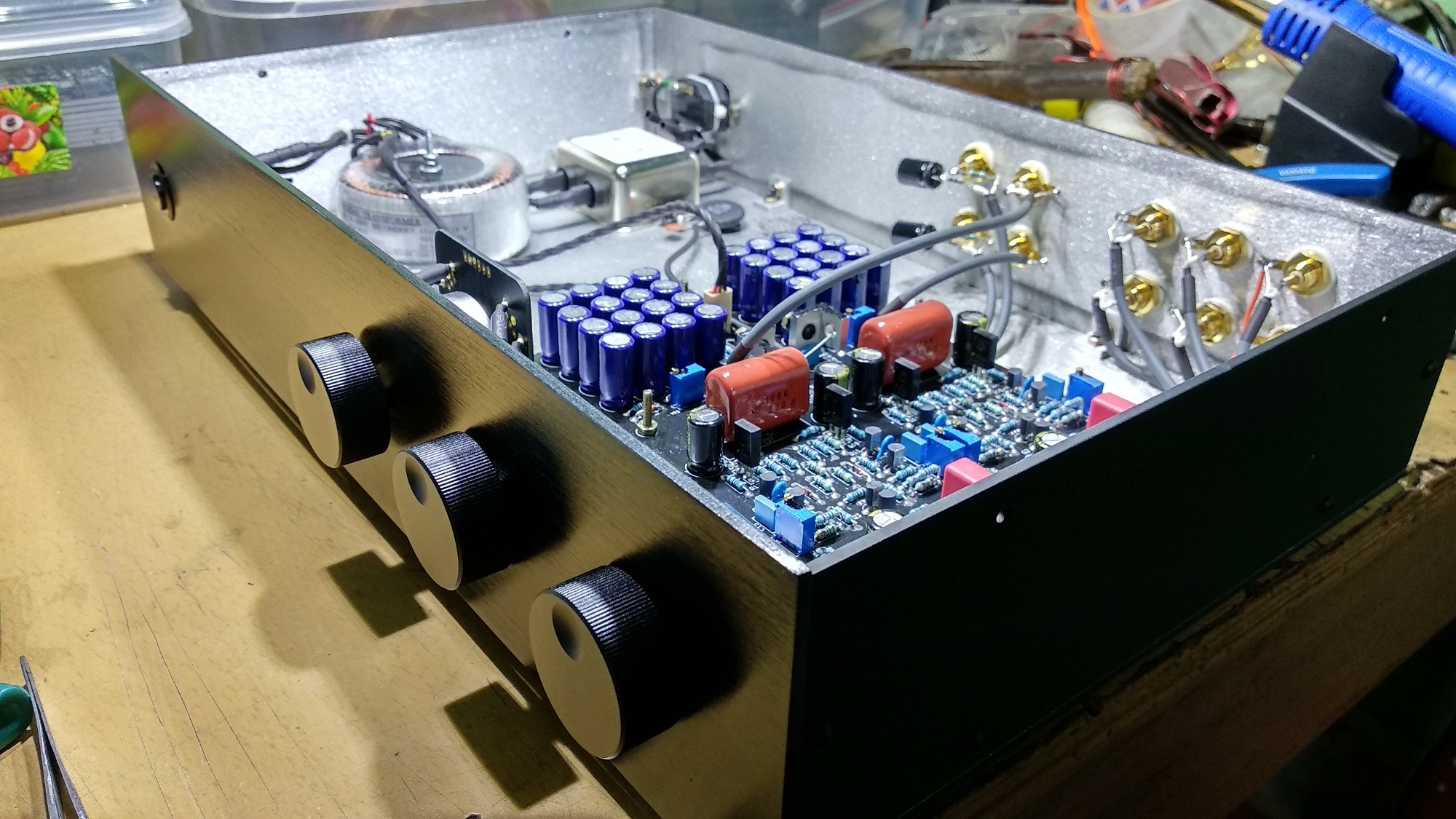

Just finished. 🙂🙂🙂
Impeccable PeeCeeBee Preamp (aka Black Beauty) Shaan!! Beautifully done.

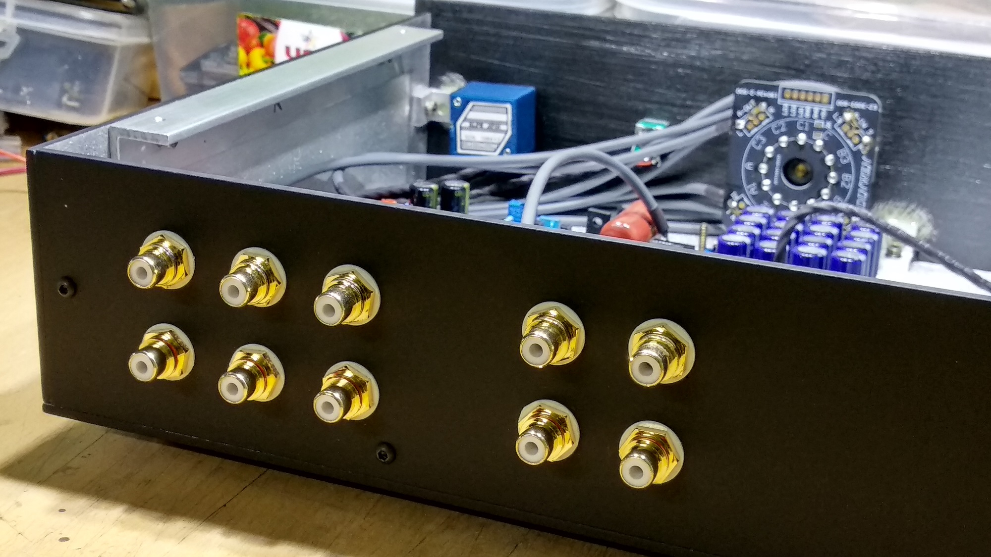

Can you post information/link for the rotary selector switch and pcb, and the push-button power switch. Thank you.
Hi Vincent.
Thanks. Here are the links.
LED Ring type Switch -Blue_latching_BLACK
EIZZ Rotary Audio Input Selector Switch 3003800 with PCB

Nice work shaan,
Could you please post the dimensions of the enclosure (W x H x D). I like the amount of working space.

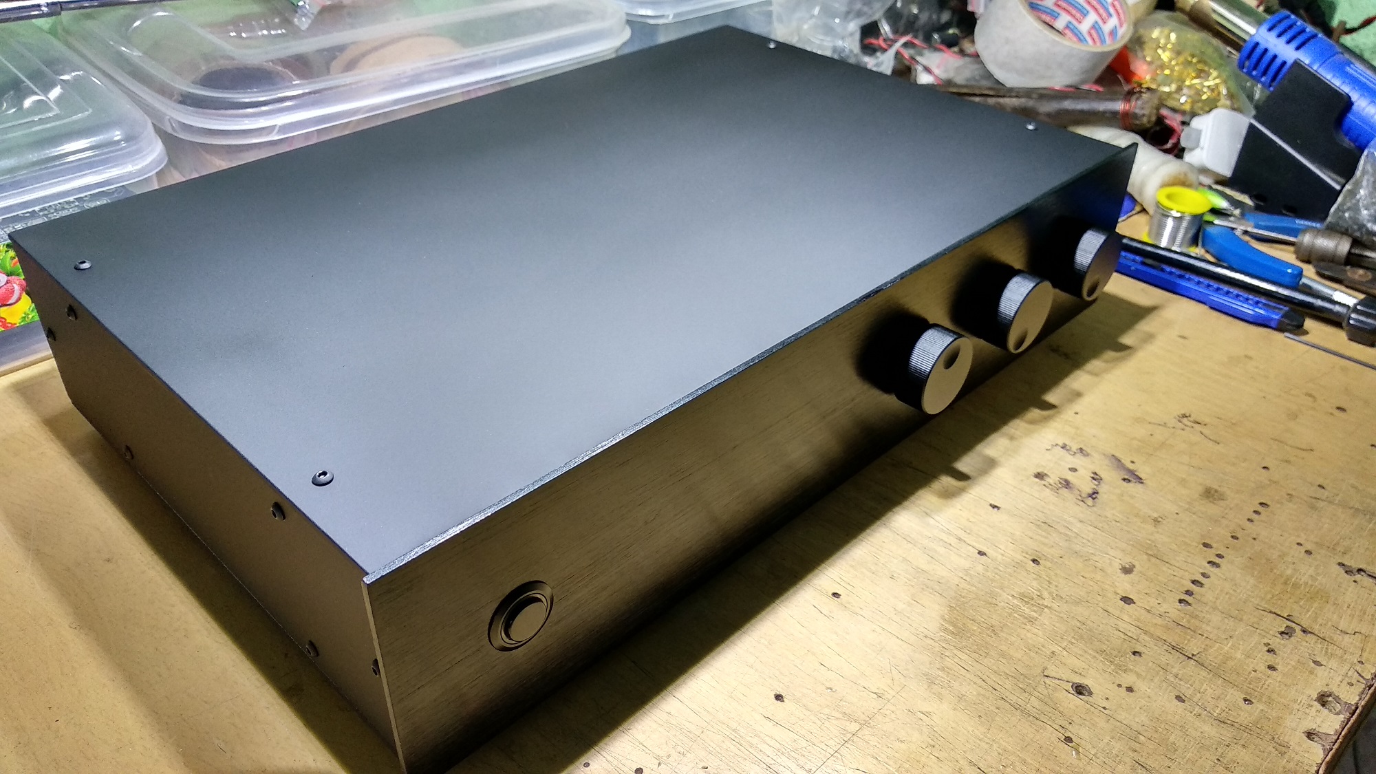

“LED Ring type Switch -Blue_latching_BLACK“ Anti-vandal type push button switch, very good price , around 6$/ each . I am curious if one switch like that is suitable for one stereo amp v4h .
Nice work shaan,
Thanks. The dimensions are 15"x9.5"x3".
Yes it is sufficient.

Shaan, where did you get the enclosure?
Handbuilt at home. 🙂
Just finished. 🙂🙂🙂
Very nice Shaan 🙂

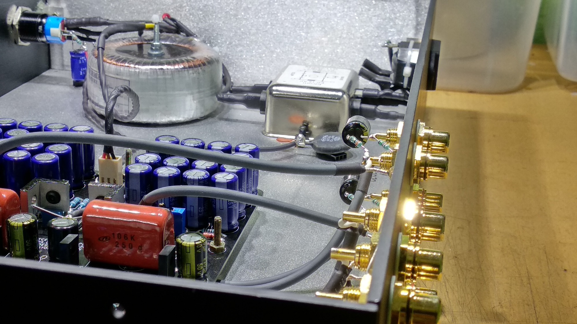

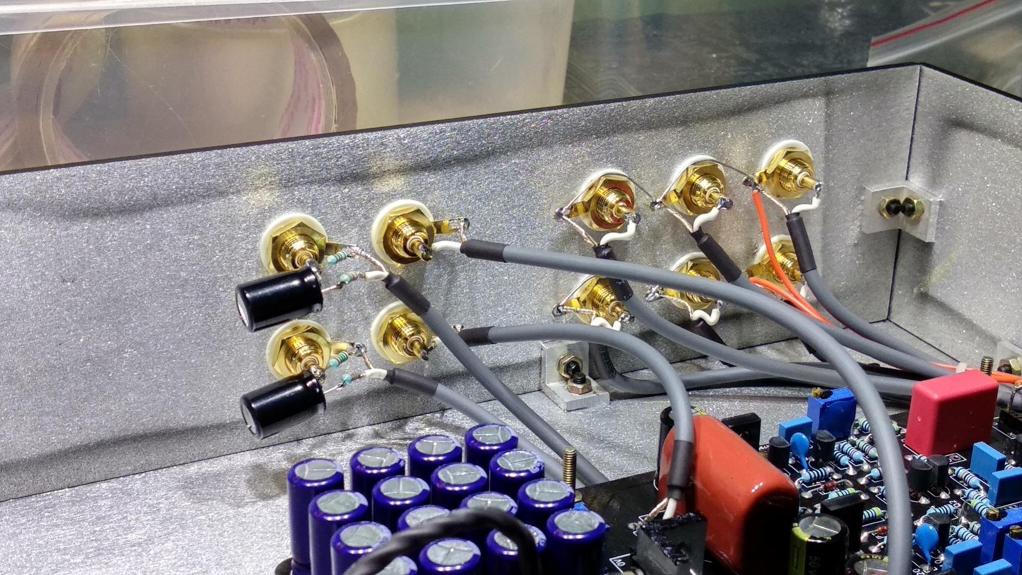

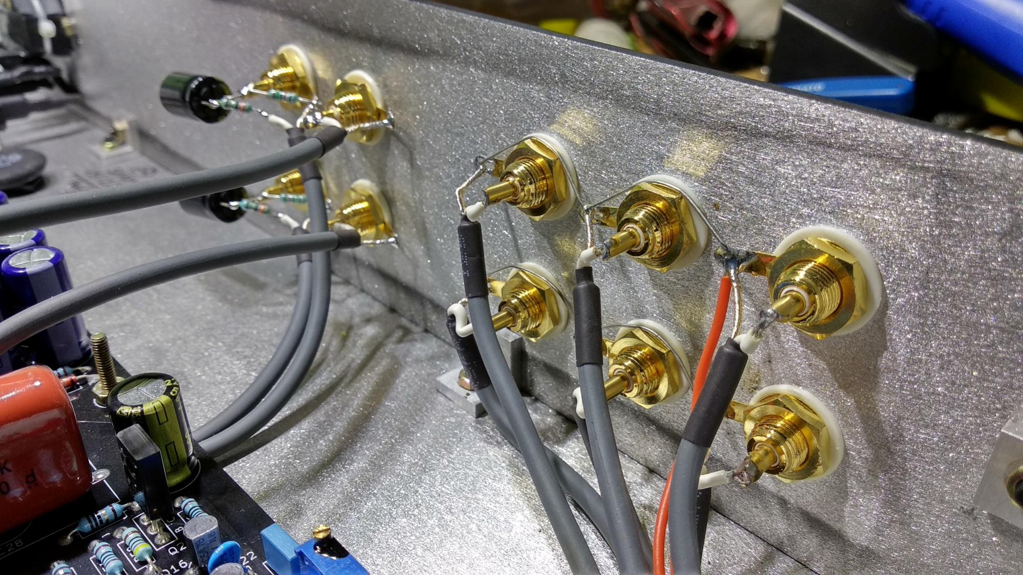

One quick question on the outputs you have connected a cap + resistor with the signal side and the grounds, any specific reason why that is needed? And also where this outputs connected to as the cables go beneath the PCB and not visible from the pics. Is this 2 different outputs and what are the differences?
Hi Manniraj.
Thanks.
The electrolytics are connected from before C27/C28 and act as a second hot output with higher current capacity in order to drive headphones if necessary, or just act an auxiliary output for connecting a subwoofer amp. As the 22ohm was bypassed for the electrolytic I installed a 33ohm(didn't have 22ohm ready at hand) in series and installed a 15kohm from its negative pin to ground to give the electro a charging path. The offset is set slightly positive to bias the electros in the correct polarity.
Thanks.
Just finished. 🙂🙂🙂
So can it now drive both the power amp and sub at the sametime without any issue with the current drive capability of the preamp? Also what value is the cap?
