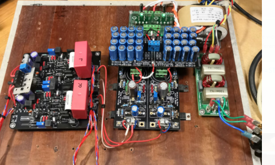

Hi Shaan,
Thanks for your design and PCB . It is very elegant sound /warmly as good as my tube preamp, much low background noise and operation stable. I listened few days (around 10 hours) and feel all the words from singer voice clear and concrete than my before equipment. Indeed, it is much wroth to all my given time and coins. :>
Hi CK.
Glad to hear you like the preamp's sound.
You seem to have cut the PCB and put a secondary regulator module in between. Interesting.
Did you take the PCB from one of the two members who joined from HongKong? I don't see your entry in the GB.
Just one thing i want to clarify, how much voltage gain of this preamp ? My system is DAC -> Passive preamp (resistive load) -> Pee Preamp -> PowerAMP , I find the gain more less than my previous preamp. My Pee Preamp is bypassed C1, not sure it will make the gain less ? How can i change the component to get more voltage gain ?
CK
Very easy. Increase R55,56,57,58 to 2k2 for about 5 times gain. If more is needed then increase to 2k7. Re-trim output bias and offset after replacing the resistors. Done.
If your source doesn't have DC at its output then you can bypass C1. Still it's good to have a capacitor there.
Hi Shaan,
Yes, i cut it and use your capacitor bank with my standalone parallel regulator. During i do this modification moment, i find the schematic D11 & 12 label swapped, which compare to PCB silk print. Actually, it is not a big deal who those follow the PCB w/o modifying. However, my change need two jumpers short 2 diodes in rectification will have problem. It was because i use active bridge to replace the diodes.
This time my fried help me order, he is Daniel.
Current design is R55~58 is 1K , so what is the existing voltage gain ? how to do the calculation ? I want to take existing gain as reference then to make my optimal gain value.
Sure , to play safe it should via C1, but for better sound result, i skip it now 😛

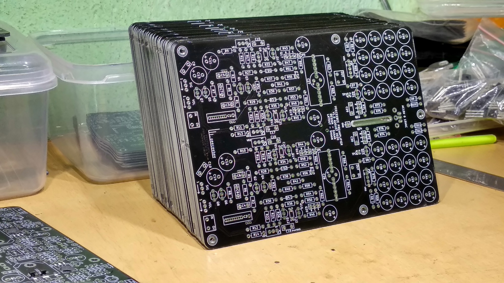

A packet of 50 preamp boards reaching me by 15th.

Gain is roughly the value of these resistors divided by 470. I would recommend you keep C1 on board.
