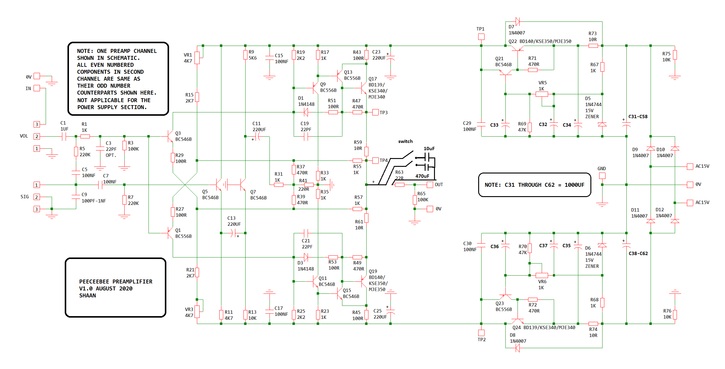

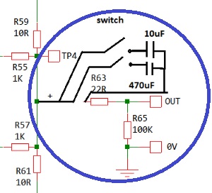

Hi Shann,I can use a switch for switching HPA/PREAMP
Hi Bogdan.
Yes and no. Some like the setting at zero, some like a little color. The control is made variable mainly for the latter to enjoy the colors if they find it enjoyable, and for the former to see what it does with the music and then completely turn it down with a reason. :)
