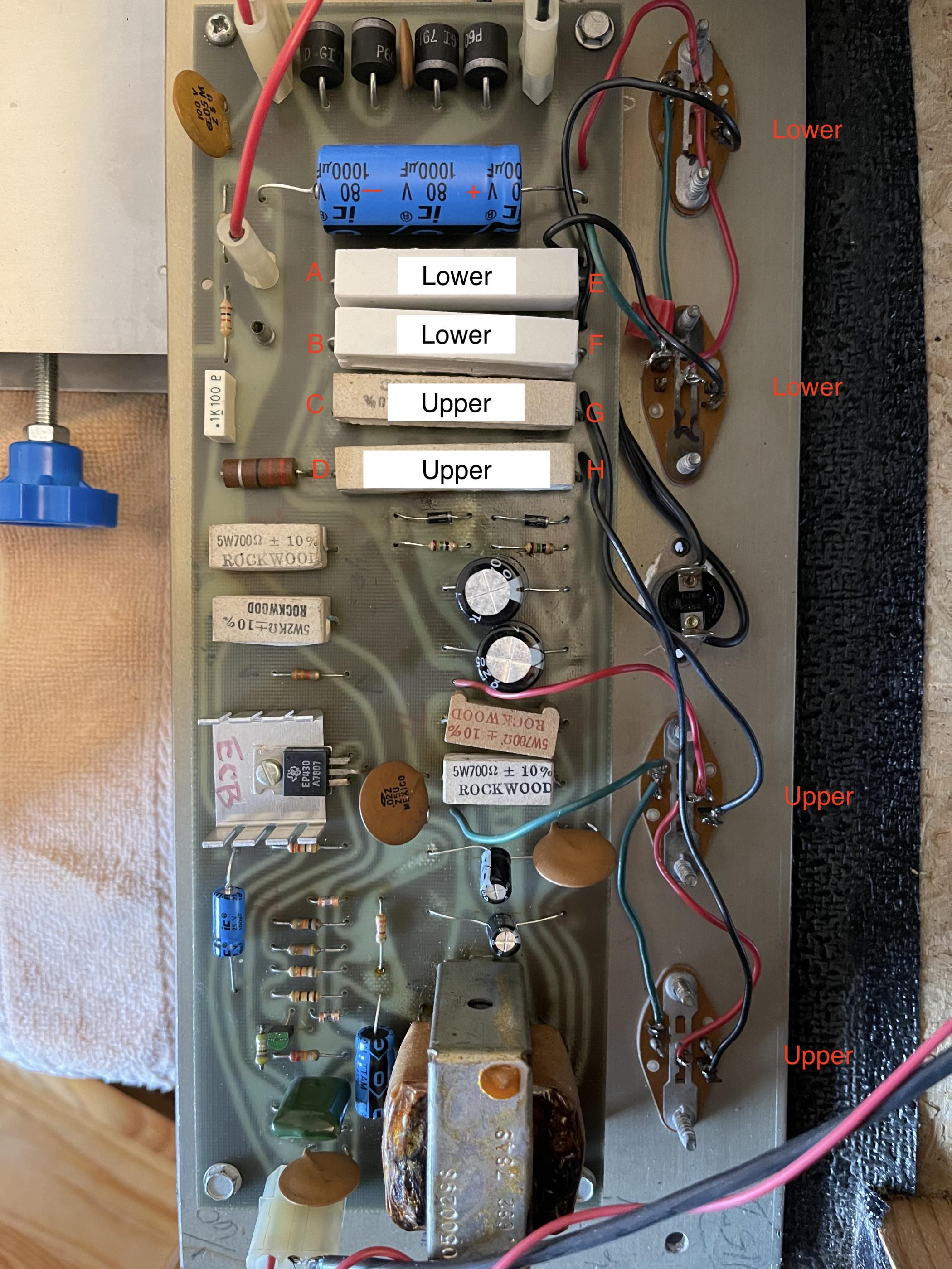

Measured the below voltages (all voltages +DC, referenced to chassis ground), see attached picture.
A. .002
B. .002
C. .143
D. .144
E. .103
F. .102
G. .220
H. .219
This means I have ~147 ma through my lower emitter resistors and ~113 ma through my upper emitter resistors.
Disconnecting bases of lower transistors gave me ~59.8 VDC across the 3500uf cap can, ~26.2 VDC at the upper transistor emitters, and ~26.1 VDC at the positive of the 1000uf speaker cap.

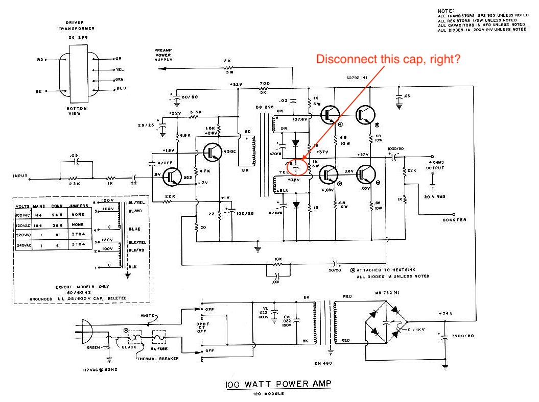

I'll try disconnecting the .02 uf cap that connects to the bases of the lower output transistors next.

No, the result of the disconnecting the bases of the lower transistors proves they are leaking. Iceo is 147 ma each in your test, much too high. Current limited only by the bias network of the upper transistors. Iceo is measured with bases disconnected.

You need to measure the voltage drop across the lower emitter resistors with the lower output transistor bases disconnected. Then divide by .68 ohms to get current. Current I lower transistors >= to that out upper transistors emitters, the lower transistors are leaking at 37 v even though they didn't leak at 12 v by your test.
MJ15024 are excellent, if a bit over tough for a 2n3055. Keystone makes great sockets, but a bases disconnected Iceo test on lower two transistors @ 37 v will prove sockets okay, if all the current going in the collectors of the lower output transistors, is coming out the emitters.

Hang on, you said all emitter current went to zero, both upper & lower emitter resistors, when you disconnected the bases of the lower transistors. You said lower transistor collector voltage went near the main supply voltage, the "can cap" voltage.
I correct what I said. No lower transistor emitter current with no base drive current means the lower output transistors are good, and too much base current is driving the collectors too close to ground.
Since you pulled the .02 uf cap, the excessive idle base current is getting to the lower transistor bases from some other way. Try putting the .02 uf cap back, and disconnecting the interstage transformer from the lower transistor bases. Maybe the excessive idle base current is coming from there. then measure the speaker cap upper voltage and the idle current through the upper & lower emitter resistors.

Disconnected the "yellow" winding (as marked on the SCH), reconnected .02 cap and lower transistor bases, and rechecked voltages. All voltages DC measured wrt chassis ground. See picture in post #81 for labels. Speaker cap upper voltage was ~+26.4 VDC.

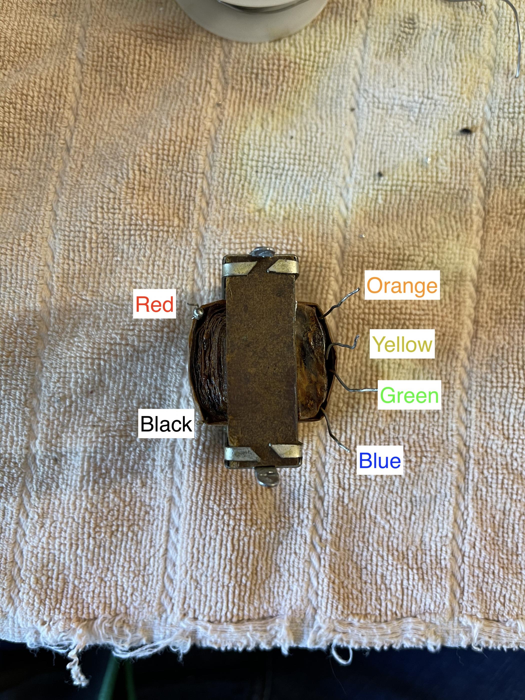

Looks like very little current draw across emitter resistors (DBT was dim in this test as well); does this mean the interstage transformer is bad? If so, am I SOL until another broken PA-200 (or similar model) floats by on eBay? Looks like it is a "DC-298" or 70500298 per SCH and text on the transformer itself.

Yes. Sorry about my mistake in post 82. I think a guitar head from that era may have interstage transformer too, but I don't play guitar so I've never had one apart. Advantage of old peavey mastodons, you can get the schematic diagram from the model number without buying the product. The look for an interstage transformer before you put in a bid on ebay or craigslist or gumtree.

For curiosity's sake, I removed the interstage transformer from the board and took resistance readings: see below (all values in ohms). It seems like the blue wire might be disconnected; would this cause the excessive idle base current I was seeing before?
Red - Black: 83.9
Red - Orange: 47.1
Red - Yellow: 47.1
Red - Green: 43.9
Red - Blue: open

The Blue wire might be open circuit, but there should be no continuity between the separate windings. According to the schematic in post #81, Black/Red winding, Orange/Green winding, Yellow/Blue winding should be insulated from each other. I think I might have a PA-200 for parts. I will check if it is similar model when I get to my basement later.
