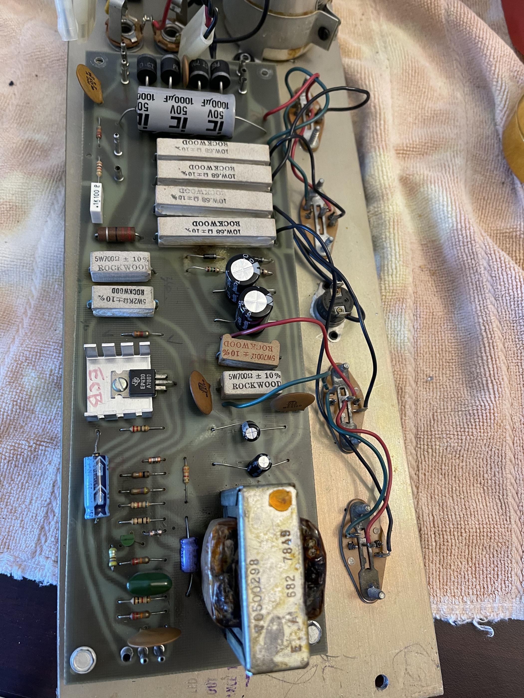

Well nothing is going to pretend to work right until all 4 dead components, the diodes and resistors, are replaced.
IMHO 1n4003 may not have enough current rating for these positions. I'd use 2 or 3 amp rated ordinary diodes. Not schottky, but UF might be okay here. MR752 like in the bridge would do it but those might be pricey. You want at least 100 piv rating diodes.
Something took those diodes out, I'd check the .02 uf cap to the preamp power supply is not shorted. I'd also pull the base of each output transistor and make sure it is not shorted b to e or b to c.
Well, seeing Mr. Fahey's post, I see my prejudice against 30 year old rubber sealed wet capacitors is justified.
I hope the interstage transformer is not damaged. It has a dark spot on it.

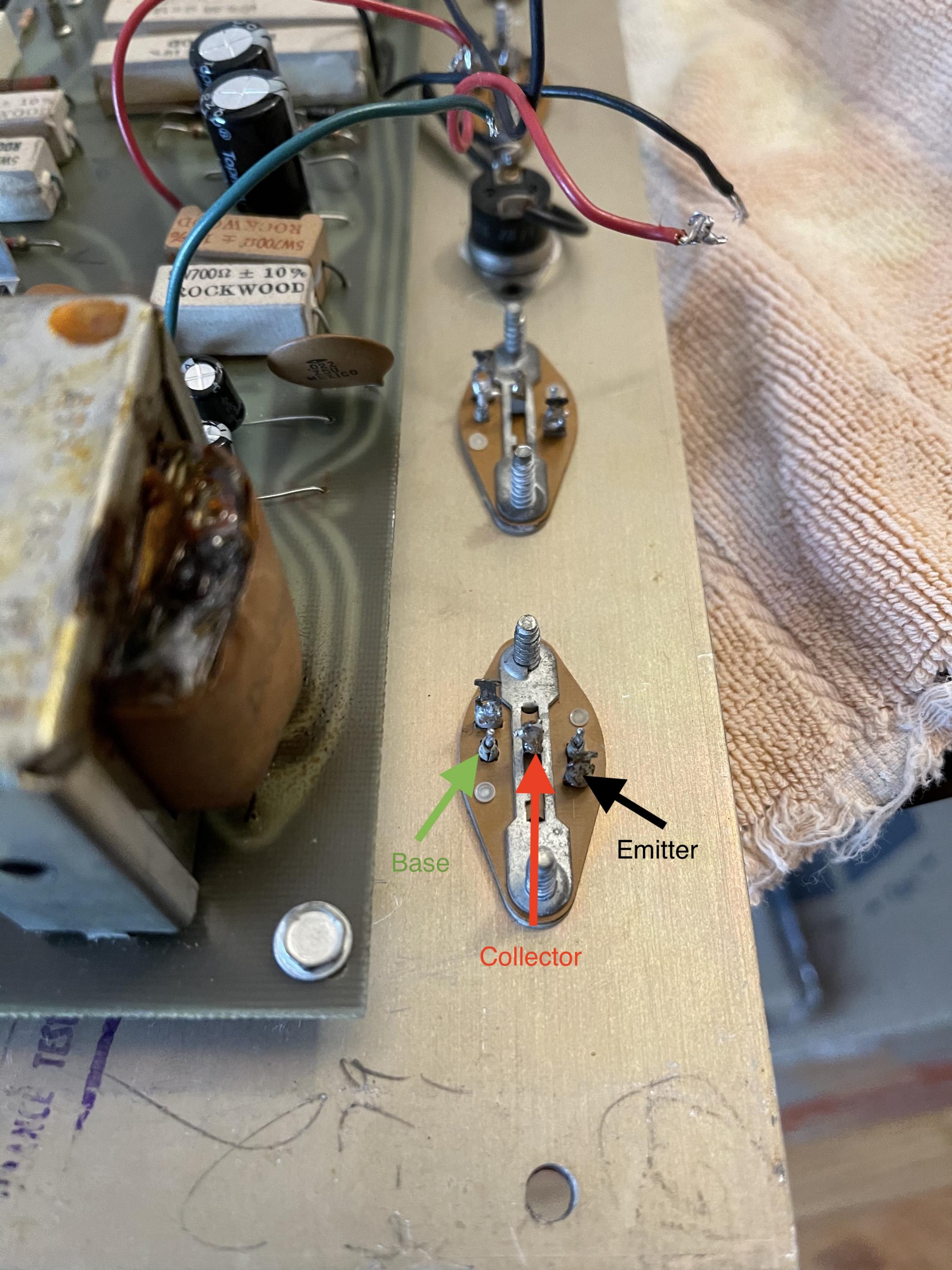

The TO3 output transistors, looking at the bottom from the screw in the long direction, the base is the one on the left. Emitter is the one on the right. Collector is the screw on the end, unless it is insulated from case by a plastic ferrule.

Progress update: I replaced the 2x diodes and 15 ohm resistors with new parts (1N4001 for the diode). Only the burnt diode measured as faulty once removed from the circuit (other diode and resistors were ok). I also replaced the 470uf and 50 uf caps whose values had drifted far out of original range. The 3500uf, 1000uf, 100uf, and 25uf caps measured ok, so I left them in.
Measuring the output transistors showed that 3 out of 4 were continuous (0V drop in diode test) from base (green wire) to emitter (black wire). I'll remove the transistors from the circuit and retest. The emitter resistors also seem to be much higher value than expected (but not open), so I'll remove them from circuit and retest as well.

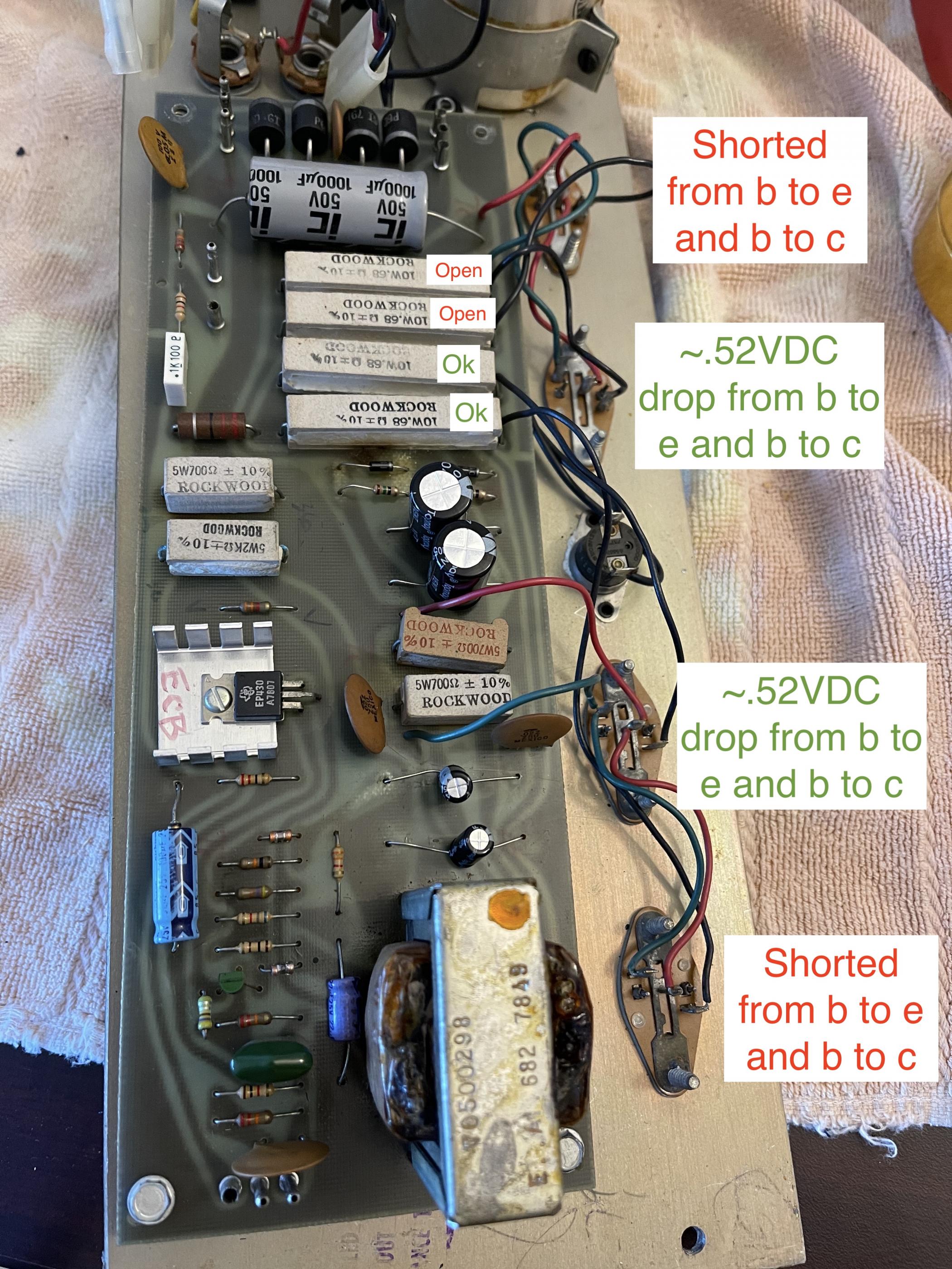

Ok, I removed the transistors and emitter resistors from the circuit with the attached results: it looks like 2x transistors and 2x resistors are dead. Interestingly, the dead parts are not from the same pairs (a resistor from dead transistor is ok, and vice versa).

Yes, zero voltage drop across b-e or c-e on a silicon transistor on diode scale is the wrong number.
Yes, MJ15024 is a superior npn transistor that will replace these. All 4 transistors should be changed at the same time, with the same part number, from the same batch. MJ21194 may be cheaper, and would be entirely adequate. MJ15015 is also adequate and very inexpensive, if they still stock it. I got my 15015 at $1.40 each years ago.

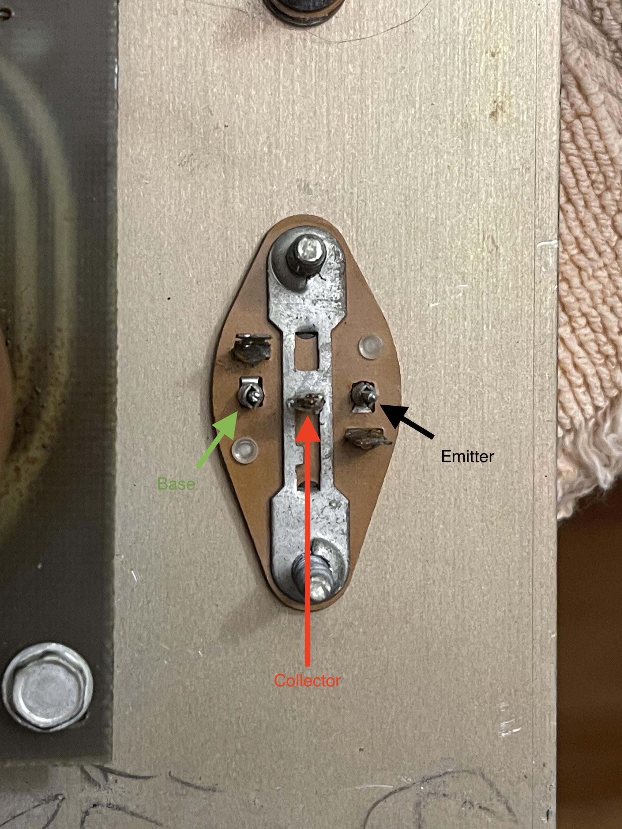

Hi all, I am installing my parts from Digikey and wanted to confirm the pinout of my transistors (datasheet here). The datasheet is not entirely clear which pin is the base and which is the emitter; the picture seems to show an arbitrary orientation. Do I have it correct in the picture below?
In addition, I'm a bit confused about the electrical connection of the case (red wire). The cases of the transistors aren't connected electrically to the middle pins of the transistor sockets, so what exactly is the purpose of the red wires?

For TO3 pin identification see post 25. I think this picture is looking from the long direction at the pins, but if not, other way.
I didn't take it apart so I don't know where the red wire goes. Possibly to one of the collectors but you have to get the right one. Each has an individual wire. Two of the collectors go to the centerline, the + of the speaker capacitor. Two of the collectors go to the +74 supply. Peavey later used the screws on the ends of the transistors to connect to a PCB; I don't know if they were doing it in 197? The screws must be insulated from the aluminum plate since all 4 transistors are mounted on it.
If this was disassembled and abandoned by a previous owner, you'll have to trace the base & emitter leads and compare to the schematic diagram to figure out which pair of output transistors is which. Then install red wire for the +74 and some other color (I use orange) for the centerline.
Those cases ARE connected to the middle strip by the mounting screws.
And you got E and B right, at least on the last picture.
Your 45 degree angle is somewhat confusing, a 90 degree picture would be much better, then there is no doubt whatsoever about E-B-C pinout.
Yes.
Now it´s easier to see that E and B pins are not halfway between mounting screws but shifted towards one end.
Your labelling is fine.
