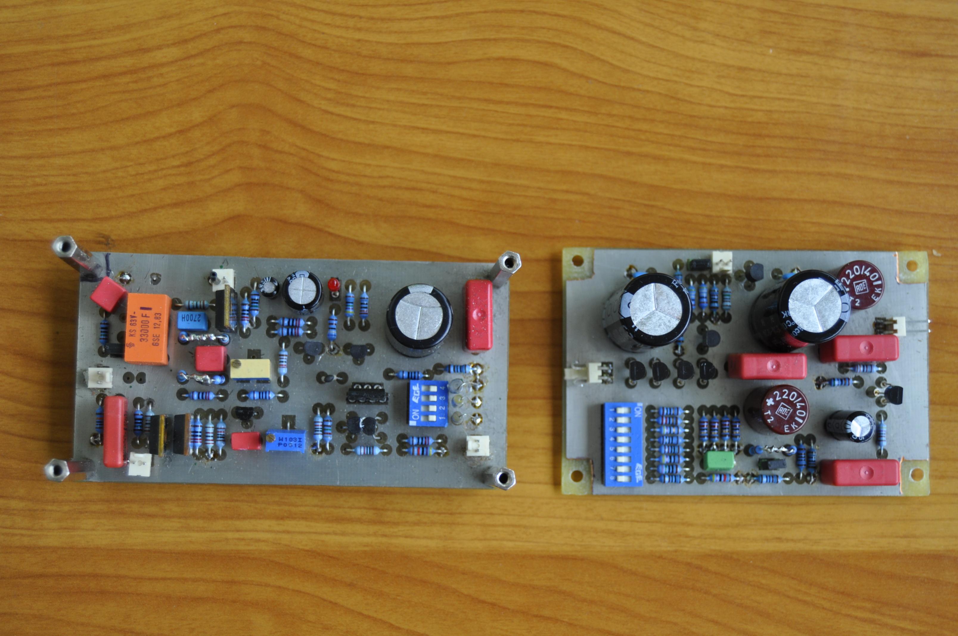

Thank you very much for your reply. At least two of the Pearl Two builders had also built outstanding version of Ono/Xono. I only wished to know sonic differences between them.Well the Ono and Xono were not DIY projects. They were just cloned from service manuals. The Pearls are DIY and simpler to build not really a step backwards. These are less flexible than the commercial offerings in regard to loading balanced, outputs, drive capability etc. The perfomance also depends on the power supply and who is building it. A good build comes pretty close to an Xono but remember it has been discontinued for a few years and we have moved on. You can put together quite a good sounding system off of DIY if you have the time.
Having watched high res. photos of your XP-25 I saw that you went on complementary J-fets path instead of single ended designs. I also prefer fully complementary approach by Erno Borbely.

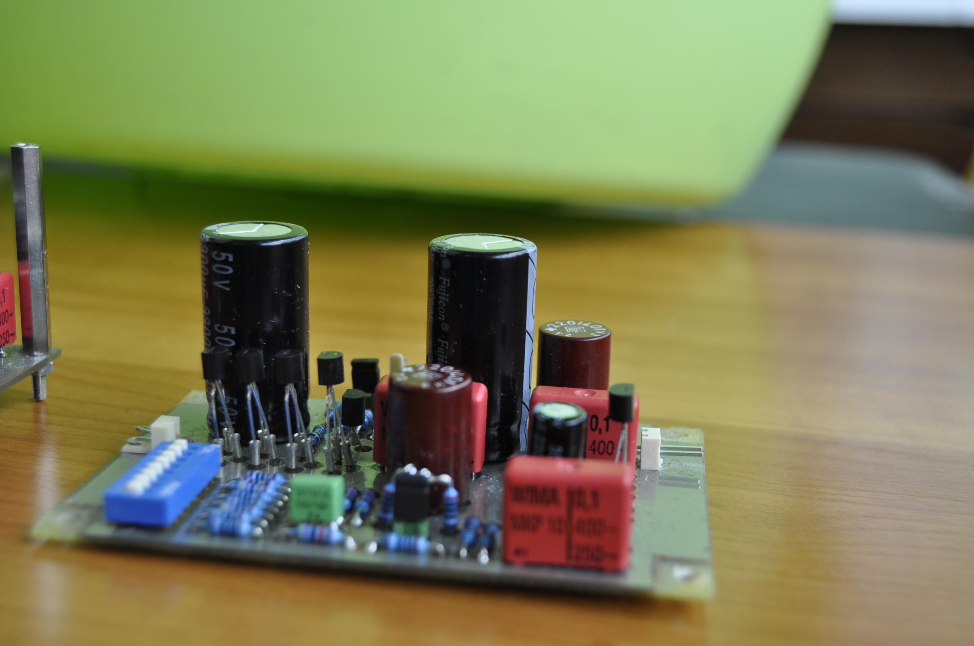

I have just finished assembly and testing of Xono PCB which I etched myself two years ago. It is only modular Xono I have ever seen, and practical to be combined with other modules of your choice. I wish to compare it with my Borbely phono stage , I will even use the same power supply all-Fet regulators.
