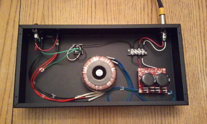

Would either of the below transformers work for this application?
The Plitron is the one I show listed in the parts spreadsheet I have but I would like to know if the Antekic would work work since it is about 60 dollars less. Thanks.

Why do you want 32v secondaries? That will lead to ~44v rectified, which will need to get knocked down to a minimum of 40v (maybe 35v depending on the brand of 7824/7924) at the regulator inputs, and then regulated all the way down to 24v by the regulators. I only used a transformer with 30v secondaries because I had it on hand.
If you are buying the transformer just get this one - http://www.antekinc.com/details.php?p=647
It's shielded and should be quiet. It's also less than 18 bucks. 🙂
Then buy the "PS-KIT" from chipamp.com - Order | Chipamp.com
With the addition of a big diode bridge like this - GBPC3502-E4/51 Vishay Semiconductors Bridge Rectifiers you will be able to build the power supply just like the one shown in the original article.
Another member (budwiser) made one with this setup and it's perfect for this project --
If you look here (post #1387) you will see a great implementation. (yes, you need to click on the links to see the photos)
http://www.diyaudio.com/forums/pass-labs/156397-pearl-two-28.html#post2914064
