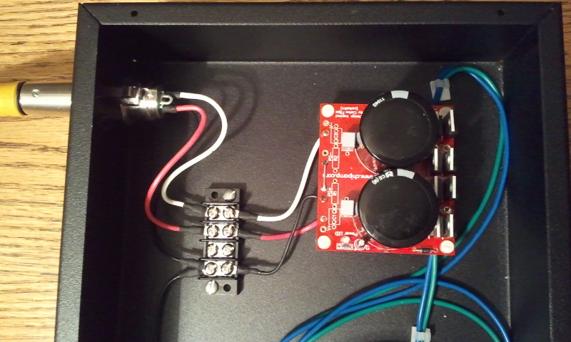

Great choice with the Chipamp.com PSU board, it is practically perfect to make the unregulated supply shown in the article. Don't forget to jumper the GND rail together.
Remember to run the wires against the chassis for best noise performance. I was stunned how much of a difference that made in mine.

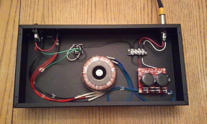

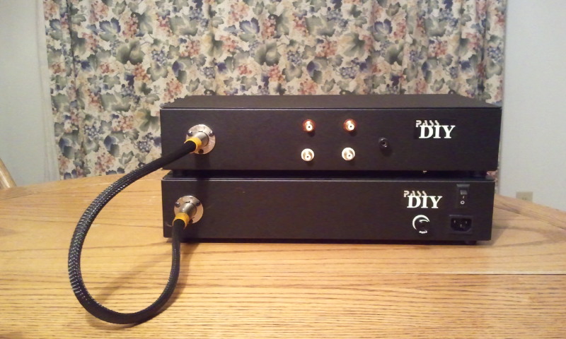

Curious me, what did you use for power connection between the two cases ?
Yes he is very spoiled. I'm using XLR connectors. These particular ones are made by switchcraft. I will post some better pictures.

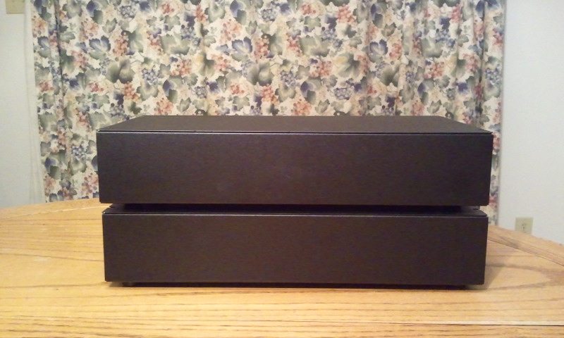

Which chassis is that?
Hammond model #1441-28BK3 with 1431-26BK3 plate. 16"x8"x3".

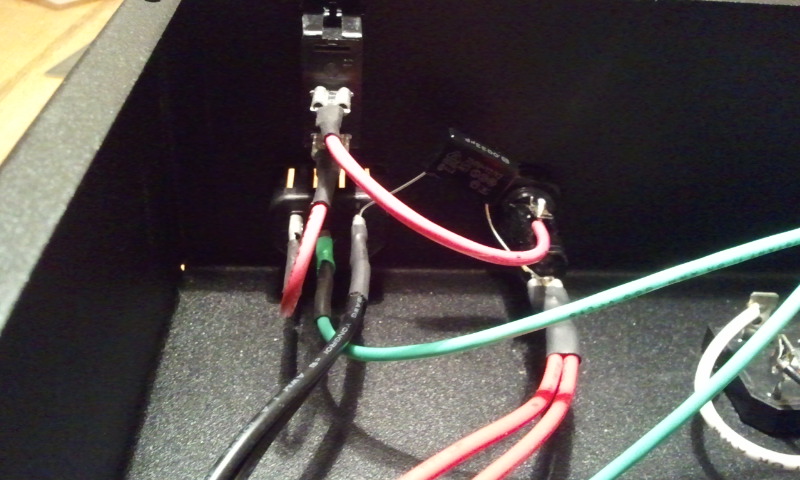

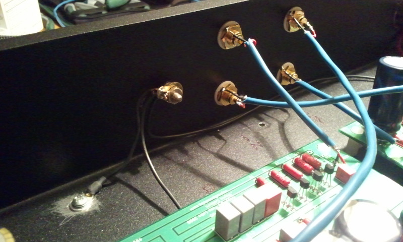

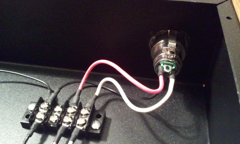

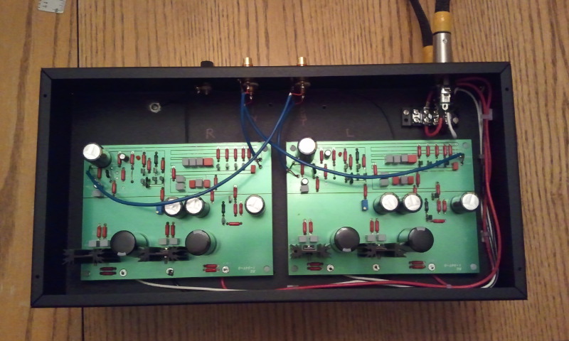

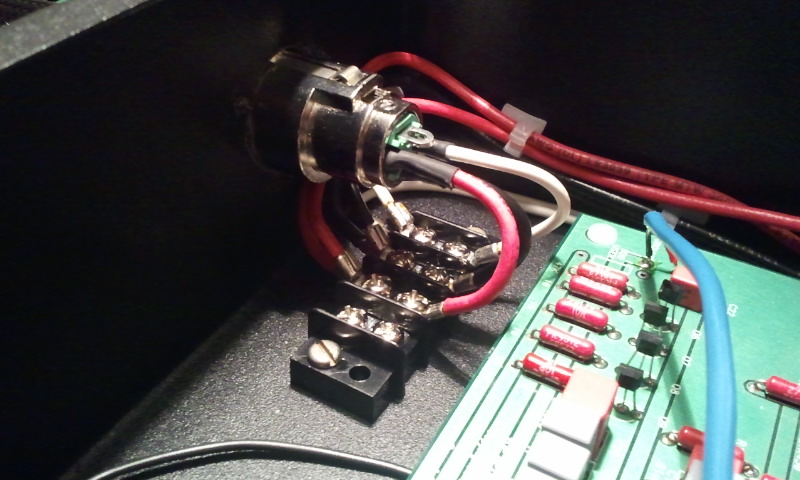

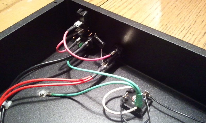

Here are some additional pics. Best I can do, sorry did not take any during construction.

Fantastic photos! You show all the important bits.
Very nicely done! It's a great phono stage, no? I am completely in love with mine.
Is it quiet? Looking at your wiring, it should be.
Lastly, how did you connect the shield in your signal wires? Or are they floating?

Thanks, I agree its a great phono stage. Its so quiet that at first I thought it was not working until I lowered the needle to the vinyl. I may dress up the fronts with something in the lower corners such as Pearl 2 and Pearl 2 PS. The shield in the signal wires are floating. I would like to thank you for sharing your photo journal of your build. Sometimes it helps to see a picture of what is being talked about.

Anyway, it's a .1uf Dayton that I had laying around. I think they are inteded for speaker crossovers. It's a fantastic cap for the money. Use whatever decent film cap you want or have on hand, as the Silmic (a part very consciously specifier by the designer) sitting in position C13 is doing the bulk of the work.
