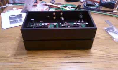

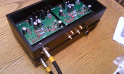

Finally done. I put this off last year and this winter got motivated again
Didn't have any serious issues surface 😱
I used solid silver in teflon tube and shielded it a gutted RG cable for the internal connection of PCB
Power wiring is a 3 wire braid with copper shielding. Gain pcb is isolated, its enclosure is shielded thru power shield and terminates inside PS case
Signal path I used PRP resistors and 1837 caps with Silmac 22uf output
Been running it in for about 5 hours with no heating of any components just 2C more on + reg than - (28C)
have tried 2 low output MCs so far from my collection Accuphase AC2 at .17mv and a Fidelity research mk3 at .14mv
My final system uses a Winlabs Jewel at .4mv output
No hum issues yet
Used a plastic milk carton plastic to shield the mur860 and housekeeping pcb at the AC entrance

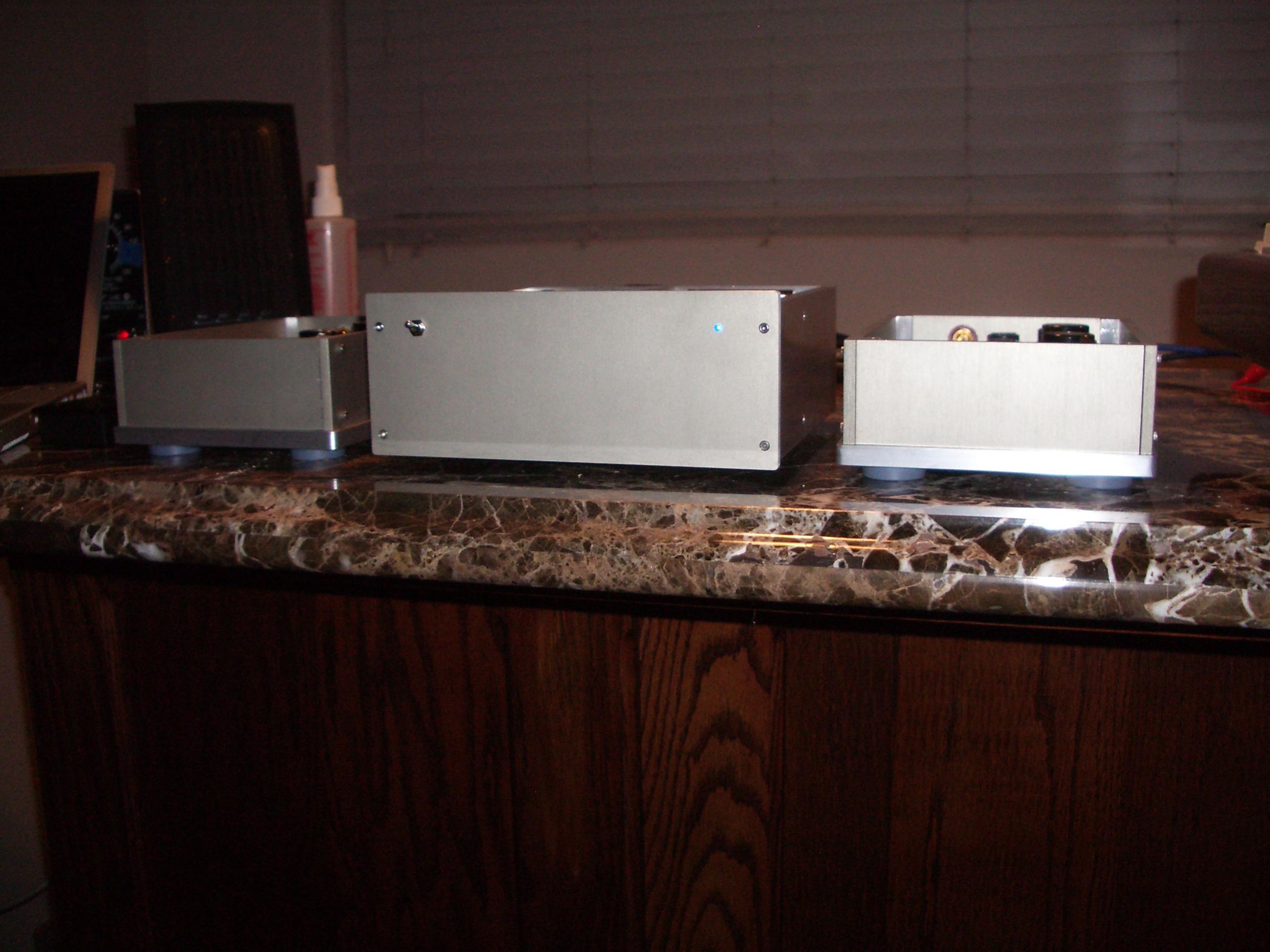

3 chassis? Awesome! I have to know how you grounded it...
Also, are those R-cores? Where did you get them?

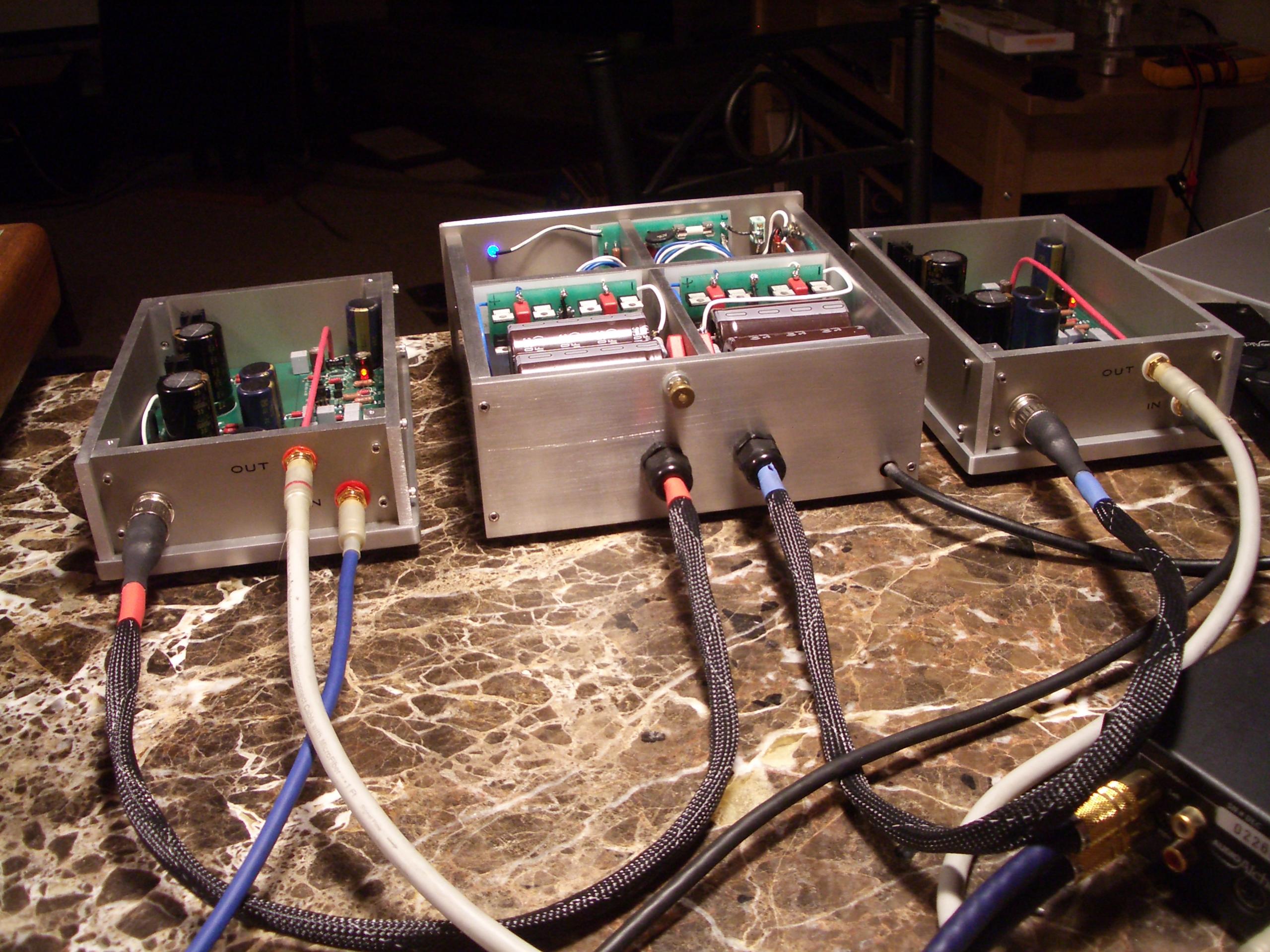

The pcb is floating from its enclosure along with the rca,s
The bnc style connector,s outer barrel connects to pcb,s case
I braided the 3 wire power cable (kimber style) floating +\-/sigGD to pcb
Now I put copper braid shielding over the power cable connecting bnc so pcb case is grd.
It terminates inside the PS floating for now (still a work in progress)
The brass ground connection is isolated from its case. This is the signal star ground that connects the pcb,PS ground points, caps etc and the 35amp rectifier mentioned in waynes article
The AC power cord is foil sheilded, but I have not connected it yet. It enters the case on the bottom right into a copper pipe and terminates At the back top to the small pcb that has the fuse,cl60, 4.7 ohm 2 watters, ac cap (xono) style.
The earth wire connects to the PS case. I have not tried a 10ohm/cl60 combo yet here. I haven,t explored the full potential as I need to terminate the power cable shield and foil ac wire to see if any residual noise can get lower. It,s faily quiet now, but I have to put into my regular system. I,m not done yet

Oh, the rcores
They were labeled 2x24 at 115v and were actually 2x28 that put me at 40.5 vdc unloaded. I was going to rewire them and still might. I have run right at the limit of the regs at 40, but have backed it down with a small variac for now to 34 vdc.
Still a work in progress
Cant remember who I got these from last winter, but it was an ebay seller and his email sig was john 630 or something. Very expensive when you factor shipping to USA.
