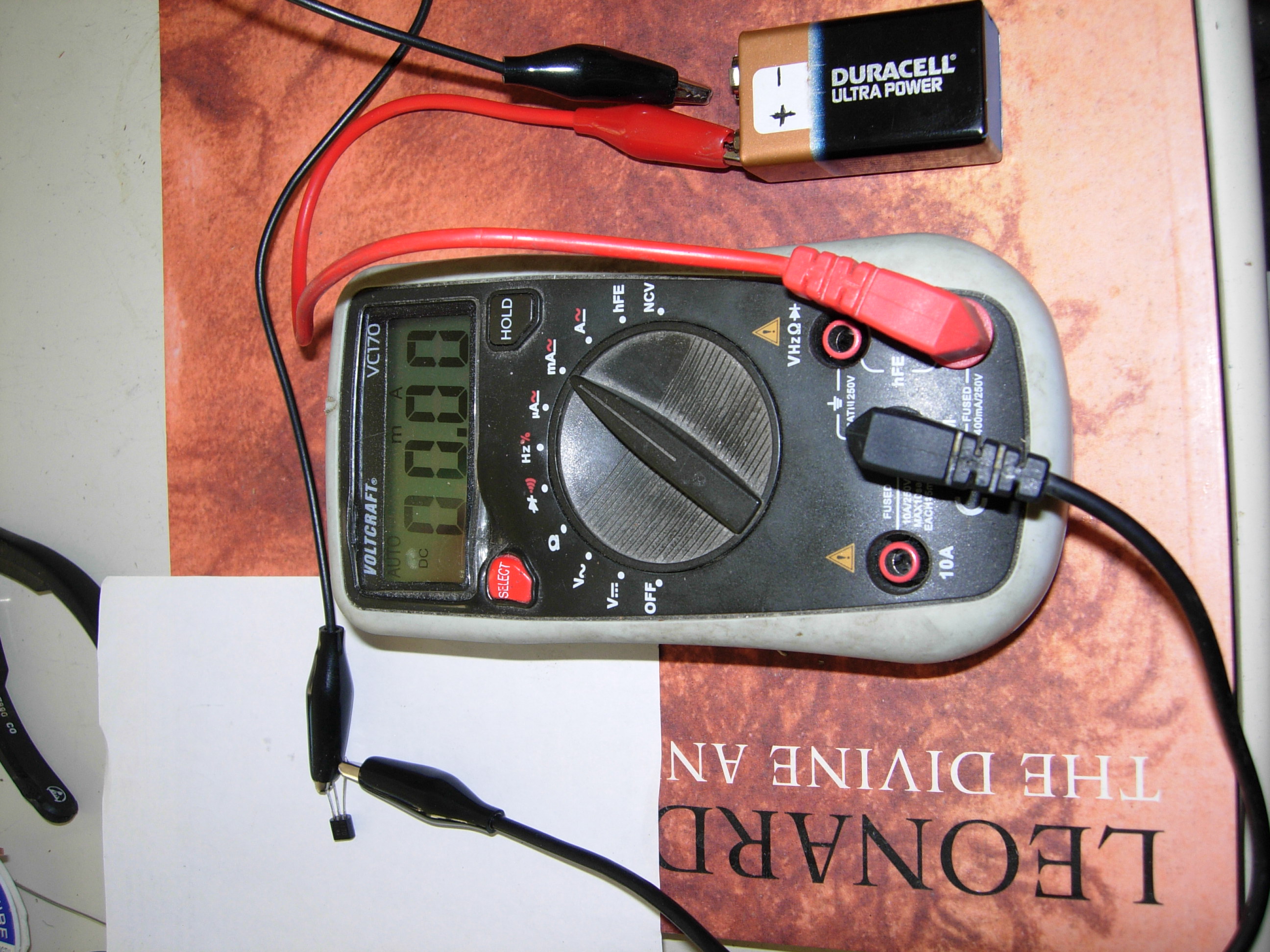

Now I need to measure my fets again .... I'm copying 6's method on post 1047 and getting .001 mA on them .. I'm not doing something right ?

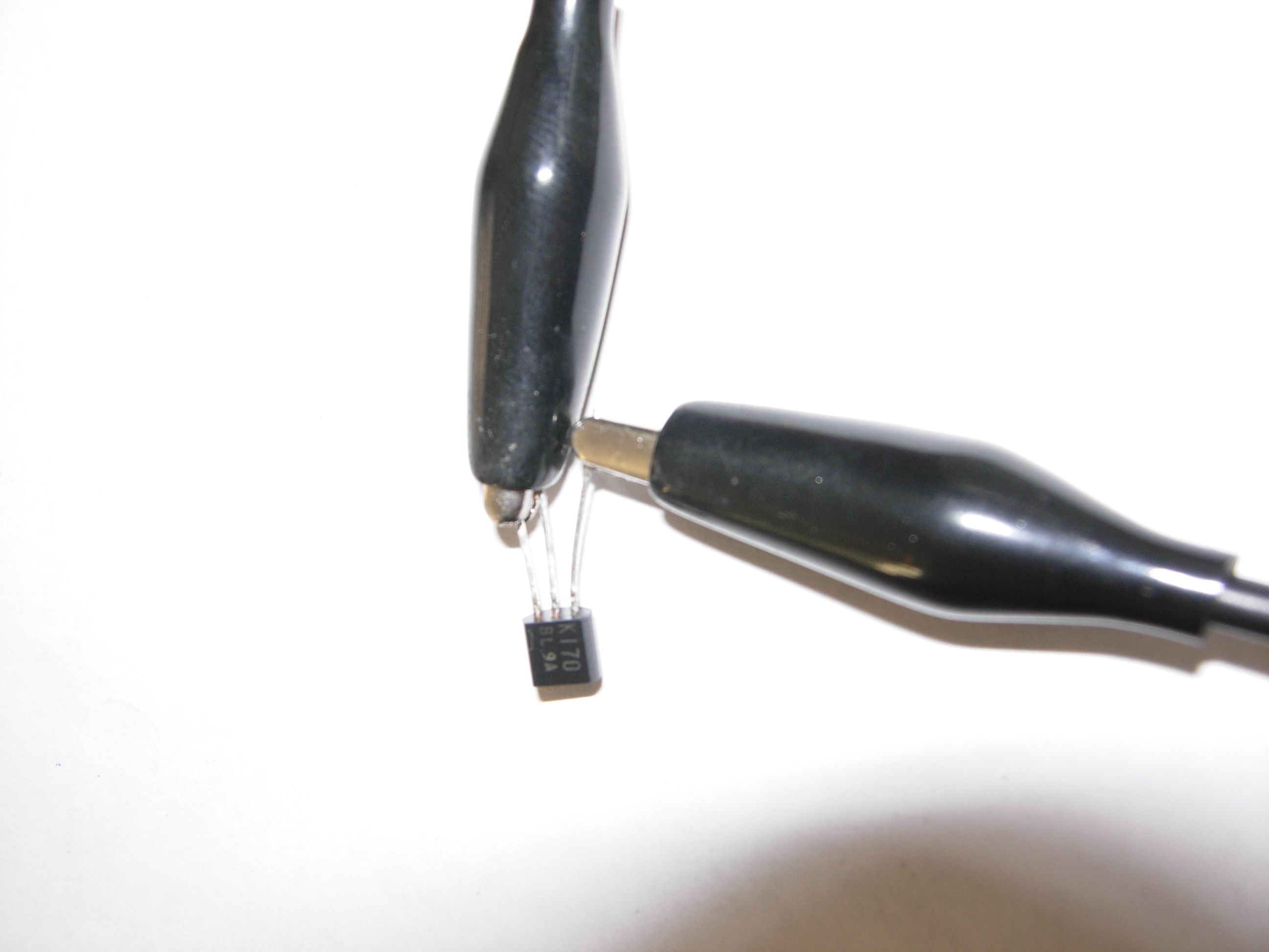

For sorting jfet, which pins are you holding together?

test Fets. with the curve facing away from me , I couple centre and right pin together ... as per post 1047

I see no mistake in your set up. What I would do first: Replace the jfet by a 1 kohm resistor. You should read 10 mA. If you don't, check or replace the fuse in the meter.

I had that happen when I strted Idss matching my fets. No reading. Indeed it turned out the fuse from my meter was blown.

the fuse was gone ....
