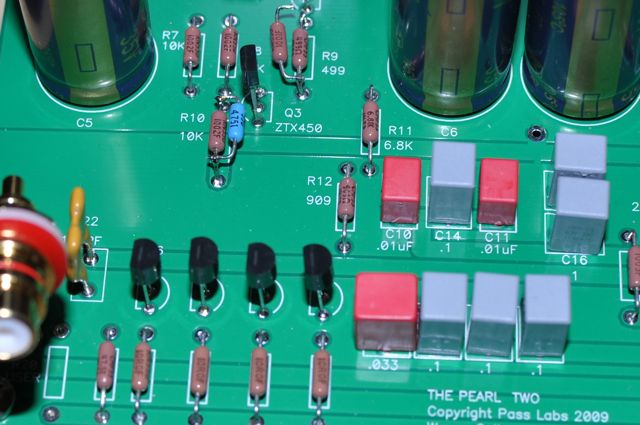

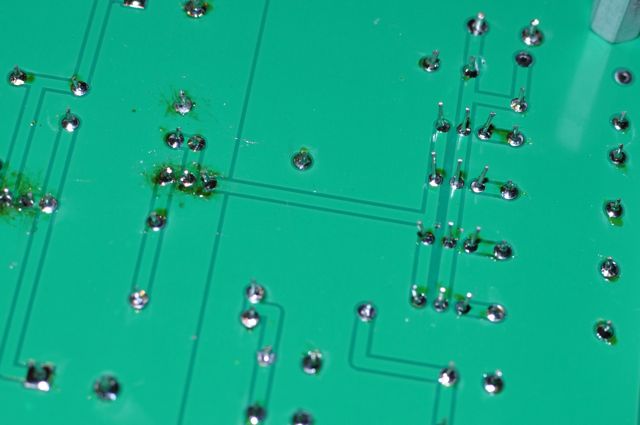

Do you think you could post a close up pictures of this area of the board (component side and solder side) ?
Pierre
Pierre - yes, definitely there is something strange going on here. I'm puzzled 🙂
Let's wait for Rich pictures. At least, his camera works very nicely 😀
Rich - The solder joints that look shinny are good. The others... who knows? If I were you I would familiarize myself with what a good joint is supposed to look like, and some soldering 'best practices'. See for example:
Soldering - It can be done
Heat and Solder the Joints
Next, reflow and as necessary redo the joints on your board. Make sure the iron tip touches both the lead and the pad, and leave it long enough for the solder to become liquid, and really stick to the metals. Don't be afraid to heat things up! Next, verify each joint after the solder cools off. I take pliers and try to push and pull the pin to make sure it does not move. Last but not least, verify that there are no 'bridges'. That is, solder that shorts two traces together, or shorts a trace with a grounding plane.
The problem with your board could be a bridge or a bad joint.
nAr - any more suggestions? Q3 is acting funny but I can't tell if it is because of the transistor or the board... Also, grounding the input has made a drastic difference, when it shouldn't have...

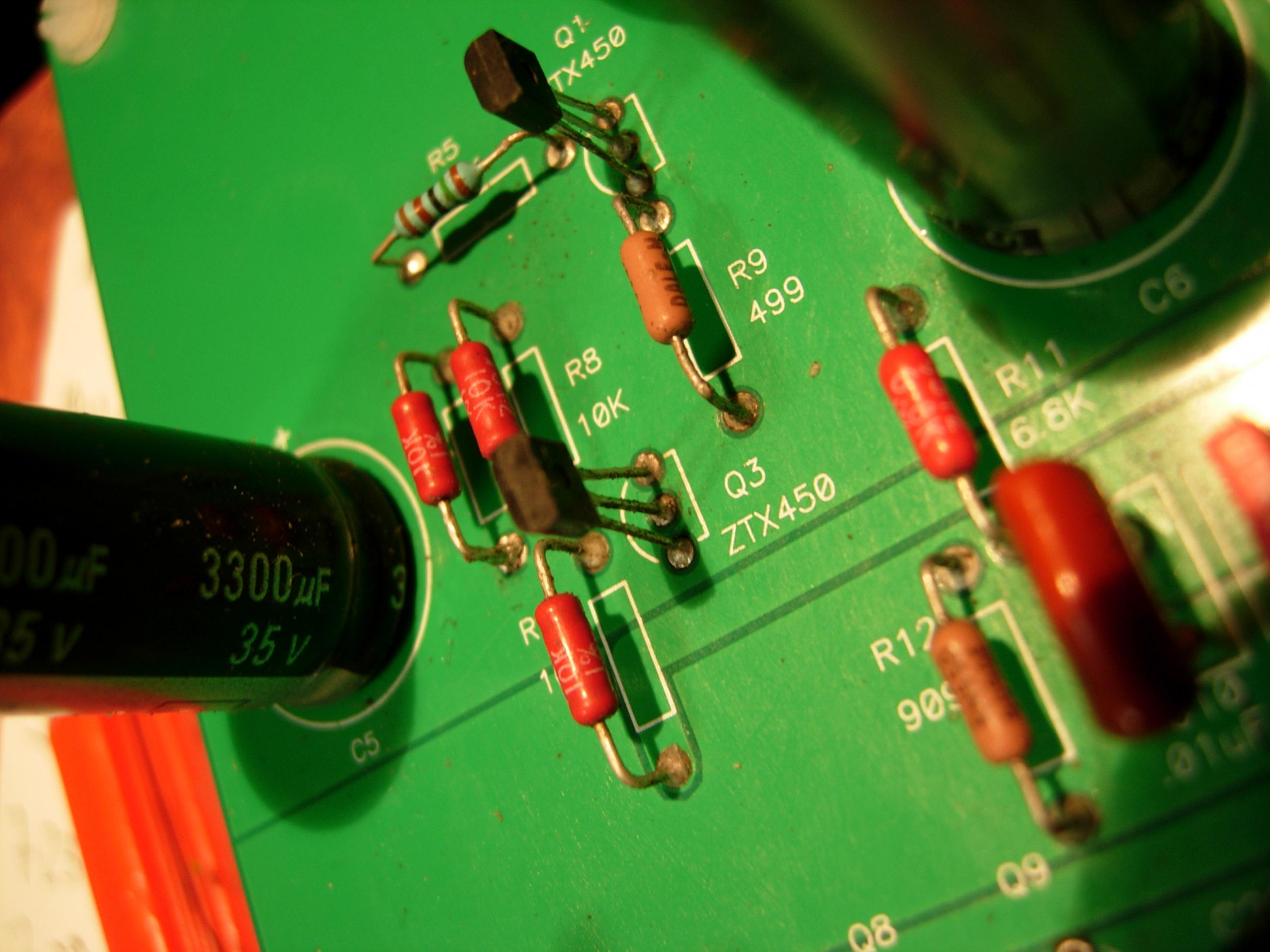

Hmm, R7 joint really looks like it could act funny, and be more and more "resistive" if more current is drawn by jfets ( via Q3, but also via Q1 ) 🙂
I would really re-heat and add flux to all joint that doesn't look like shiny.
Especially that R8 downpin. And in doubt, re heat and add flux, to get "smooth" apparence.
For me now R8 bottom seems to me close to :
http://www.rog8811.com/soldering.htm
Model C
Joints can also become crackled when bending an already soldered component; I said it can, when joint is not done properly 🙂
Best,
nAr
Best,
nAr

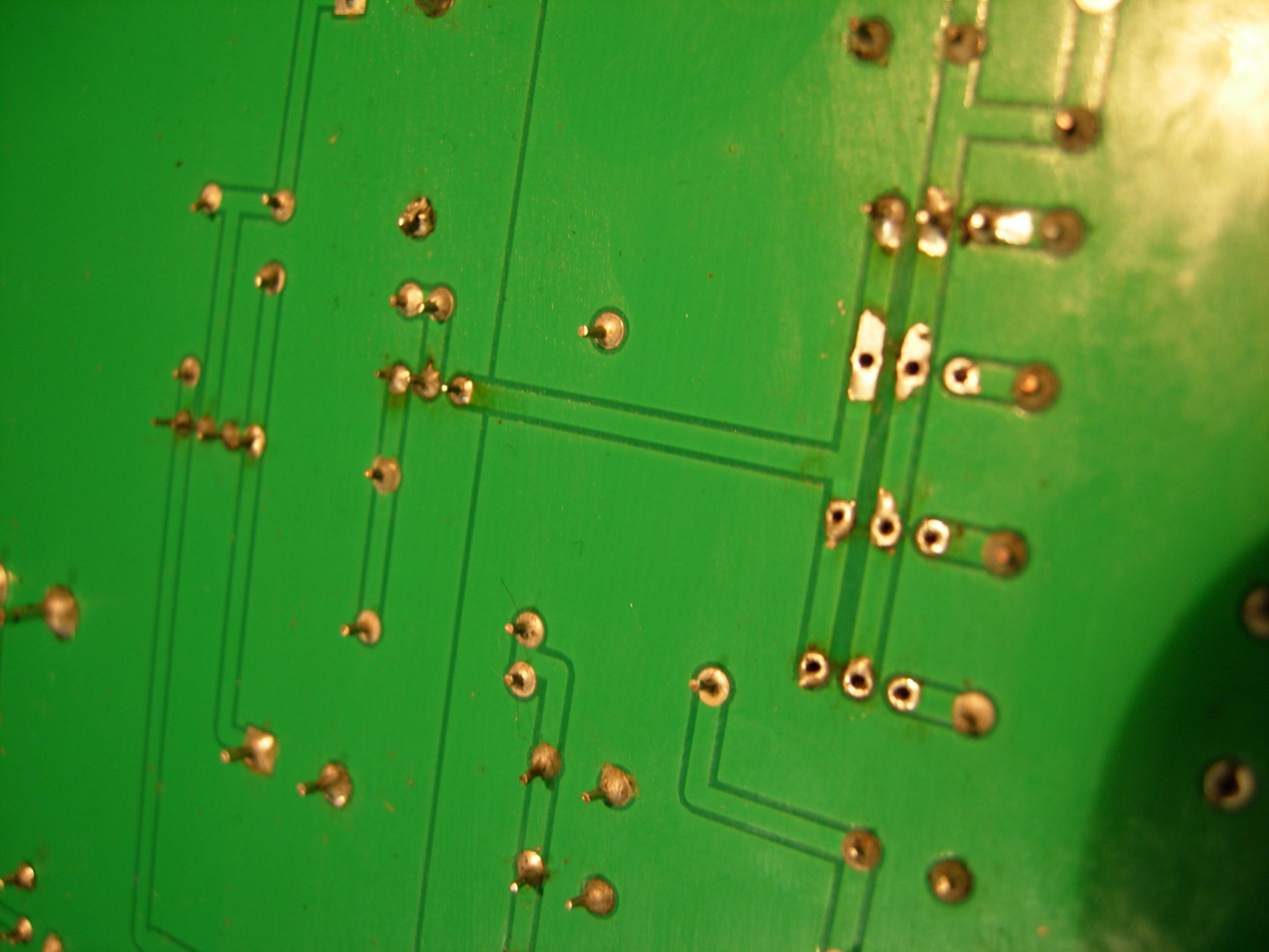

Photos of my board. Note that it has not been cleaned - brown stuff is burnt flux. The resistor in parallel with R9 will be removed completely. The one in parallel with R10 stays.
The M (base) voltage is correct, the B (emitter) voltage should be 0.6 to 0.7V lower than the base (M), the base emitter is reverses biased, the emitter is being pulled up towards the collector, look for a short on the PCB.
But the pad of the emitter and its trace are surrounded by ground... Instead could it be that emitter and collector have shorted inside the bjt? Or perhaps the whole ground plane is lifted up by a short elsewhere 😱.
By the way - thanks for joining, Itsmee.
I get it fluid and shiny then its sets it loses its shine .... I'm using the Mundorf
M-solder and a Ersa digi 2000a @ 385 C .... I try to work on the no-more than 5 second rule ... I have trashed a lot of boards by lifting traces ...
I have now re-soldered every joint on the board
I tried a continuity test by leaving the ground connected and touch + side of components with the + probe ... nothing !
If you have a spare ZTX450, cut the legs off Q3 so as not to disturb anything, if the voltage then measures 0V on the emitter (B), the transistor was duff and the board is OK, if you still get a voltage reading, look very carefully at the trace between Q3 emitter and the JFET's drain.
