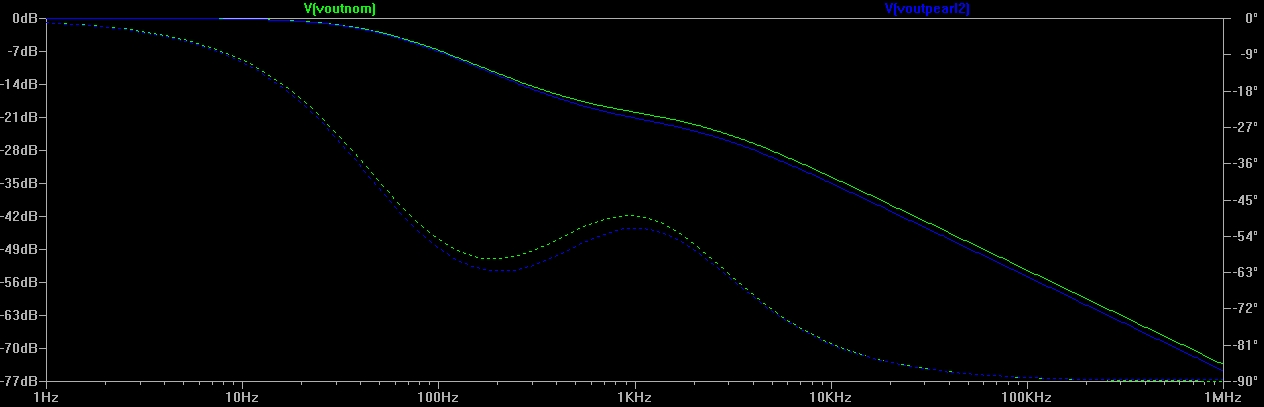

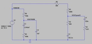

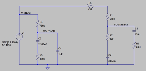

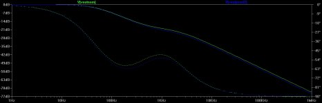

Hi, I have a question: When simulating the RIAA network, I found the response to be about 1dB below the normal curve, for higher frequencies - see simulation circuit and resulting plot attached. As I couldn't find any other frequency-dependent stuff in the circuit (at least not in the interesting frequency range), I was wondering what my oversight is. Remember you put a diagram of RIAA response in the article, that showed very good compliance....
just wondering.... in the simulation I reduced R1 (corresponding to R11 in the Pearl II schematic) to 5600 ohm, and the fit was very good. I also introduced the 22ohm resistor to implement the 3.18us time constant. Listening test is tonight, let's see what happens...
