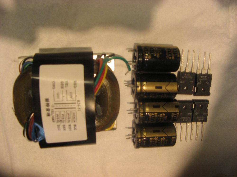

Received the parts for my new Pearl 2 power supply, nice EI core transformer (you recommended this type instead of toroidal), ELNA Audio caps and Vishay Schottky rectifiers (that I had from an other project). I'll be able to compare with the Pearl 1 power supply (Plitron toroidal and Panasonic caps).
