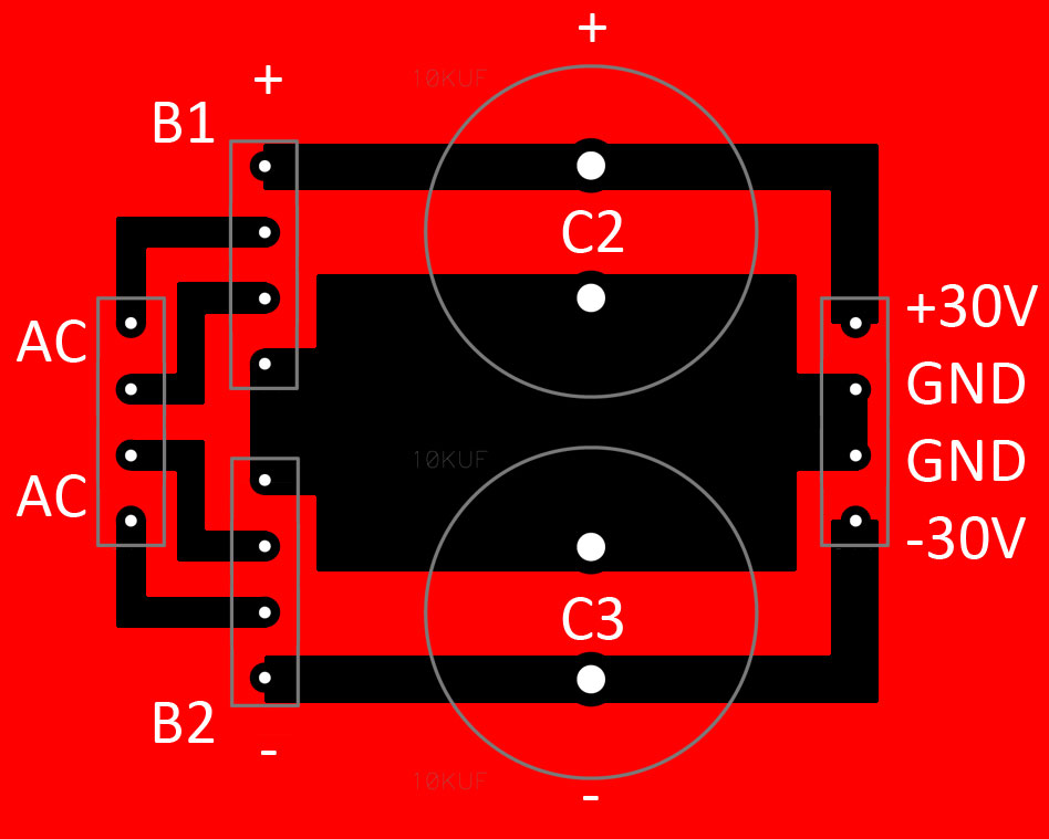

Suggested PSU layout
Here's a simple layout that can be P2P wired or converted to a board via traditional DIY methods 😎
Dimensions are 3'16" x 2'53" @300dpi
Diode bridges are in standard GBU806 package. I used Digikey part GBU806DI-ND. AC / AC pads are meant for tranny secondaries connection (22 or 24V). C2 & C3 parts are 10.000uF/40V Mundorf M-Lytics caps (25x40mm). There is extra space between caps and diode bridges, in case you would like to mount some heatsinks on the rectifiers. One issue could be the in / out connectors holes sizes + GBU holes size for drilling & soldering though. I might change this in the near future 😀

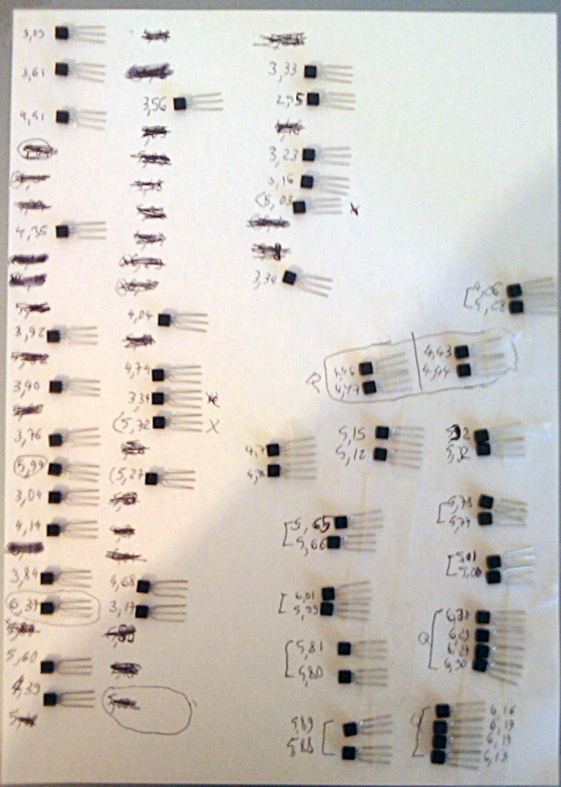

I just don't want to clutter the thread too much, but I'm currently matching the jfets from my batch
I hope I can get 2 quads out of here, for now 3 parts at 6,19 / 6,19 / 6.13 mA IDSS
nAr
nAr
So, first batch is matched, out of 60 bought jfets from same wafer, 2SK170 from Toshiba, I got:
- 2 quads >5mA:
@ 6,30-6,29-6,27-6,30 mA
@ 6,16-6,19-6,19-6,13 mA
- 8 pairs also >5mA:
@ 6,01-5,99 mA
@ 5,89-5,88 mA
@ 5,81-5,80 mA
@ 5,78-5,77 mA
@ 5,65-5,66 mA
@ 5,32-5,32 mA
@ 5,15-5,12 mA
@ 5,01-5,00 mA
Is that precision sufficient ? I used a 9V battery with GS tied together and measured the IDSS that way in the 20 mA meter range.
9V battery voltage was the same before and after the matching process, so I guess no fault here.
From the rest I can do some more matched pairs, but they will be below 5 mA IDSS.
May I ask a question ? Do the second stage diff. pair Jfets need to be matched with as high IDSS ? Or is the range from 4 mA to 5 mA still interesting ? I thought the 5 to 6 mA IDSS range was good especially for the input quads ... 😕
Thanks for your input !!! 🙂
nAr

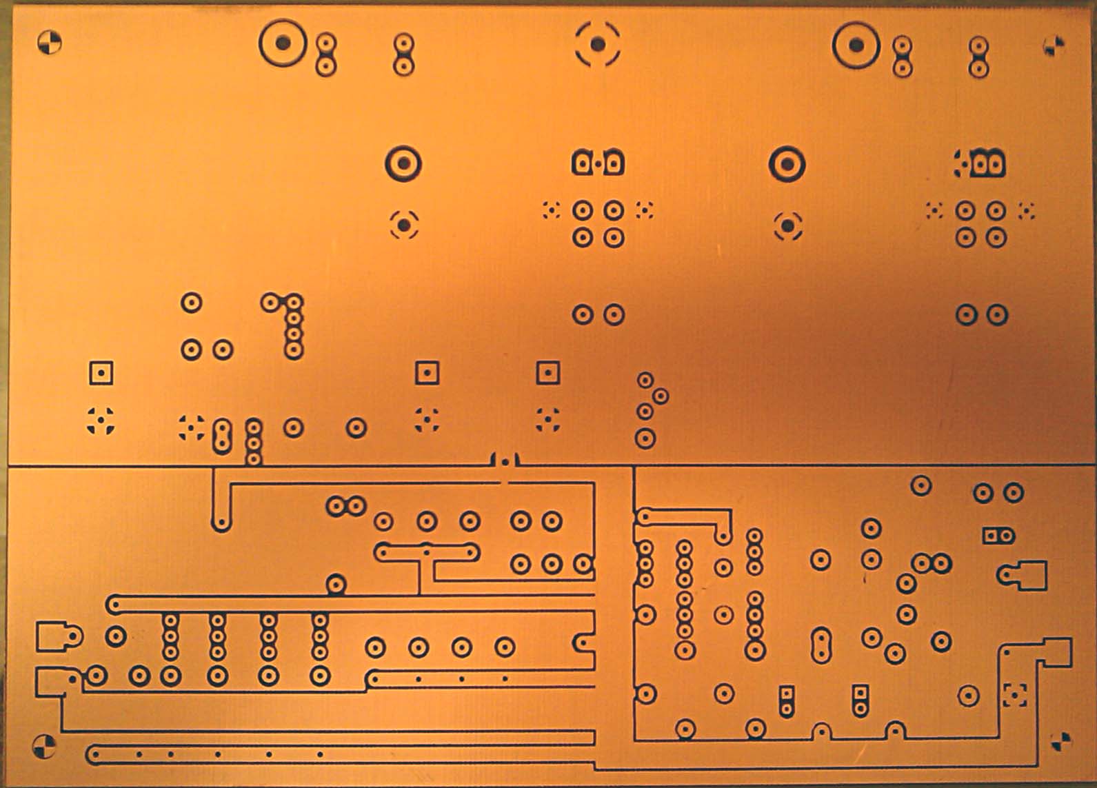

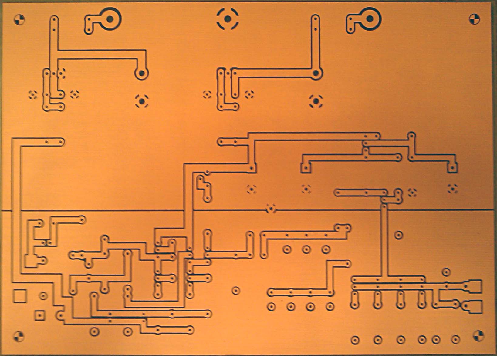

Small update: the boards are now done.
As you can see, this is my attempt to make some real PassDiy Pearl II clone boards 🙂
Once again, many thanks to eclectic2k for the big help ! greatly appreciated 😉
Except for the I/O pads, where I added some square areas in order to solder the silver ribbons (remember my version will use no wire to carry audio signals).
I happily used PS for this, though it was a hard time especially for tracks width and ground planes. I then printed my .pdfs to inkjet transparent on my Canon IP3000, and that two times for a good "black" at UVs.
Once varnish is perfectly dry, the drill process will begin. There are about 179 holes x 2 (stereo) to drill. The varnish used was sprayed in very small quantity, so soldering will be easy whilst keeping the tracks away from copper oxidation 😎
Sorry for the blurry & shady pictures. My phone has no flash, but it's a good phone !
nAr
